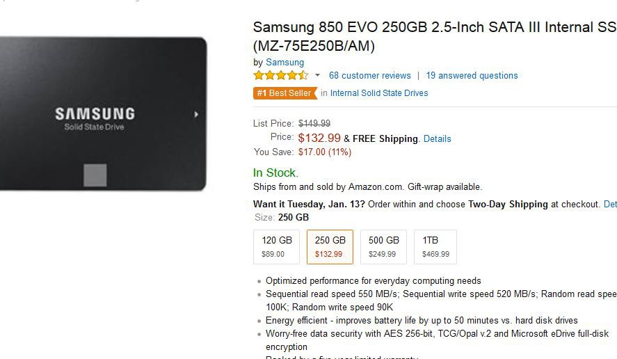

ok well again if it works on other computers.. that says it all..
and as for your 100€
so then $120 ok.. so is upping it to this going to hurt your bank?? and this is the most recent- latest out there..
yeah, from amazon its just 133$... but in my country its 130€ :/ ok, first I will return it for money or take to warranty and then look what to do.
