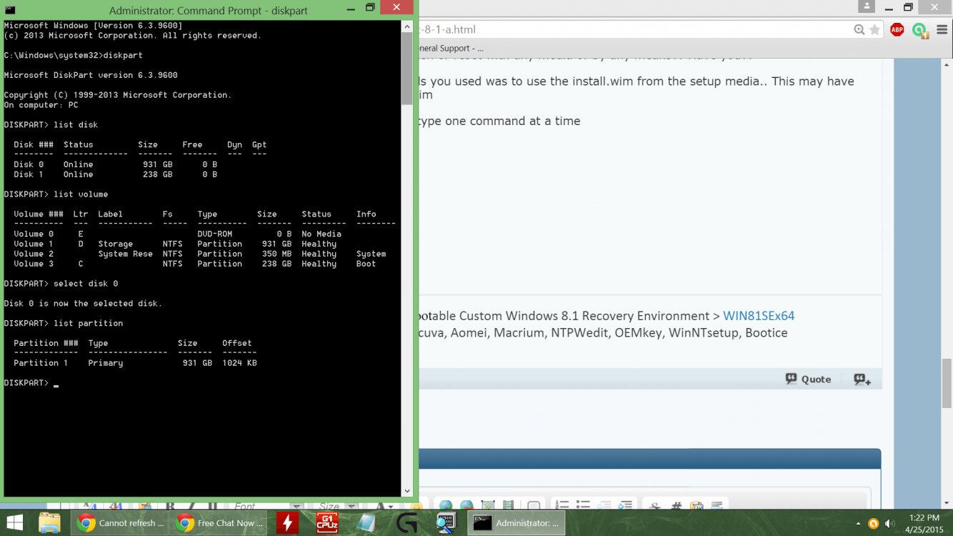

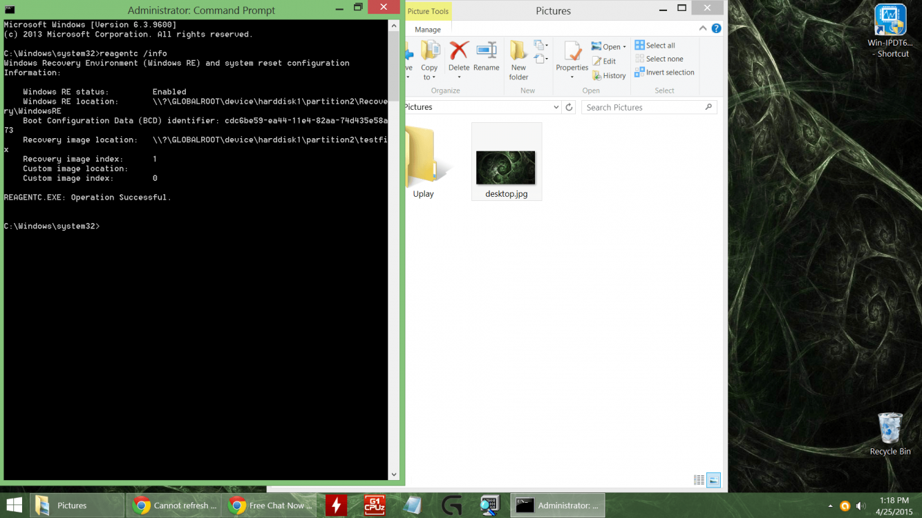

From command prompt(admin) type one command at a time
reagentc /info
diskpart
list disk
list volume
select disk 0
list partition
post a pic of cmd window
Thanks for your replies =)
KYHI, I was previously able to (forced to actually) successfully perform the reset option after booting to my disc. After resetting, I am unable to reset or refresh after booting to any media, unless i boot into windows and restart in advanced start up (ie recovery environment). After booting into advanced startup, reset and refresh options work normally.
Screenshots:
As you can see, disk 0 is my hdd, do i need to repost diskpart screenshot from my ssd?

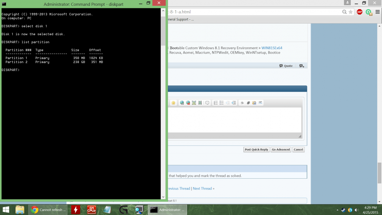

yes, please post
diskpart
select disk 2
list partition
But, you do not have a recovery images partition.. Just a 350MB recovery Tools partition - so yes you can only refresh and reset with the setup media inserted into a drive

you do not have a recovery IMAGE partition.. thus nothing for refresh/reset recovery to refer to..
this program will allow you to make custom recovery images
PS edit - preforming a clean install does not create a recovery image partition - the recovery image partition is created by the OEM
