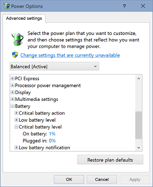

Sorry for that - I should read more carefully. As I said I can change to 1% - actually I can change it to zero but it changes it straight back to 1 if I do that.
Looking here https://social.technet.microsoft.co...a9a/how-to-change-critical-battery-level-to-1 it can be seen that the registry is updated in this path

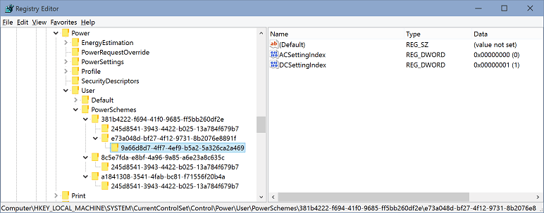

HKLM\SYSTEM\CurrentControlSet\Control\Power\User\PowerSchemes
After a bit of trial and error (changing the settings and see what changes in regedit) I can see for balanced power plan it is values in this sub-key path:
\381b4222-f694-41f0-9685-ff5bb260df2e\e73a048d-bf27-4f12-9731-8b2076e8891f\9a66d8d7-4ff7-4ef9-b5a2-5a326ca2a469. Your key may be different as I'm on Windows 10 - just change the percentage to values you are allowed in power options and see what is updated.
After taking ownership of the registry key 9a66d8d7-4ff7-4ef9-b5a2-5a326ca2a469 as described here http://www.eightforums.com/tutorial...le-folder-drive-registry-key-windows-8-a.html I can set it to zero and it sticks.
The percentage values are held in ACSettingIndex (for plugged in) and DCSettingIndex (for battery).
Most likely the ACSettingIndex is not relevant as a critical battery level when you are plugged in makes no sense; but you can set it if you want (as you can in power options for some unknown reason).
