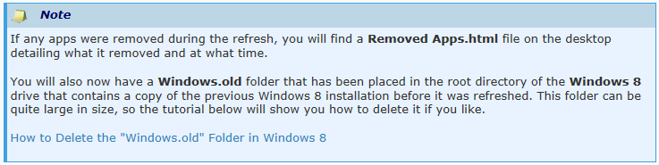

Try a refresh.
How do a Refresh:
http://www.eightforums.com/tutorials/2293-refresh-windows-8-a.html
