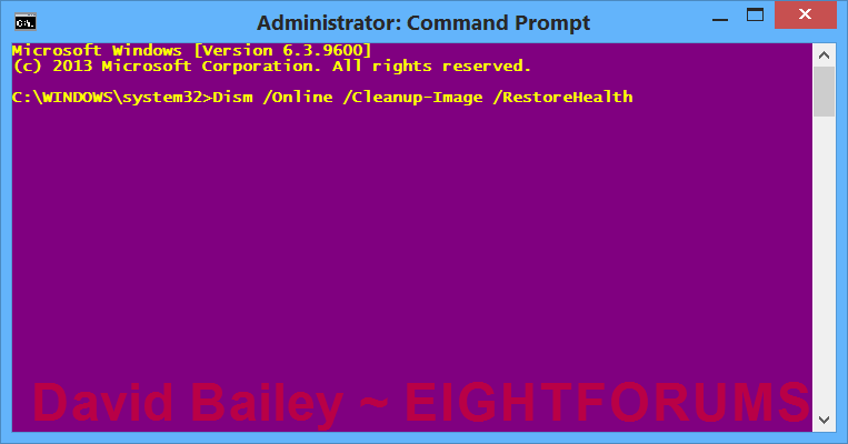

You need to run:
in an administrator command prompt & reboot & run SFC again.
The corruptions will be fixed.

Thanks, I do have ALL the correct drivers. I have check that. Running check disk now an it is stuck on 11% for like 30 minutes! Just my have to do a complete reinstall...really trying to avoid all the time it takes...that's why I started with refresh.
    W8
Running DISM, as suggested, should repair the bad files situation. Not sure how it might have gotten the corrupted files, possibly a memory or drive situation.
But running a Refresh in 8.1 does need the 8.1 source files. If you had the install media you could run it that way, but the only other way is to create a CustomRefresh image from a healthy system. This would of course add that much data to your OS partition. This is assuming you do not have access to some type of install media you could download.....

How long should DISM run...I am running this now...an it has been stuck at 20% for some time. Seems not to be moving.
From about 15 min. to an hour.
The more the corruption, the longer it takes.
