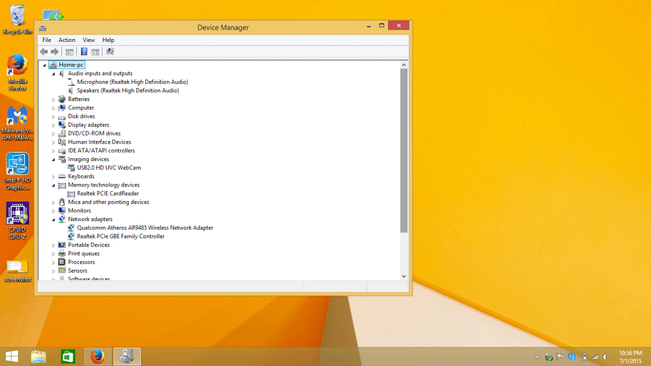

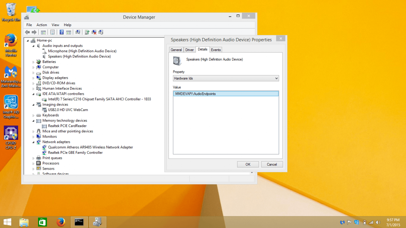

thanks for the reply. Yea i tried that website and a couple other ones and all of them are a black screen. The light comes on as if it active just nothing showing. Is this is the info you was looking for? screenshot.png
I just saw some other Realtek drivers available for your model, that looks like it may be using the Microsoft driver, is that what it says on the driver tab?
