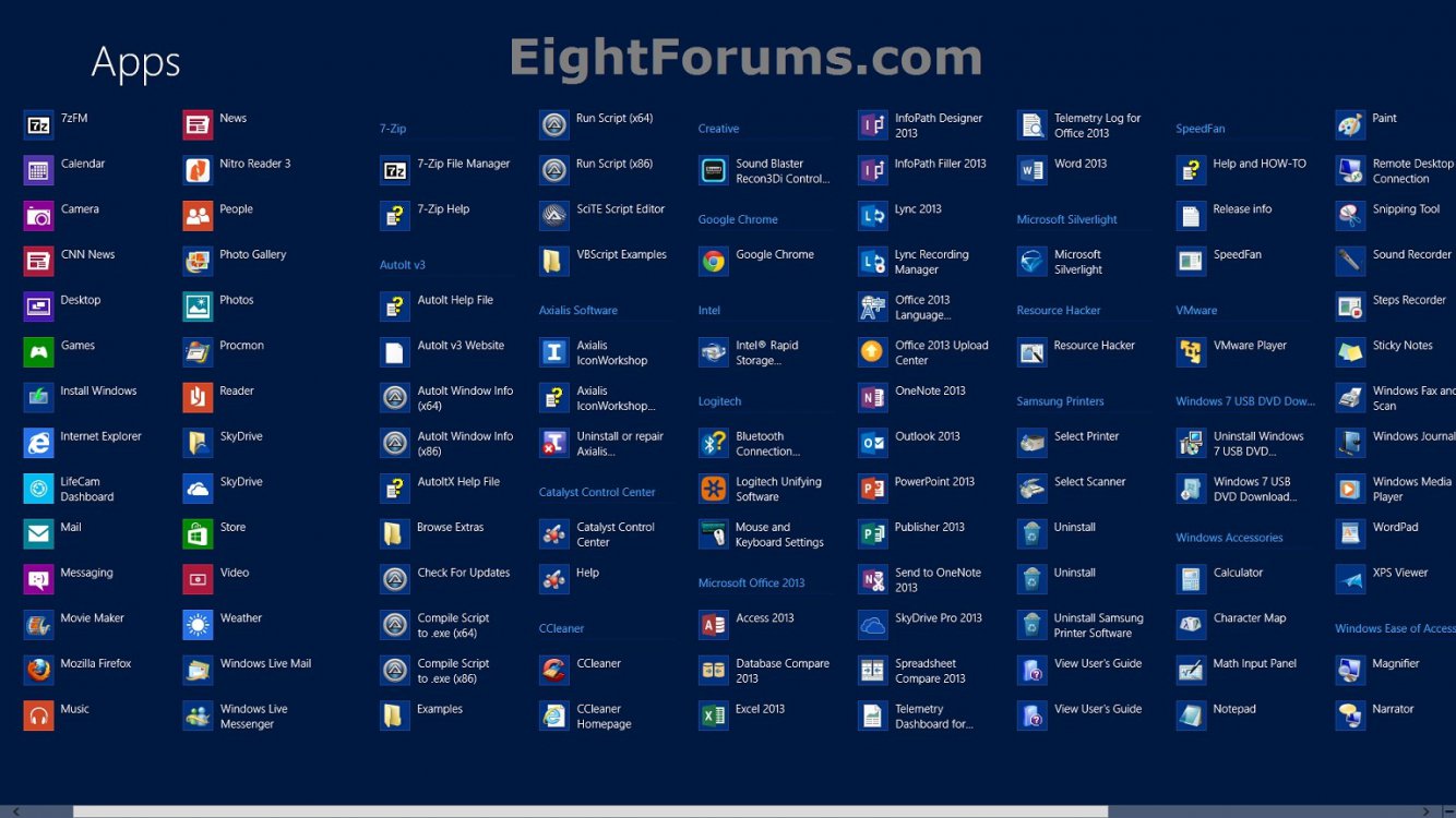

EXAMPLE: Apps screen in Windows 8
NOTE: The name above a group of shortcuts is the folder name in the Programs folder location used below.

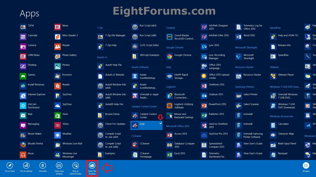

2. On the Apps screen, right click or press and hold on a shortcut (ex: Help) under a folder/group (ex: Catalyst Control Center) that you want to remove to check it, then click/tap on Open file location. (see screenshot below)​
If this is for a game shortcut, then you may not have an Open file location option. If so, then will need to use the tutorial below to remove the game shortcut from Games Explorer instead to remove it from the Apps screen. It's the same process in Windows 8.

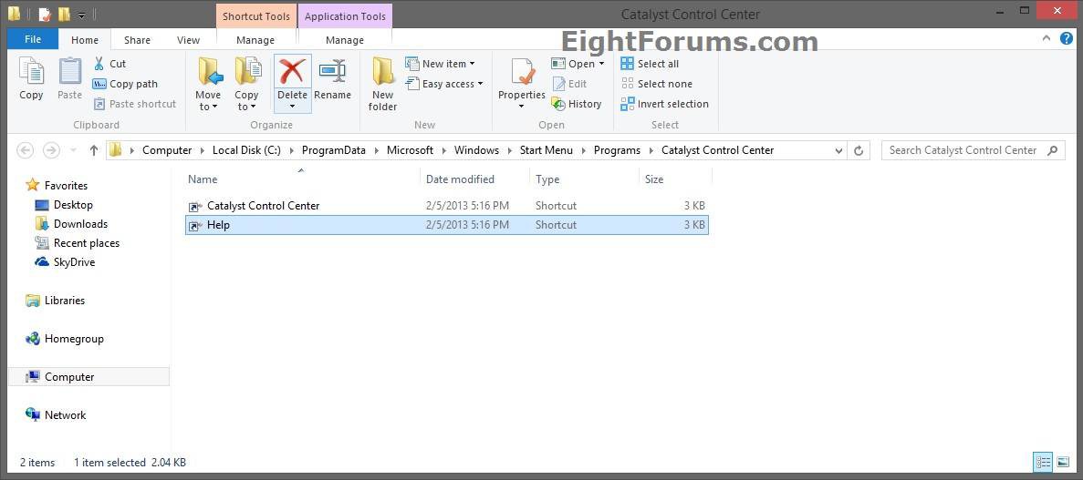

3. You can now delete the shortcut (ex: Help) file at this folder location. (see screenshot below)​
4. If this is in the "all users" location, then standard users will have to first enter an administrator's password to be able to approve deleting the shortcut.​

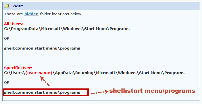

These are hidden folder locations below.
All Users:
C:\ProgramData\Microsoft\Windows\Start Menu\Programs
OR​
shell:common start menu\programs
Specific User:
C:\Users\(user-name)\AppData\Roaming\Microsoft\Windows\Start Menu\Programs
OR​
(current user)​
shell:start menu\programs

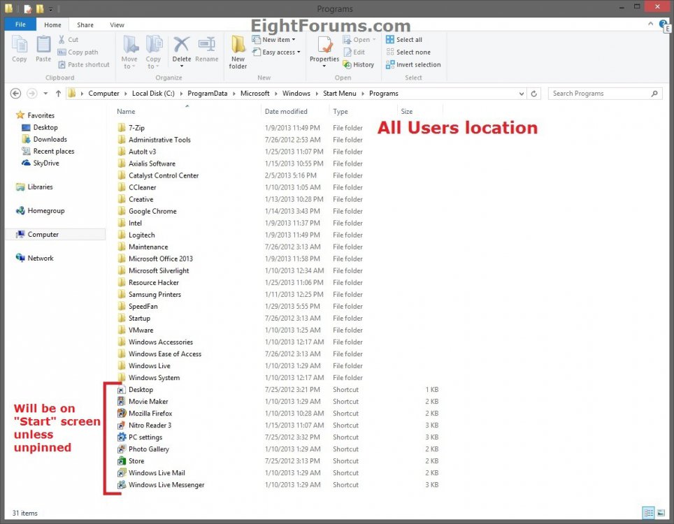

To Remove Items in "Apps" Screen from File Explorer
1. Open File Explorer, and go to the folder location below that the shortcut is in that you want to remove.​
NOTE: You must be signed in as an administrator to be able to remove anything from the All Users location below.​
All Users:
OR​

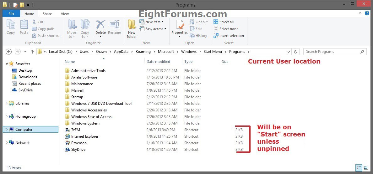

Specific User:
OR​
(current user)​

3. To Remove a Shortcut from a Group on the Apps Screen in Windows 8
A) Delete any shortcut in the Programs folder or other folders in the Programs folder, and go to step 5 below.​
Deleting shortcuts in the root of the Programs folder will also remove them from the Start screen. If these shortcuts are not on the Start screen, then it means that they have already been unpinned from Start.
This does not apply to shortcuts in folders in the Programs folder.​

Hello Mr. Shawn;
If it's possible, please correct this Note part of this topic::)
Thank you.
    Kaspersky
Oops. Thank you. :)
