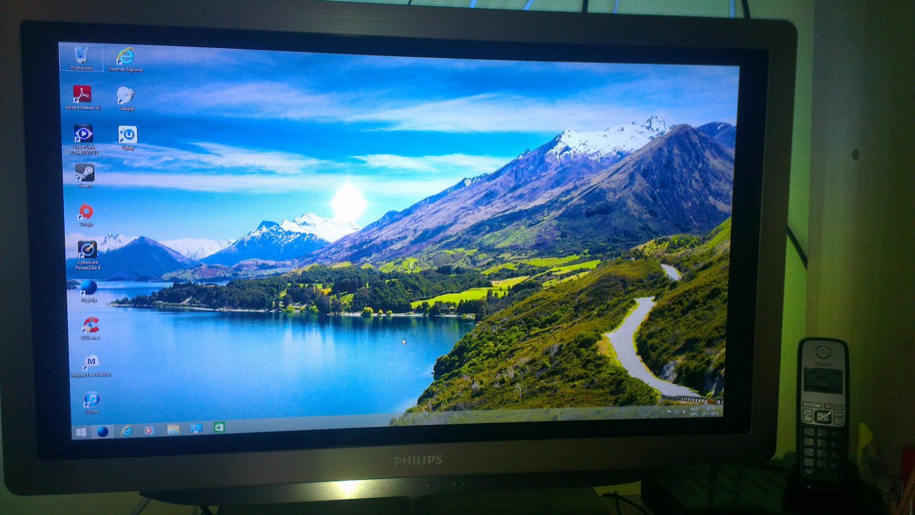

I plugged in my new videocard and installed the drivers, but I have a problem. AMD Catalyst Control Center will not open. It's really difficult because I can not do anything to set. I can not set the picture and make wider, so get on all four sides of the black screen (see picture) I must necessarily be in AMD Catalyst Control Center. I've removed the drivers and reinstalled, but I can unfortunately not get in AMD Catalyst Control Center (settings). Please help!

Great, I made it finally. You really need to try removing everything of amd. I've looked at amd files through task management. Press properties and must refer to something windows: system 32, there is somewhere a few files from ati (amd) you need to remove all. Then reboot your PC and install all the drivers again. Then it must work. Thank you all for your help.

Thanks, it's working now. I downloaded display driver uninstaller and I will keep that save for another time.
