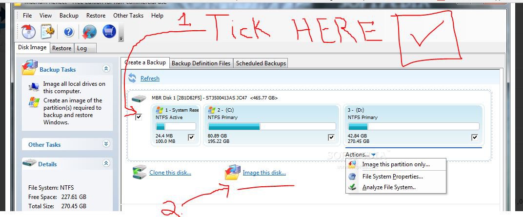

ok, my choice of words in describing the process of Macrium may not be that great..
I think you already know how images work.. So Ignore all of this if you already know.
If you download the Macrium reflect free program, and install it right now and run it -
This is what would happen:
1. you would let it make a "recovery cd/usb"
2. You would then put that "recovery CD/USB away (as in on a shelf in your room and don't lose it - Don't put it near magnets etc..)
3. you would then make a full entire backup Image using Macrium by selecting your entire drive like so in picture below. (This requires a second USB stick or probably more like External Harddrive plugged in by USB or a bunch of DVD/CD's if you have a burner.. (depending on how large your original Hard drive is with Windows installed on it, is what determines what you would save on here ... either USB or External Hardrive USB etc..) -
I currently have my images saved on 32Gig USB sticks and an External 1Terabyte Hard Drive.) I ran a Macrium backup Image right after I installed windows for the first time So I will always have it - And that is the one on the 32gig USB stick)..
4. Anyway, after that Image finishes from step 3. - which it should also Verify it, - You now have an exact copy of your entire hard drive on a USB/External Harddrive/ or CD/DVDs - (whichever you chose to save the image on in Macrium.)
How long this process takes depends on how fast your USB speed is, and How large Hard drive you have to copy..
Very Important, there are also some settings in Macrium Options to change to make it go faster.. I can tell you those if you want.. (options like Compression off and etc.. but turning Compression off means it will be larger size and you'll need an external USB Hard drive instead of a USB stick.. got it?)
ANYWAY,
If all goes well, you now have an exact copy image of your computer as it is right this second!..
Ok, hope that is the clearest possible to explain Macrium and the image if you created one right now..

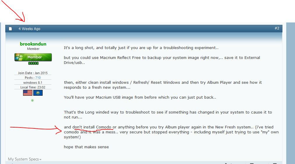

Look, the reason you would make this "image" I'm constantly talking about is for Troubleshooting purposes. so you do not have to ever reinstall windows again..
I remember you specifically saying you had to reinstall windows 3 times in the past summer etc.. You wouldn't have had to do that if you had this image that last summer!
I'm really just telling you this because you can do your own "troubleshooting" after you make this little image using Macrium..

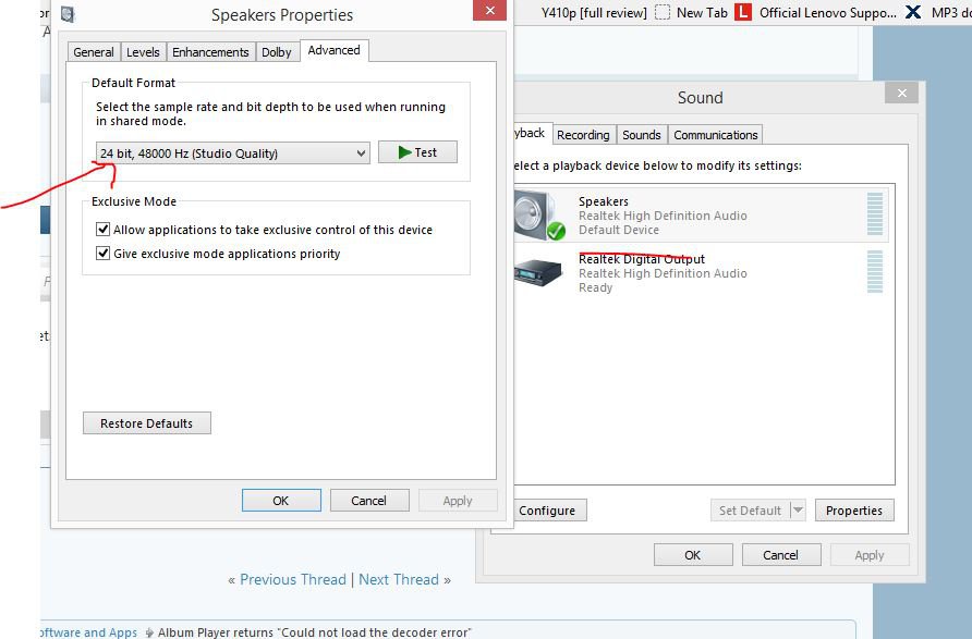

for example:
After you have the Macrium image, lets say you want to try a new driver for your audio card.. or lets say you want to open up audio preferences and start changing stuff like below..
And after changing things, if something goes terribly wrong or you don't like the outcome and start having problems and errors.. you would just use that Recovery CD/USB and put that image back onto your hard drive and all the sudden those changes up above pictured, are right back to like when you never even touched them!
