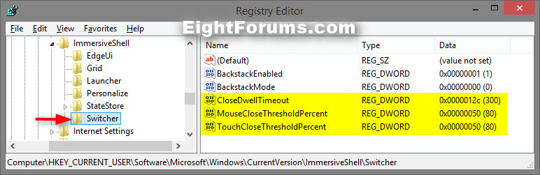

1. Press the :winkey: + R keys to open the Run dialog, type regedit, and click/tap on OK.​
3. In Registry Editor, navigate to the location below. (see screenshot below)​
HKEY_CURRENT_USER\Software\Microsoft\Windows\CurrentVersion\ImmersiveShell\Switcher

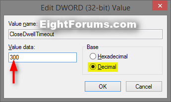

4. In the right pane of Switcher, double click on the CloseDwellTimeout DWORD to modify it. (see screenshot below step 3)​
The CloseDwellTimeout DWORD controls the speed of the app's tile flipping animation at the bottom before closing the app.
If you do not have the CloseDwellTimeout DWORD, then right click on an empty area in the right pane, click on New and DWORD (32-bit value), type CloseDwellTimeout, and press Enter.
A) Select (dot) Decimal, type in a value between 10 to 2000 for how many milliseconds (1000 milliseconds - 1 second) you want to wait until the tile flips over, and click/tap on OK. (see screenshot below)​
NOTE: A nice fast speed is 300. The default speed is 2000.​

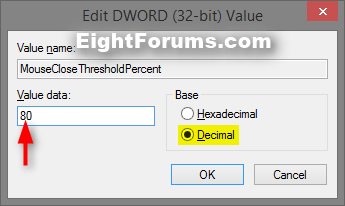

5. In the right pane of Switcher, double click on the MouseCloseThresholdPercent DWORD to modify it. (see screenshot below step 3)​
The MouseCloseThresholdPercent DWORD controls the distance you have to drag the modern app with a mouse from the top edge of the screen downwards before it goes to the bottom of the screen to do what you have CloseDwellTimeout set for.
If you do not have the MouseCloseThresholdPercent DWORD, then right click on an empty area in the right pane, click on New and DWORD (32-bit value), type MouseCloseThresholdPercent, and press Enter.
A) Select (dot) Decimal, type in a value between 5 to 99 for how short or long you want to drag, and click/tap on OK. (see screenshot below)​
NOTE: A nice fast speed is 80. A higher value gives you a shorter drag, and a lower value gives you a longer drag.

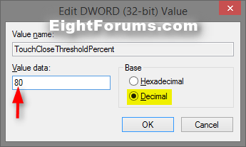

6. In the right pane of Switcher, double click on the TouchCloseThresholdPercent DWORD to modify it. (see screenshot below step 3)​
The TouchCloseThresholdPercent DWORD controls the distance you have to drag the modern app with your finger from the top edge of the touch screen downwards before it goes to the bottom of the screen to do what you have CloseDwellTimeout set for.
If you do not have the TouchCloseThresholdPercent DWORD, then right click on an empty area in the right pane, click on New and DWORD (32-bit value), type TouchCloseThresholdPercent, and press Enter.
7. When finished, close Registry Editor.​
8. Either restart explorer or sign out/in of Windows to apply.​
