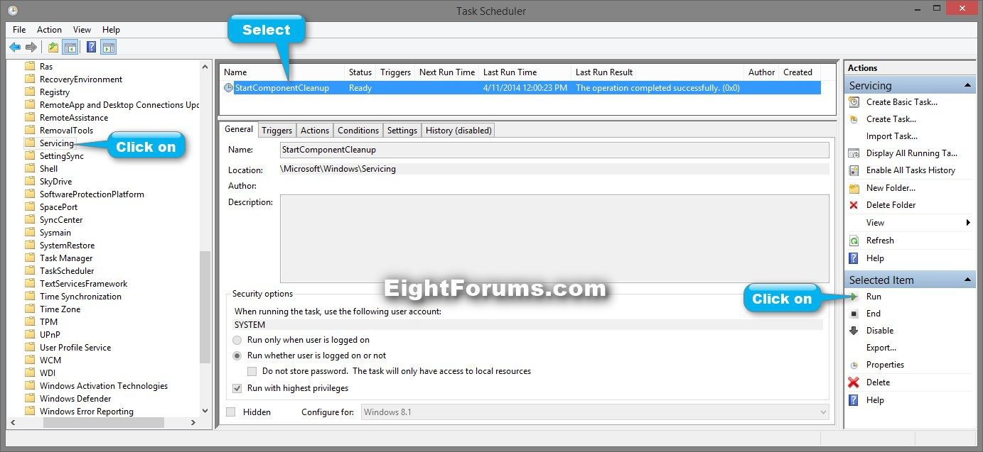

The StartComponentCleanup task was created in Windows 8 to regularly clean up components automatically when the system is not in use. This task is set to run automatically when triggered by the operating system. When run automatically, the task will wait at least 30 days after an updated component has been installed before uninstalling the previous versions of the component.
If you choose to run this task, the task will have a 1 hour timeout and may not completely clean up all files.
1. Press the :winkey: + R keys to open the Run Dialog, type Taskschd.msc, and press Enter.​
3. In the left pane of Task Scheduler, expand the console tree, and navigate to and open Servicing at location below. (see screenshot below)​
Task Scheduler Library\Microsoft\Windows\Servicing
4. In the middle pane of Servicing, select the StartComponentCleanup task, and click/tap on Run under Selected Item in the right pane. (see screenshot above)​
5. You'll now notice that the StartComponentCleanup task is now running. This will take a while to finish running. (see screenshot below).​
6. If you like, you can close Task Scheduler since it's not required to remain open. It's recommended to let the computer stay running or sit idle until the task has finished running.​

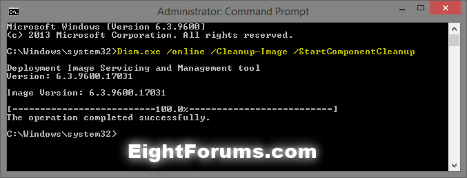

To Clean Up WinSxS Folder using /StartComponentCleanup with Dism
Using the /StartComponentCleanup parameter of Dism.exe on a running version of Windows 8.1 gives you similar results to running the StartComponentCleanup task in OPTION ONE above, except previous versions of updated components will be immediately deleted (without a 30 day grace period) and you will not have a 1-hour timeout limitation.
2. In the elevated command prompt, copy and paste the command below, and press Enter. (see screenshot below)​
Dism.exe /online /Cleanup-Image /StartComponentCleanup
3. When successfully finished, you can close the elevated command prompt if you like. This could take a while to finish depending on how much there was to clean up.​

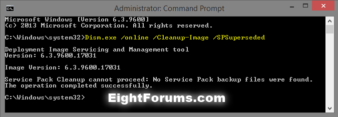

To reduce the amount of space used by a Service Pack, use the /SPSuperseded parameter of Dism.exe on a running version of Windows 8.1 to remove any backup components needed for uninstallation of the service pack. A service pack is a collection of cumulative updates for a particular release of Windows.
:warn: The service pack cannot be uninstalled after this command is completed.
Dism.exe /online /Cleanup-Image /SPSuperseded
(If no service pack backup files found)​

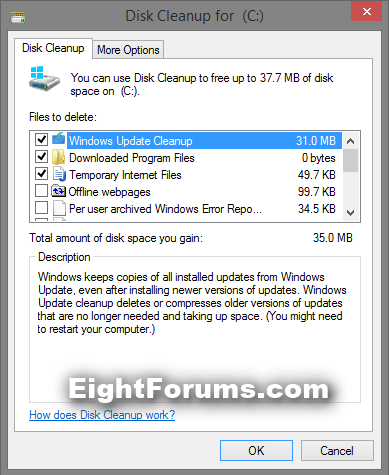

To Clean Up WinSxS Folder using Windows Update Cleanup in Disk Cleanup
This option is to use the Windows Update Cleanup option in Disk Cleanup to delete outdated Windows updates from the WinSxS folder (component store) to free up hard drive space.

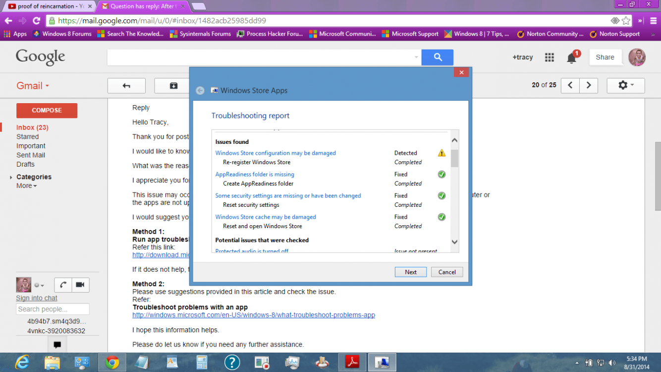

No way, I want Windows 8 to work properly first, 8.1 is just another can of worms. I have had a appcrash with msfeedssync.exe, after I had a forced refresh a week ago, Ran sfc/scannow NO integrity violations. Then ran DISM.exe scanhealth (win 8) No problem with component store. Then I ran app diagnostics and it said it's fixed (Image)Screenshot (5).png still appcrash not fixed.

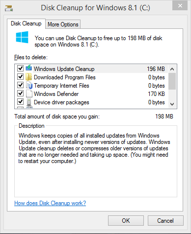

Hi,
I am experiencing problem with using Disk Cleanup. I tried to clean up the "Windows Update Cleanup" - 196MB but couldn't!
I press OK, the Disk Cleanup would process the "Windows Update Cleanup" part really fast (by looking at the progress bar) as if it skipped the entire part. Then when I ran Disk Cleanup again, the "Windows Update Cleanup" would show 196MB again!
This is driving me crazy! I tried:
1. Dism.exe /online /Cleanup-Image /StartComponentCleanup
2. Dism.exe /online /Cleanup-Image /StartComponentCleanup /ResetBase
I am looking for a solution here pls.
Thanks!
Hello Nathan, and welcome to Eight Forums.
If you haven't already, restart the computer, and try Option Three again to see if it may help. :)
Odd. Did you run the command in an elevated command prompt?
Usually it only deletes anything that's 30-days and older, but that command should have overridden that.
Hi
I am a bit confused as to what the difference between Option 3 & Option 4 is
Which deletes more items and makes regains more space Option 3 or Option 4
Is Option 3 better that Option 4 or vice versa, If so why
Could any of you geniuses who don't work for Apple answer pls.
Hi
Hello Caprone, and welcome to Eight Forums. :)
Option 3 would clean more. It includes out of date updates and service packs.
Option 4 is only for cleaning out of date service packs.
Hi
Thank you Brink for clarifying that. It helps a lot for cleanups.;)
