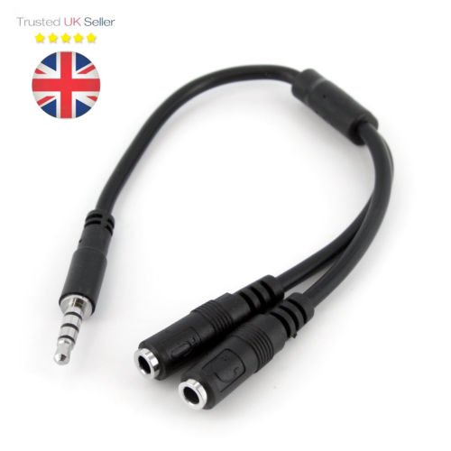

3) Building an Y cable to be joined with an off-the-shelf Y cable
Y cable to build: 3.5 mm TRS male (PC side) to 2x 3.5 mm TRS female receptacles
Y cable to purchase: 2x 3.5mm TRS male jack (mic and audio) to 3.5 mm TRRS female (to single-jack headphone)
Your Y cable pinout:
TRS(male) = mic-audio-gnd
TRS1(female) = mic-mic-gnd
TRS2(female) = audio-audio-gnd
4) trying if it's true that an "XBOX/PS4 chat adapter" works: although it has a TRRS male, probably the XBOX chat adapter has just a TRS (3 pin) receptacle, being designed for single-audio headsets.
Sennheiser PCV-05
Ebay "PC Gaming Cuffie Piombo Per Xbox One/ps4 Talkback Chat "
Can anybody confirm anything?
