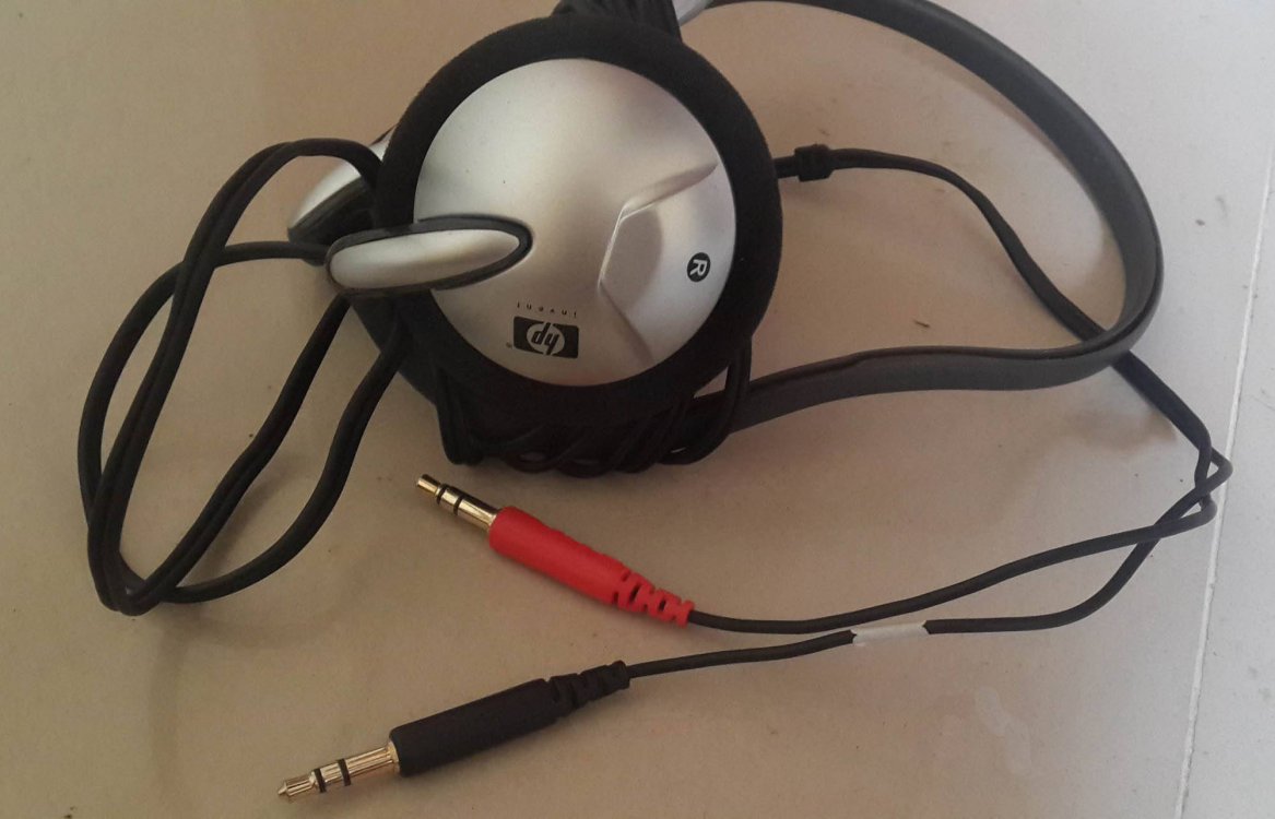

2. When I plug in external headphone (Headphone's got 2 jacks, black which is for sound and red which is for recording) into the Only ONE audio input there is, Windows gives a popup with its current Audio devices plugged in but it just wont read the MIC. This is what pops up when I plug in the external MIC or headphone. 1.jpg

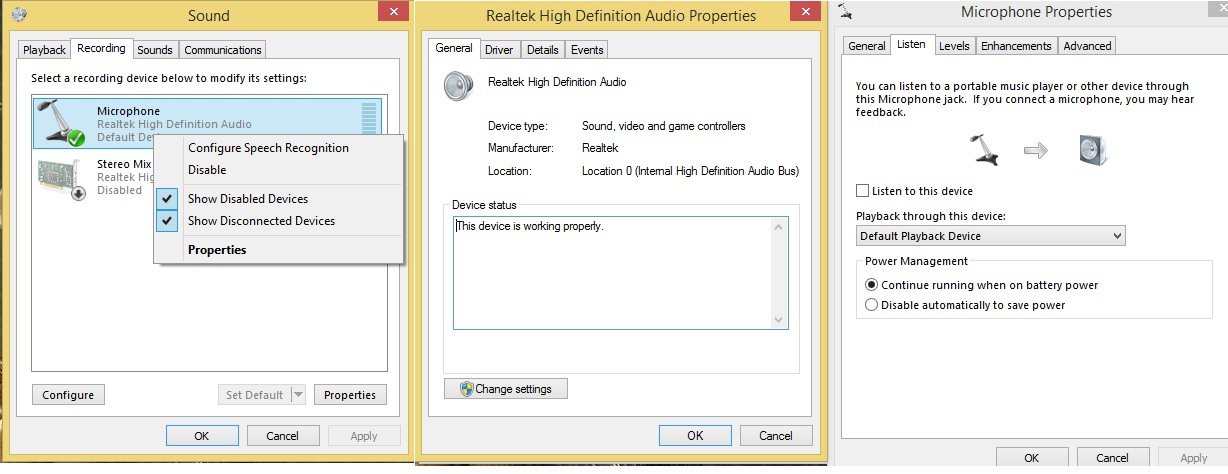

3. Now, When I go to the lower right corner and select Recording Devices from the sound panel, it won't show any external or added device when I plug in the new device. It would just show my internal MIC and something called Stereo MIX, but not my Microphone. 3.jpg

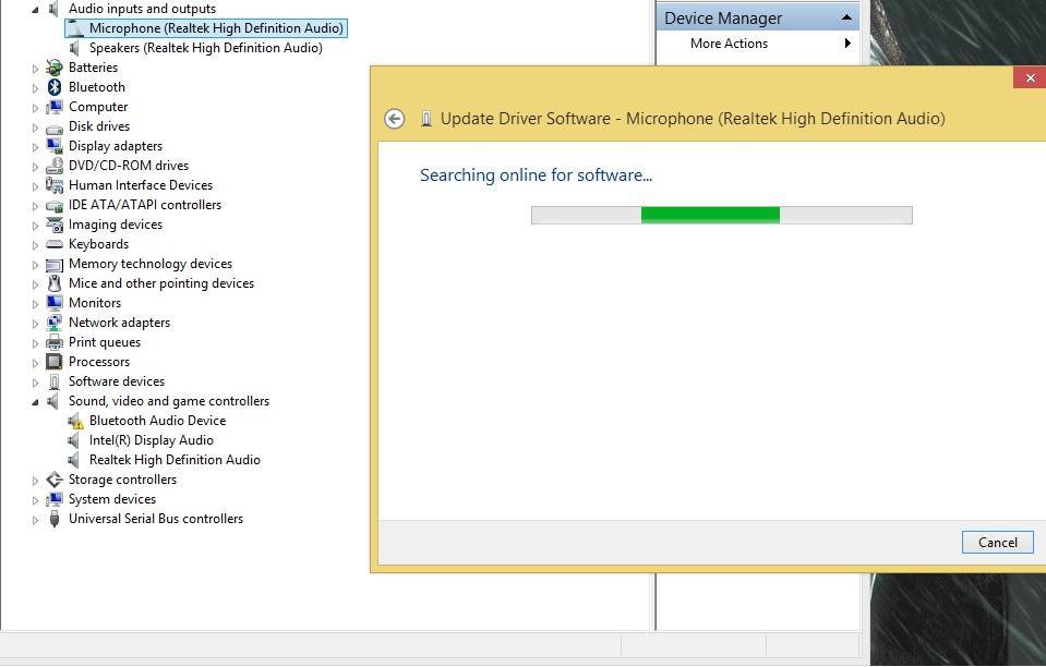

4. Okay, Now when I check Device Manager, and try to update all the Realtek Audio drivers it would just say "everything is latest with latest drivers installed", which is obvious since Windows 8.1 has bundled everything with my laptop. 4.jpg

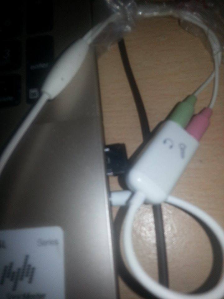

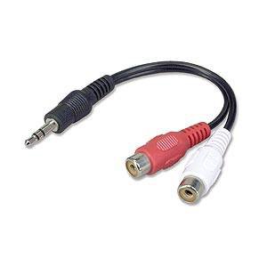

5. Now you must be thinking of a solution like since my headphone has 2 wires (the red and the black), why not use a Audio Splitter which looks something like this... P4730a.jpg, I even bought that one and tried it without any luck. It still won't detect.

The splitter you show will not work with a PC. Its designed for an iPhone, PS4, etc. A PC plug is only Tip, Ring and Sleeve. The one you show is Tip, Ring, Ring, Sleeve. A PC microphone requires +5VDC, which is on the Ring connection to work.
Usually, PC's with only one jack, can be either but not both.
Do you have or can put up a picture of the ends of those phones ? Two RCA jacks you have on that adapter are each mono, like for left and right earphone, no place for mike there.
Even when I plugged in with the splitter, It showed the same popup as it would when I plug in the headphone or mic jack without the splitter. This is my headphone and mic and as you can see both are separate. That red one is the MIC. My Asus X551ca Notebook has only one audio input on the side left of the laptop and when I put that red one in the audio input it would just show the same popup (1st image of the post), and wont recognize it as a MICROPHONE!! Why is windows doing that? Hp_Headphones.jpg

But then, isn't my splitter doing the same thing? Isn't that a four conductor 3.5mm Jack???
No way, that splitter is not even close to what you need. Those RCA ends you have are for 2 MONO RCA jacks and are not made to stick 3.5mm stereo jacks in them. Those Headphones need to be plugged in two separate female stereo jacks, output speaker jack and input stereo microphone jack. If you have only one sound jack in that computer you need an adapter that has: One male 3.mm 4 ring connector ( from picture 2 in Asus Gide) and 2 stereo 3 contact female jacks (female counter parts from picture 1).
Edit.
Here, I found one you need 3.5mm Stereo 4POLE Plug to MIC microphone + Headset earphone Jack Adaptor iphone | eBay

I didn't see a splitter in that guide, anyway it should look like the one from eBay.

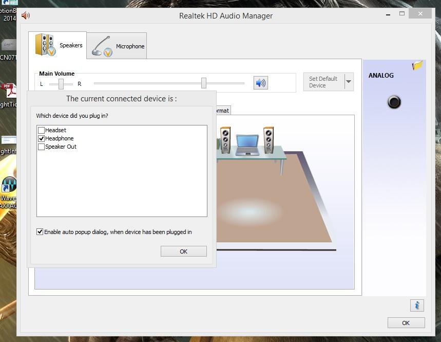

When I plug the headset into the laptop, the Realtek software asks me if its headphones, mic, or speaker out. No choice for headset. If I choose headphones, the headphones work and the mic does not. If I choose mic, nothing works. The stick mic does not work. NOTE: None of the mic attempts ever showed up on the recording tab as an external mic.)
