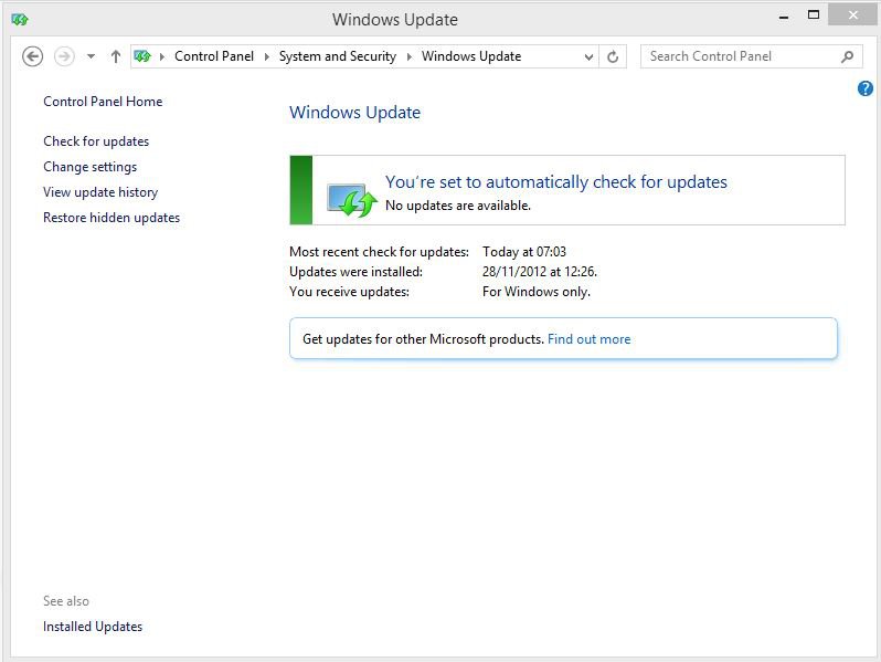

Go to Control panel (move the cursor to the bottom left, right click), System and Security, Windows Update, find Installed Updates (bottom left ) and post a screen shot.
That's the thing, Brummyfan. Windows Update is unresponsive no matter where I try to start it from. It simply hangs. :/
Couldn't you be able to open this window (snip), could you click Installed Updates and get a snip of that screen.
