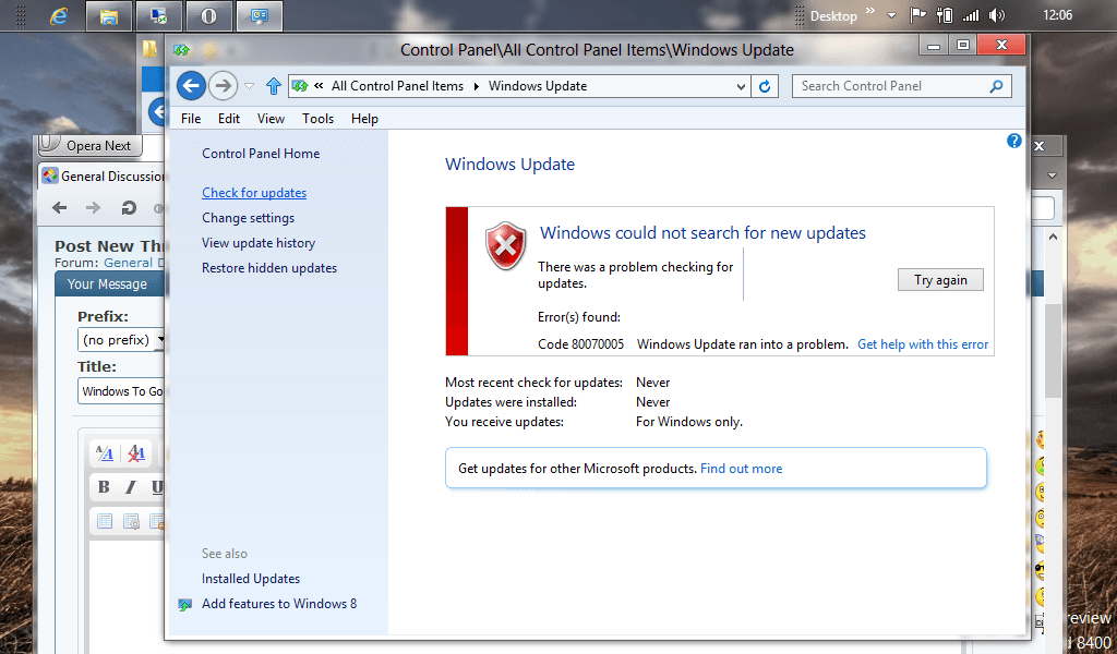

I has set Windows Update to Automatic, so I did not know it was not receiving updates, but when I tried to install .NET 3.5 and failed, to install my Canon Pixma ip3000 and failed, and then when I checked for Updates I got:
Screenshot (1).png It seems unable to receive updates.
error 80070005 occurs in Windows 8 Release preview - Microsoft Answers
This is the second RP installation - fails just like the first.
Do any other members with Windows To Go on USB sticks face this problem or am I alone?
View attachment 6716 It seems unable to receive updates.

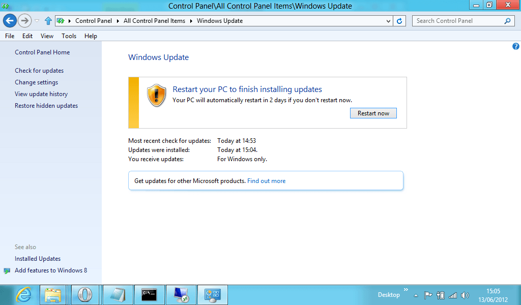

I used the local usbdriver Nifu, and managed to use Windows Disk Management console to shrink the Windows 8 partition and add a second partition to the flash drive - ok - rebooted to the Windows To Go - also ok - then tried to add the driver within that system - which now won't boot - back to the drawing board then!
I only can use 32-bit, but alls fixed now - just needed to rewrite the Boot Config.
I can confirm that Windows updates are now being installed after successfully downloading.
Screenshot (4).png Success!!!
Many thanks Nifu - that is a definitive solution to the problem. Thanks too to How to Make Flash Drive a Local Disk | eHow.com and Index of /downloads USB_LocalDisk.zip
