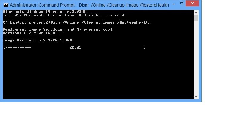

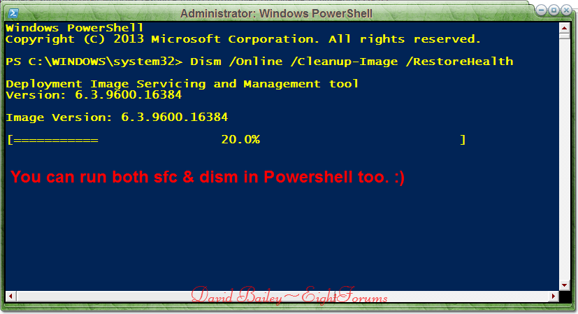

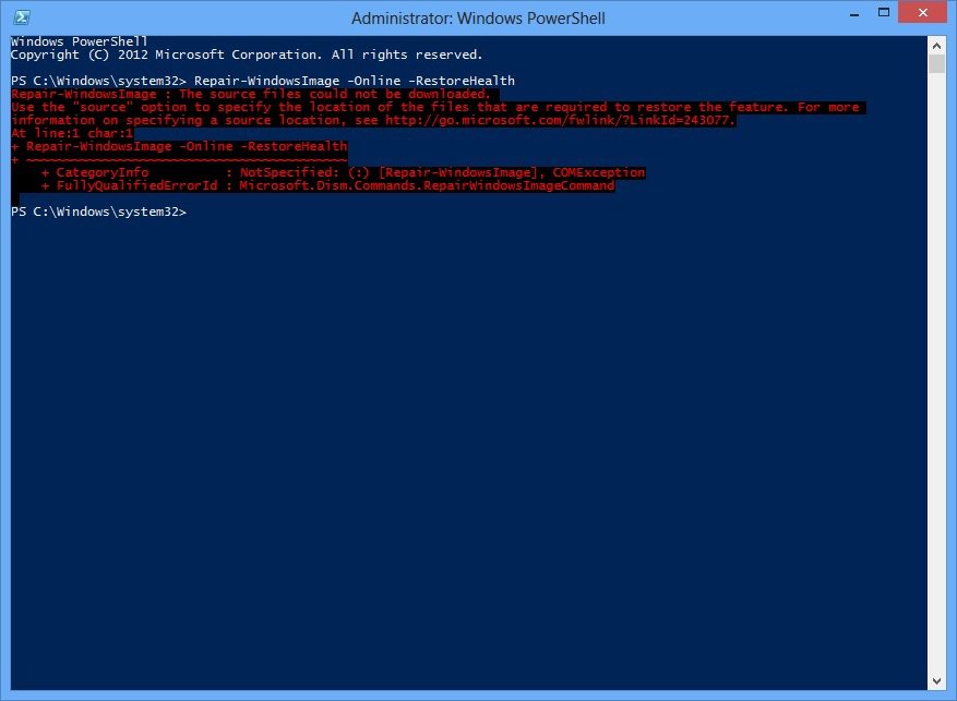

thnxx David Bailey , I am running the CMD promt with Dism /Online /Cleanup-Image /RestoreHealth and it is running (scrrenshot attached) meanwhile when I was searching for other alternatives I Found that i can repair windows image file by powershell CMD (screenshot is attached) and the results to it is also attached . well I just wish the /restorehealth 2.jpgUntitled.jpgdo the trick..

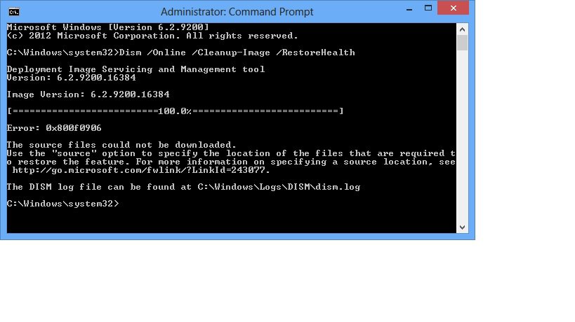

thnx david bailey, but I think I am Unfortunate cuz nothing worked for me see the results of Dism /Online /Cleanup-Image /RestoreHealth :'(main.jpg
thnx david , but it seems i am unfortunate nothing is working for me this time . see the screen shootmain.jpg
Hmm.. i tried that also but both of them have problems in completing their process and there are no changes made by them... I don't have my recovery disks .. I think i have to reinstall my windows.. will rush to sony centre :sleepy:
thnx david , but it seems i am unfortunate nothing is working for me this time . see the screen shootView attachment 36740
The reason you are getting the error with DISM repair command is because DISM is trying to get the healthy image from Windows Update, but most likely the Windows Update service isn't running, I hate when that happens.
Try typing wuauserv into an elevated command prompt and see if you can get Windows update to start. If the service starts make sure you can get online.
If it shows as started successfully then try running the DISM repair command again then run sfc again with maybe reboots and repeat sfc if required.
