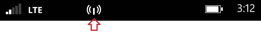

- Tap the top of the phone's screen to see the status bar, which has icons that tell you a lot about your phone—including information related to connection sharing. When you're sharing your cellular data connection, the Internet sharing Sharing
icon appears at the top of the screen.

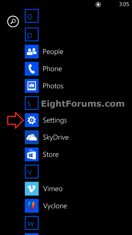

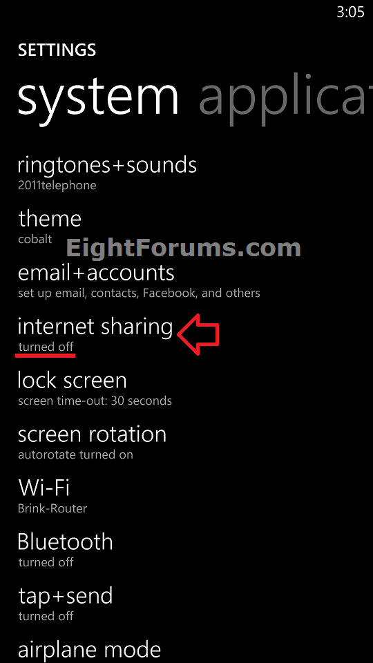

1. On your Windows Phone 8, open the app list, and tap on Settings. (see screenshot below)
2. Tap on internet sharing in system settings. (see screenshot below)

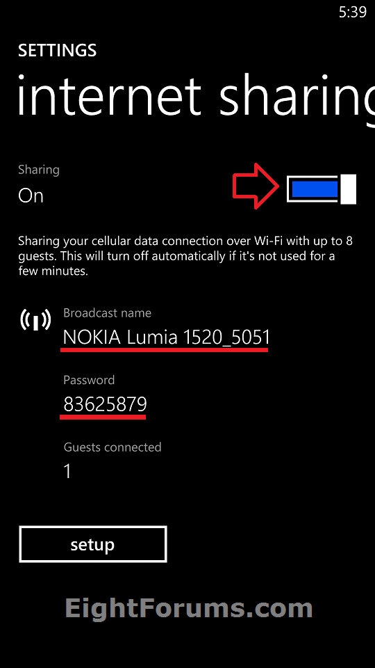

3. Turn on internet sharing, and do step 4 or 5 below for what you would like to do. (see screenshot below)
4. If you want to continue using the current Broadcast name and Password, then go to step 6 below. (see screenshot below step 3)

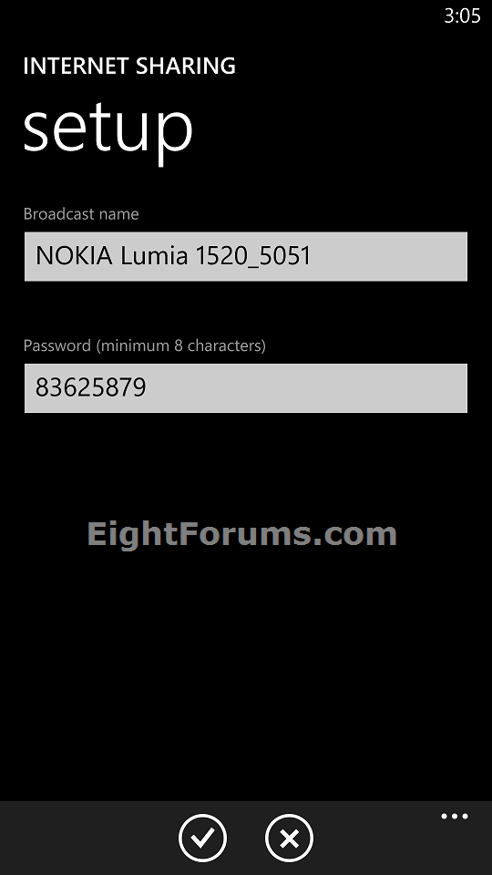

5. If you want to change the Broadcast name and Password, then tap on setup. (see screenshot below step 3)
NOTE: The broadcast name or password cannot include these characters: "&'<>
A) In the Broadcast name box, type a network name. This is the name that you and others will see and use to connect to your shared connection over Wi-Fi on another device. (see screenshot below)
B) In the Password (minimum 8 characters) box, type a password that's required to connect to and use your shared connection.

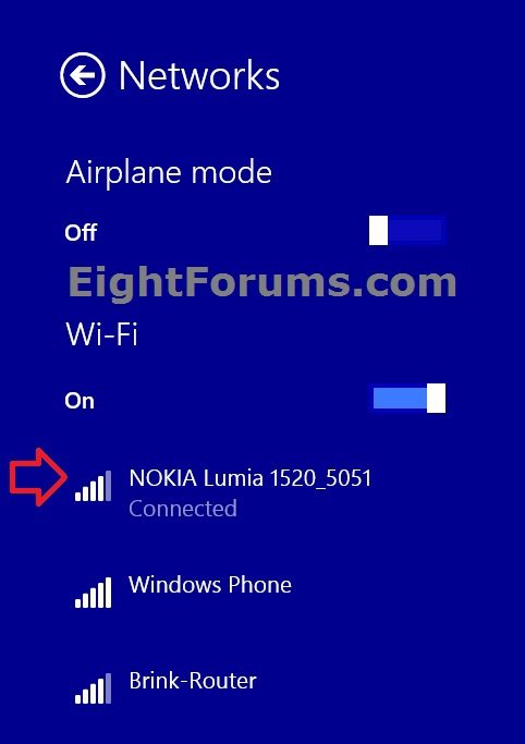

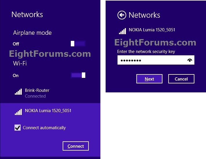

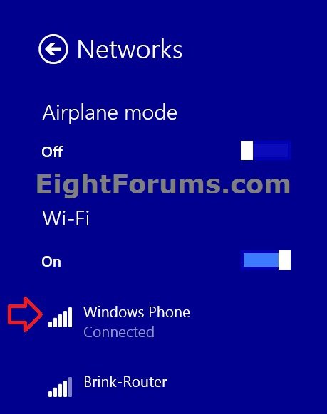

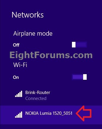

6. To use your shared Internet connection on a Wi-Fi enabled device, select the broadcasted Wi-Fi network name on the device, and then enter the password. For example, on a wireless Windows 8.1 laptop or tablet. (see screenshots below)

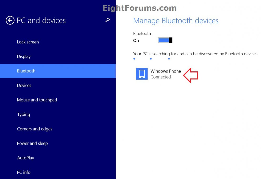

If you often connect on with a Windows 8.1 tablet or laptop, then you could also use Bluetooth to pair your Windows Phone 8 with the Windows 8.1 tablet or laptop to make connecting easier.
When paired, you'll be connected and ready to go. The password is entered for you, and you can connect even if Internet sharing is turned off on your Windows Phone 8. This will allow you to not have to dig out your phone and turn on Internet sharing since it's done automatically when paired.
You will need to have Windows Phone 8 software version 8.0.10501.127 or later installed to be able connect this way.
When paired, the Windows Phone 8 wireless network in Windows 8.1 will have the same name (ex: Windows Phone) in Networks (connect to) as it shows in Bluetooth devices.
