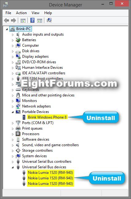

If phone screen is not projecting on PC:
If you don’t get a prompt on your phone (step 4), and the Project My Screen App remains blank (step 5), then you may have old phone drivers still installed on the PC that need to be uninstalled first.
  • Open the WIN+X menu, and click/tap on Device Manager.
  • Right click on each device (one at a time) for your phone like below, and click/tap on Uninstall.
  • In the Confirm Device Uninstall dialog, check the Delete the driver software for this device box if available, and click/tap on OK.
  • When finished uninstalling all devices and drivers for your phone, unplug your phone, and repeat step 3 above.

Can't seem to get the Project My Screen to work. Followed your tutorial here. The app downloaded and installed ok. It stated that a reboot might be in order, but never stated I should. Opened the app, connected my phone to the same USB port I've always used with my WP8 Store app, and went to the Project My Screen settings on the phone to no avail. It just sat there like this:
I disconnected the phone from the USB, rebooted both PC & phone, tried again to no avail. Went to Device Manager thinking it may be USB problems and sure enough I see the phone listed 3 times as seen below. It's strange since I always use the same front PC port that I leave the cable in. However I could have plugged it in by mistake in the port next to it, but then why would it be listed 3 times?
The 3 times it shows in USB is wrong? Wrong driver for this, but correct one for the Store app? Any ideas?

Hey Tony, :)
Yep, that would be correct. The screenshot of my Device Manager is what you should normally have no matter what or which USB port you connected the phone to.
If you haven't already, connect the phone and uninstall the devices and drivers to see if Windows will recognize the phone afterwards (ex: to be able to open the phone in "This PC"), and then hopefully have project screen work properly.

Thanks, Shawn. That worked. :thumb:
