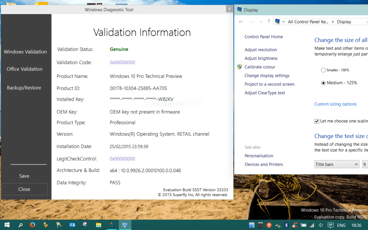

Fixed DPI scaling issue.

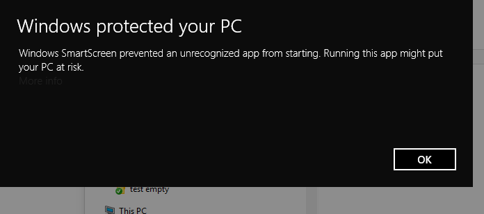

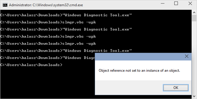

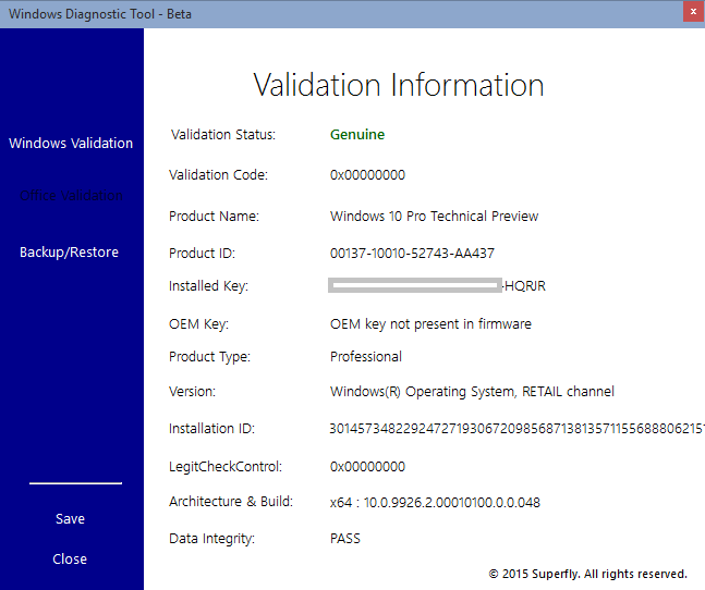

Good work. Works well on 9926 (except for restoring activation which doesn't but you said it isn't tested). These are the issues I've found in case it helps :)
  • It is blocked by SmartScreen and I couldn't find a way to turn this off in this build. Had to run it from CMD prompt (probably not an issue).
  • Office activation I couldn't test as I have Office 16 and it isn't activated. The option was not available.
  • Activation backup says "Activation is being backed up" when it has finished (should say "Activation backed up" I guess).
  • Installation ID is truncated on screen (see below)
  • Install date isn't formatted in report ( Install Date: 20150211132923.000000+060
If I can make a suggestion it would be useful if you could copy the key (to clipboard perhaps) as you can't cut and paste from the screen and the key is redacted in the report. View attachment Windows Diagnostic.txt
I then removed my activation with slmgr.vbs -upk
Problems with restoring activation after:
  • Restore dialogue warns ActivationBackup will be replaced (rather alarming message but it didn't happen).
  • Dialogue indicates restore was a success.
  • It wasn't though.
  • There was an error message when trying to save the report (I renamed the existing Windows Diagnostics.txt from earlier then it was OK) View attachment Windows Diagnostic after.txt

BTW Can't one unblock the .exe from smartscreen?

That was quick - Backup/Restore works with this build (for me).
Smartscreen doesn't have the "more info" button it had in 8.1 which would let you run it anyway. I need to look around some more. When I run it from CMD and this new build gives a seemingly unimportant error (as the application works). The last one didn't do that.
Actually I forgot that Store listings are free now - may as well get it certified.

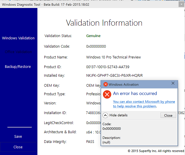

It appears SPP has become a lot smarter. It now has a built in mechanism to repair a corrupt store. Event viewer entries below from a diag. report after attempting to replace the store files.
****** Errors from Event Log *****
Message: The rules engine failed to evaluate the rules.
Reason:0xC004F011 Stage:GATHER_RULES_FROM_LICENSES
Additional Data:
Time Written: : 20150216054646.000000-000
Additional Data:
Time Written: : 20150216054305.000000-000
Message: Token Store found to be corrupt. Recreating Token Store.
Time Written: : 20150215230743.000000-000
Reason:0x8007000D Stage:BUILD_ACTIONS
Additional Data:
This effectively means only online activation is allowed. A good thing in the overall context as in the past we had to rename those files and use slmgr.vbs /rearm to re-create the corrupt store - it's now automatic.
[DEL]Backup can thus be limited to the key only as far as I can see. Obviously a huge setback for offline activation though. [/DEL]
EDIT: Seems the corruption was not due to backup files (must have been due to manually manipulating the store files) - either way restore seems to be working now.

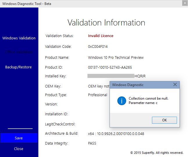

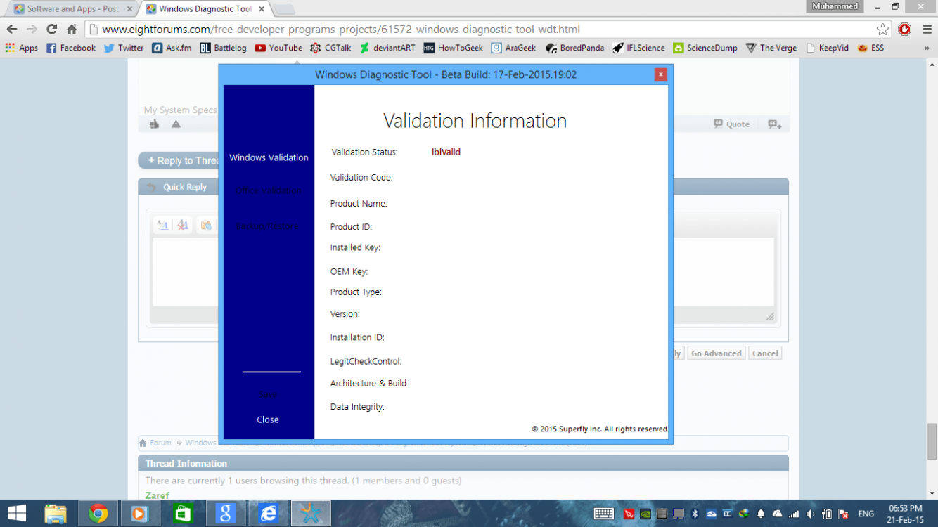

Zaref
163
Egypt

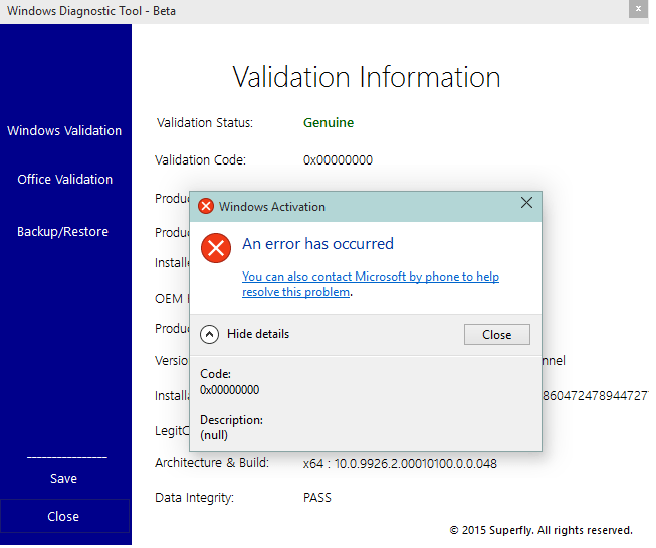

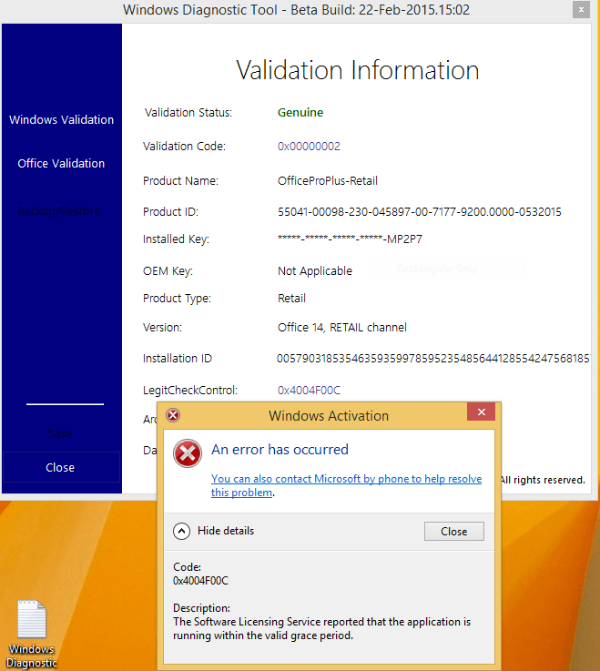

I don't know why but smartscreen is working (I had to re-install for other reasons). It all looks good to me.
One small cosmetic issue. There is a link on the error code - it would be good if this was a different color so it is clear it is a link.
If your license is valid (and error code is zero) you get this...

@Zaref... please try the new build.

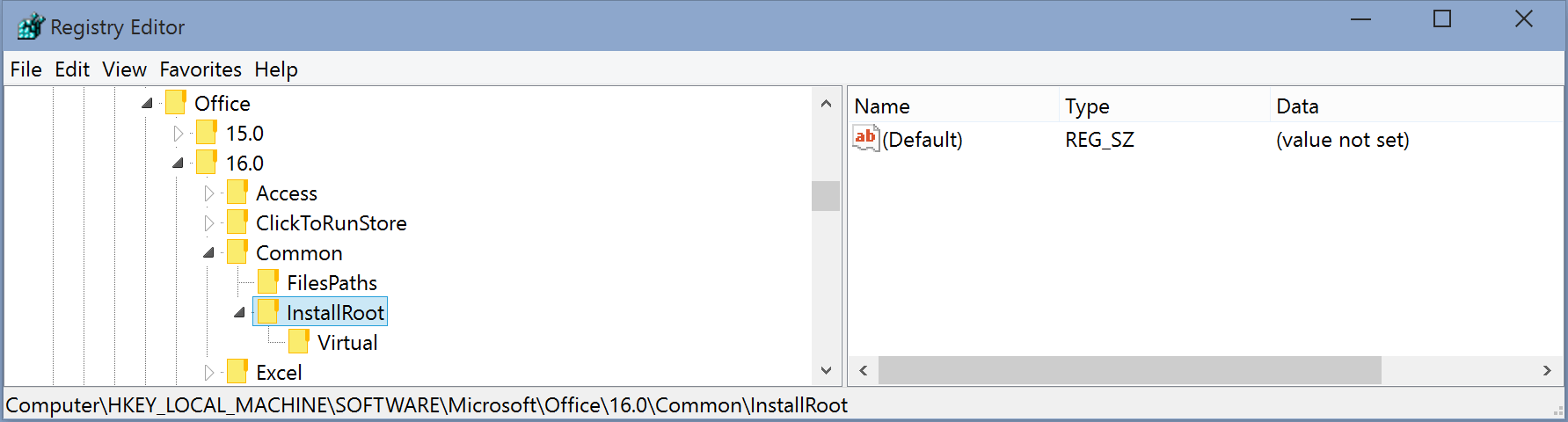

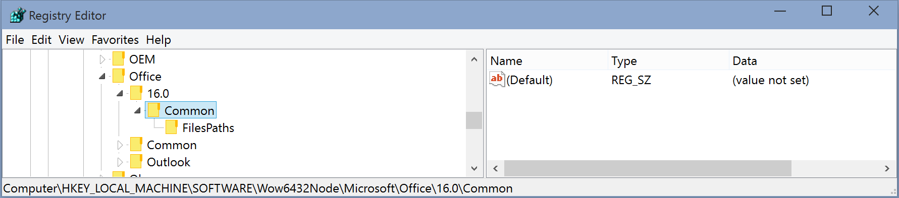

BTW: Does Office 16 have the following LocalMachine reg values?
eg:
32 bit: "SOFTWARE\Microsoft\Office\16.0\Common\InstallRoot"
64 bit: "SOFTWARE\Wow6432Node\Microsoft\Office\16.0\Common\ProductVersion"
Office 2010 :
eg:
Yes and No. x64 Office 16 preview installed as a trial, not activated so can't check with the tool (button is disabled).

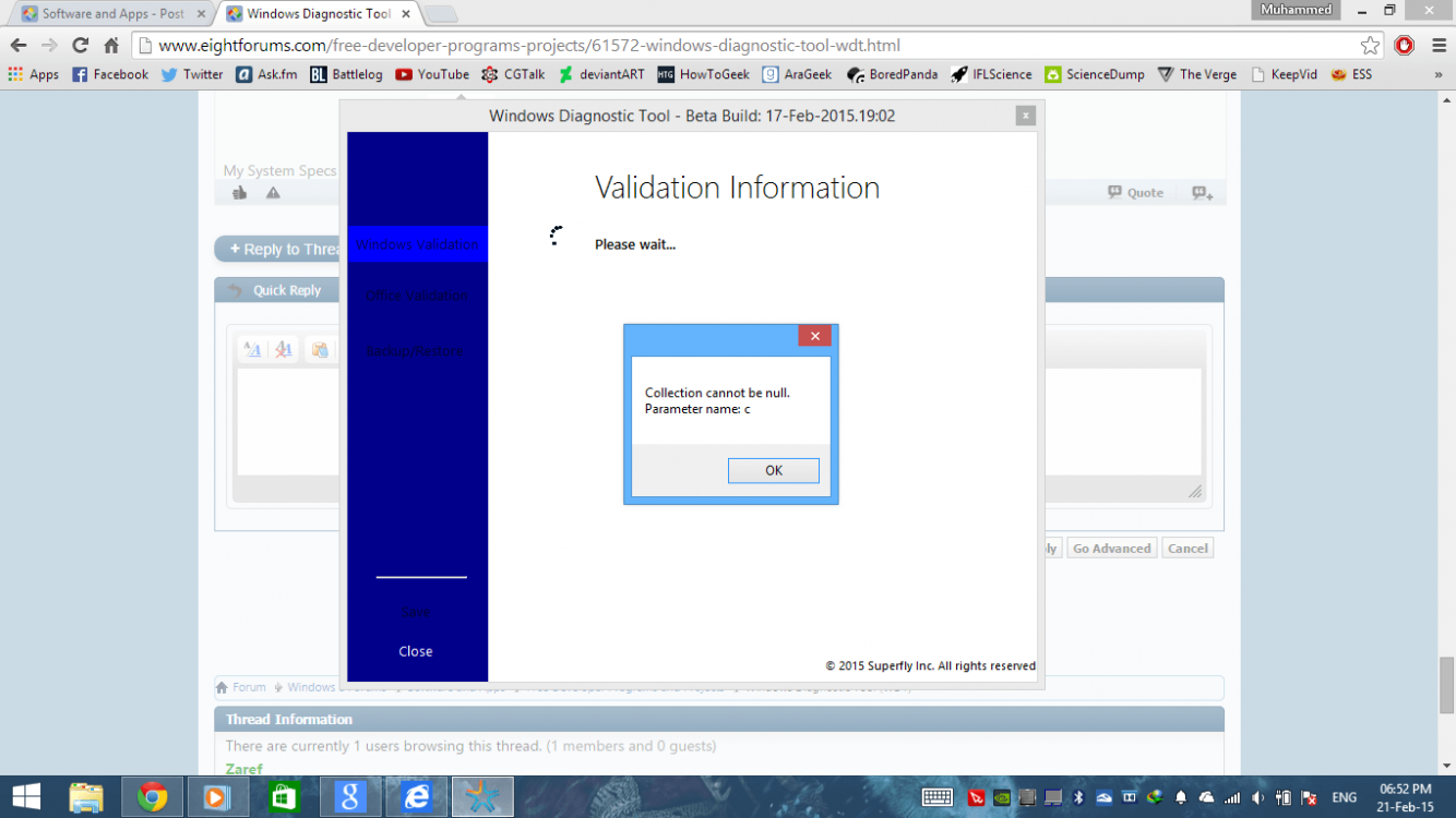

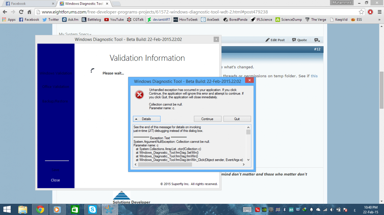

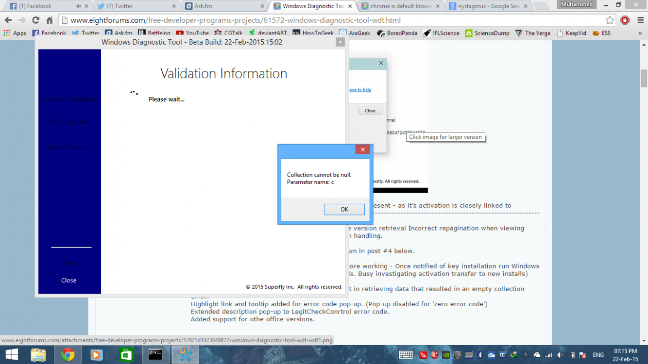

Zaref
163
Egypt
still getting the same error message

Superfly
Developer
1,099
Cape Town
Thanx Adam ... I'll get hold of a copy of Office 16 and see what's changed.
Zaref, it seems to be either due to synchronicity between threads or permissions on temp folder. See if this build fixes it.

Zaref
163
Egypt
i'm using OEM could this be the cause of error ?
See the end of this message for details on invoking just-in-time (JIT) debugging instead of this dialog box.
************** Exception Text **************
System.ArgumentNullException: Collection cannot be null.
Parameter name: c
at System.Collections.ArrayList..ctor(ICollection c)
at Windows_Diagnostic_Tool.frmDiag.SetWin()
at Windows_Diagnostic_Tool.frmDiag.frmWin()
at Windows_Diagnostic_Tool.frmDiag.btnWin_Click(Object sender, EventArgs e)
at System.Windows.Forms.Button.OnMouseUp(MouseEventArgs mevent)
at System.Windows.Forms.Control.WmMouseUp(Message& m, MouseButtons button, Int32 clicks)
at System.Windows.Forms.Control.WndProc(Message& m)
at System.Windows.Forms.ButtonBase.WndProc(Message& m)
at System.Windows.Forms.Button.WndProc(Message& m)
at System.Windows.Forms.NativeWindow.Callback(IntPtr hWnd, Int32 msg, IntPtr wparam, IntPtr lparam)
************** Loaded Assemblies **************

jitDebugging value set in the system.windows.forms section.
The application must also be compiled with debugging
enabled.
For example:
<configuration>
<system.windows.forms jitDebugging="true" />
</configuration>
When JIT debugging is enabled, any unhandled exception
will be sent to the JIT debugger registered on the computer
rather than be handled by this dialog box.
same error but with different window style
Nope,... I'll send you a JIT-enabled version to see where it breaks...

Ok I'm waiting
Sorry, been a bit busy - usually only have time weekends to get stuck in... anyway sent you a debug version.
Please unzip the 3 files together and let me have the log file created.

done
PMed you the log

Hi there
@Superfly
Your Windows validation tool is fine but I only get a non expandable half screen -- something in .NET or VBA.
Nice tool if you could fix it.
Cheers
jimbo
Fixed.
