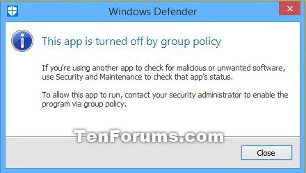

EXAMPLE: Windows Defender Turned Off

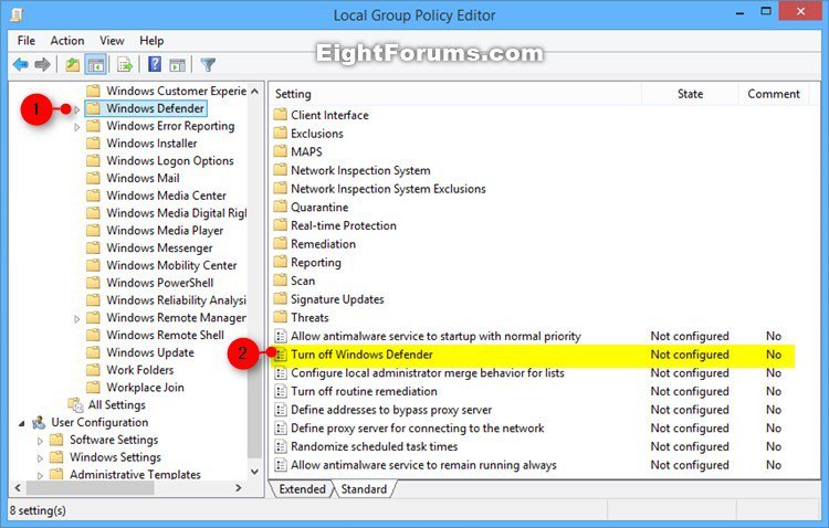

1. Open the Local Group Policy Editor.
2. In the left pane of Local Group Policy Editor, navigate to the location below. (see screenshot below)
Computer Configuration\Administrative Templates\Windows Components\Windows Defender
3. In the right pane of Windows Defender in Local Group Policy Editor, double click/tap on the Turn off Windows Defender policy to edit it. (see screenshot above)

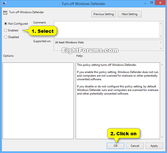

4. Do step 5 (on) or step 6 (off) below for what you would like to do.
5. To Turn On Windows Defender
A) Select (dot) Not Configured or Disabled, click/tap on OK, and go to step 7 below. (see screenshot below)
6. To Turn Off Windows Defender
A) Select (dot) Enabled, click/tap on OK, and go to step 7 below. (see screenshot below)
7. When finished, you can close the Local Group Policy Editor if you like.

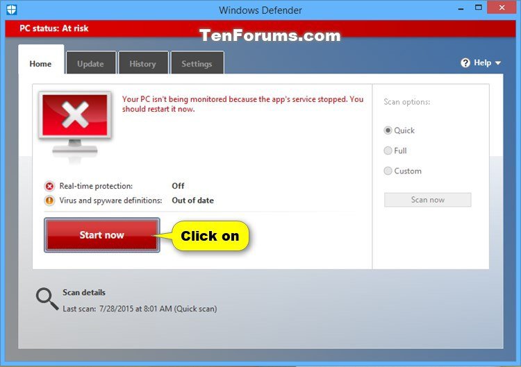

8. If you are turning on Windows Defender, then open Windows Defender, and click/tap on Start now.

7. If you are turning on Windows Defender, then open Windows Defender, and click/tap on Start now if needed.
