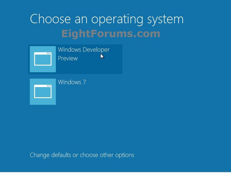

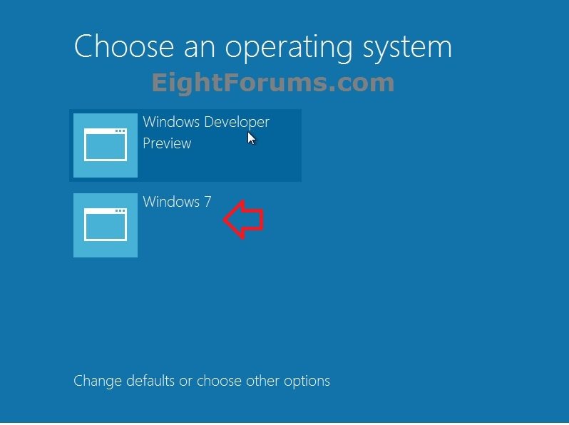

EXAMPLE: "Choose an operating system" Screen at Boot
NOTE: This is what you will see now at boot or restart instead of the Windows 7 Windows Boot Manager screen to be able to select to start either Windows 7 or the Windows 8 from the VHD file.

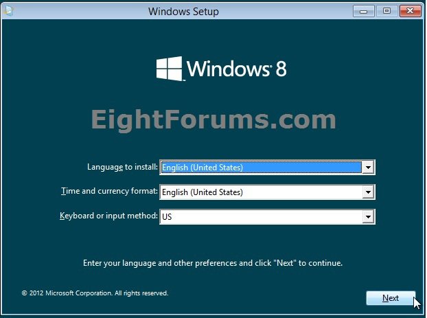

2. Boot or restart the computer from your Windows 8 Pro or Enterprise installation DVD or USB thumb drive.​
NOTE: To have Windows 7 on VHD, see instead: How to Create a Windows 7 VHD at Boot to Start with from Boot

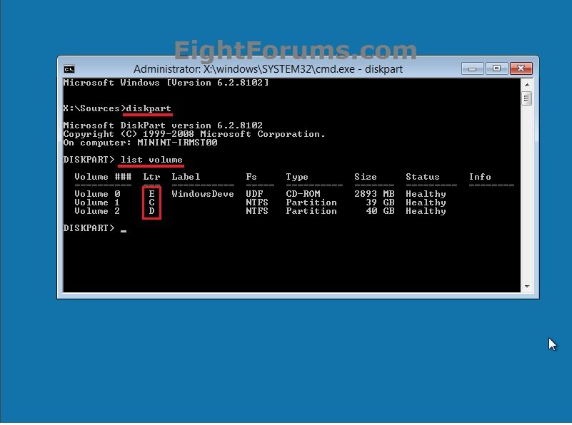

3. At the Install Windows 8 screen, press the Shift + F10 keys to open a command prompt. (see screenshot below)​
WARNING: If you are using a language other than English, then see this post first.​

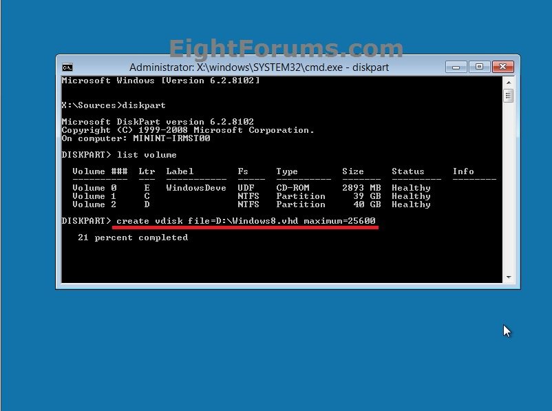

4. In the command prompt, type diskpart and press Enter, then type list volume and press Enter. Make note of the drive letter for the volume that you want to create the Windows 8 VHD file on. (see screenshot below)​
NOTE: This will allow you to see what the drive letters are for each volume. They are not always the same at boot as they are in Windows.​
5. Do either step 6 or 7 below for what type (fixed or dynamic expanding) of VHD file you would like to create.​
6. To Create a Fixed VHD File
NOTE: A fixed VHD file will allocate the entire maximum size that you set (ex: 30GB) below on the HDD to be used by the VHD file. The VHD will only use a fixed amount of space (ex: 30GB) regardless of the amount of data stored on it.
A) In the command prompt, type the command below, press Enter, and go to step 8 below.​
NOTE: Substitute the D drive letter in the command below for what volume (step 3) you would like to create the VHD on. You can substitute the Windows8 name with any name you would like within quotes for the VHD file instead. You can also substitute the maximum size of 30720 MB for the VHD to the maximum size you want instead in MB (1GB = 1024MB).​
create vdisk file="D:\Windows8.vhd" maximum=30720

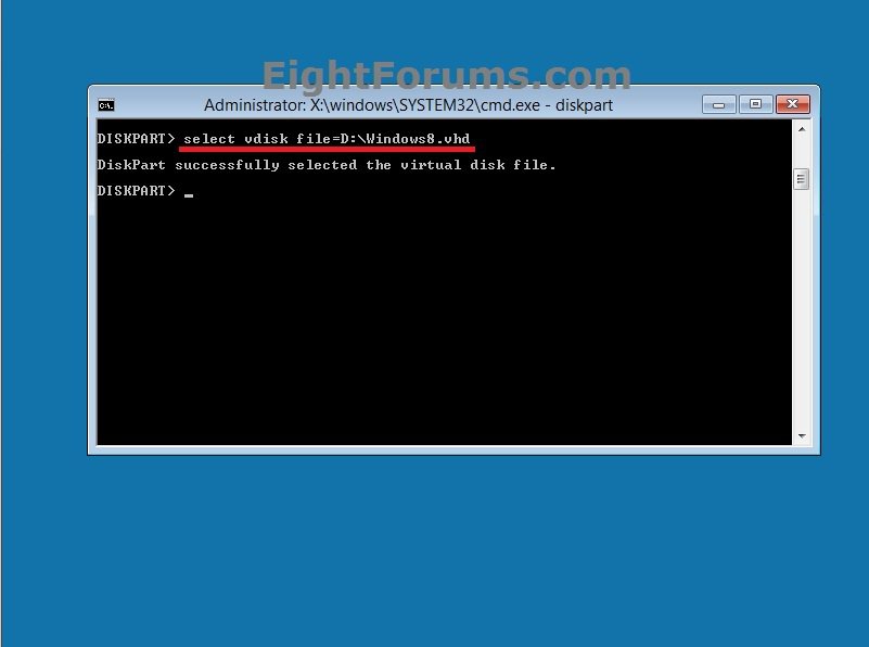

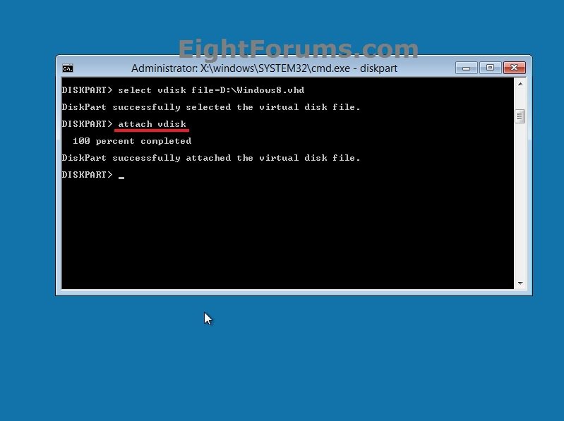

8. In the command prompt, type the command below and press Enter. (see screenshot below)​
NOTE: Substitute the D drive letter and Windows8 VHD file name in the command below to the same one that you used in step 5 or 6 above.​
select vdisk file="D:\Windows8.vhd"

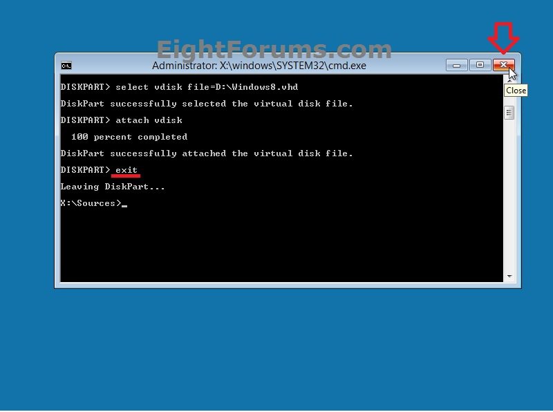

9. In the command prompt, type attach vdisk and press Enter. (see screenshot below)​
10. In the command prompt, type exit and press Enter, then close the command prompt window. (see screenshot below)​

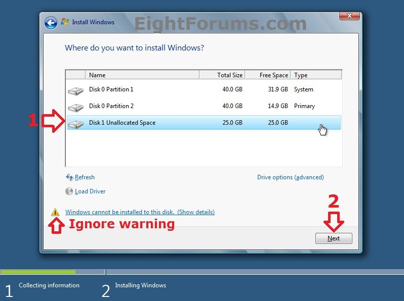

11. You can now finish doing a clean install of Windows 8, and select the unallocated space (ex: 30GB) that you created in step 6 or 7 above. (see screenshot below)​
12. When finished, you will be in Windows 8 with Windows 8 set as the default OS to start automatically after the wait time. Restarting Windows 8 will allow you to be able to select what OS you would like to start with like in the example at the top of the tutorial.​
