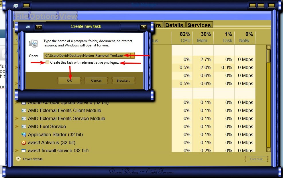

I have just started experiencing this same issue on my Dell Inspiron Laptop and agree that it is as frustrating as it sounds. I was about to try the Norton uninstall solution but cannot even get to that option. I am able to access my Windows 8 Start screen after rebooting but as soon as I click on any Apps that run through the desktop I am back to the desktop/blue screen flickering stalemate. Does anyone have an idea of how I might bypass the desktop to uninstall Norton and give that solution a try?
Are you able to boot into Safe Mode?
If you can access Task Manager, Download this Uninstall tool first & choose File, New task, with administrator privaleges.
& choose the uninstall tool by browsing for it.
I suggest downloading it to desktop so it is easy to locate.
https://support.norton.com/sp/en/us/home/current/solutions/kb20080710133834EN_EndUserProfile_en_us
Hope this helps. :)
