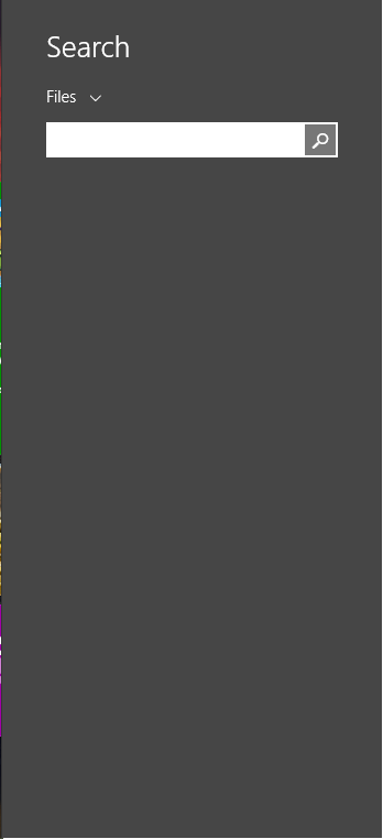

Hi everyone, I've had this problem for the better part of a month now, I was hoping the update from 8 to 8.1 would fix it but no luck.In a nutshell: Windows search for Files stopped working out of nowhere, searching for Apps/Settings works fine, but searching for Files yield no results, not only that, when I enter a file to search for it just sits there without any info on whether it is searching or not (Just says "Files" and nothing more where it usually would also say "Searching...").
I've been troubleshooting this but no one has had this exact problem, here are the solutions I've tried:
- Going to Indexing Options and manually adding the drives I wish to index to "Index these locations" and allowing for a full index. No results, no "Searching" phrase comes up either.
- Using Microsofts Windows Search Troubleshooter which essentially is supposed to fix problems like database corruption and crashes. Part of the fix is it resets the index (so my drives I added aren't in the list anymore), and it says it has Fixed the issues, but upon trying search: I do get the "searching" phrase, but I get very slow (about 25 seconds) and half-assed results (and only when I hit enter or click the magnifying glass icon), it's no longer a list of files in the search pane that starts to list file suggestions in the search pane. It also doesn't find folders.
Finally what I discovered today was in the Windows Features dialog box there is no Windows Search option (which I know should be there, it's on my laptop running Windows 8). I think this may be the key to all of this.
Any ideas on how I can fix this? I would really not like to have to reinstall Windows 8.
Thank you!
Additional note: Windows search works fine through Explorer

Thanks for the response. I am already searching for Files only.
Update: I installed Classic Shell and added certain folders to the Index and they are coming up in the Classic Shell search, the modern UI on the other hand returns no results :/

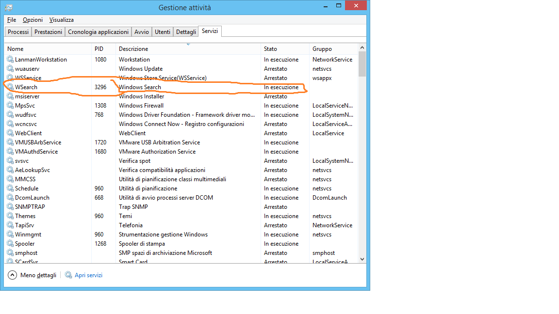

i did some digging in the search yesterday i i can tell you some hints:
make sure the search service is runnig here:

Thanks for the suggestions guys, Roy Wsearch is there on my machine as well. As far as indexing goes, I've noticed that on my laptop my main drive isn't indexed in the "Indexing Options" yet search works just fine. I've never had to mess with Indexing options and adding drives to it until this issue arose on my desktop randomly, which unfortunately hasn't fixed the Metro UI search.

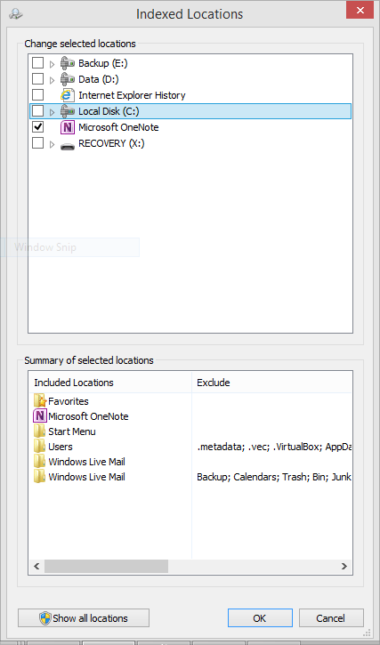

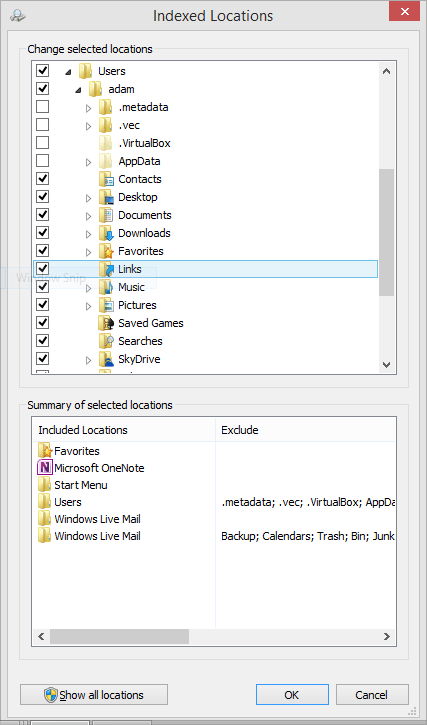

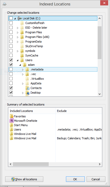

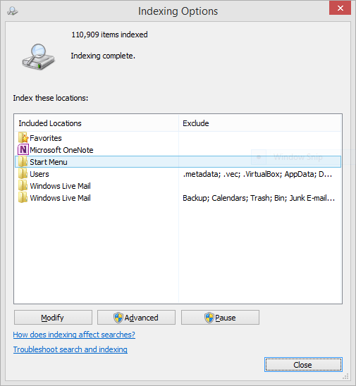

Search is not a windows feature you have to add or remove. If your service is running as Roy mentioned then that is OK. Can you send a screen print of indexing options. After the first screen click on Modify to see locations. This is "INEDEXED" locations (not "INDEXING options")
Your C:/ Drive should not be ticked (as you don't want to index everything) but if you expand it and then go to Users/You you should see that documents/pictures etc are. This is the default.
Here is an example - sorry can't get the screen prints in the correct order.

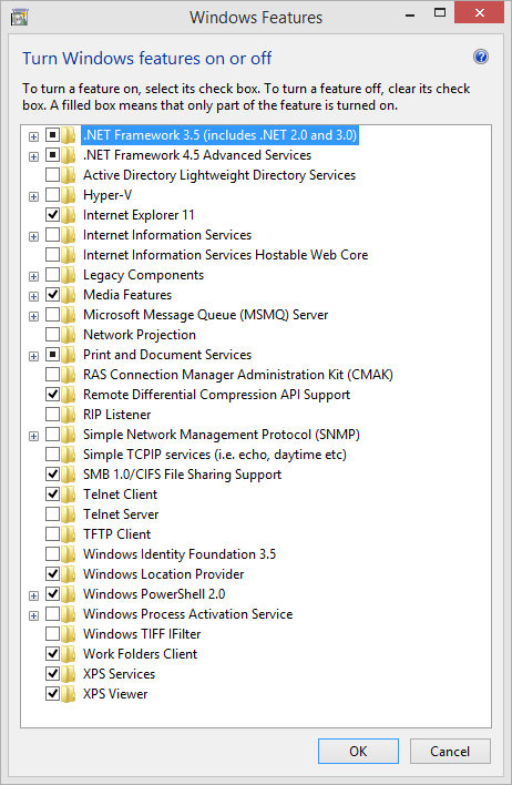

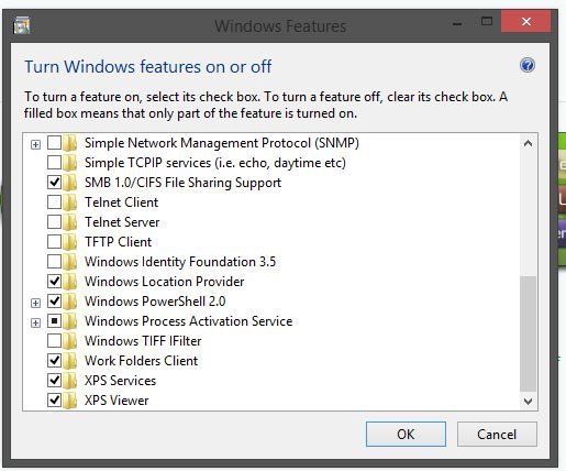

Thanks Adam, my Indexing options are fine, I've added and excluded the folders I want. The only reason I bring up the "Windows Search" check box that is no longer there is because I'm sure if you check your "Windows Features" dialog box, it'll be in yours. I'm pretty sure it was there for me as well until it disappeared. I'm thinking that is the key to the fact that the Metro UI doesn't work specifically for Files anymore - it comes back immediately with the white screen and "No File Results found for your search", the apps and settings search work fine, though.
I did check and it isn't a feature for me. Perhaps it was in the past (I really can't remember) but it isn't on 8.1. I'm afraid I'm out of ideas now though. If your indexing is complete (you checked the windows.edb?) and modern UI isn't seeing it then I can't think what else to do except re-install. I couldn't live without it certainly.
