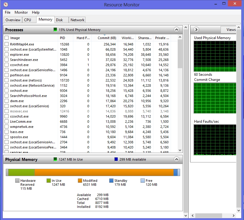

I've been out of the Windows world for a while--I run Ubuntu on my main machine--but I've been setting up a new Samsung laptop running Windows 8 and have started banging my head against the wall.

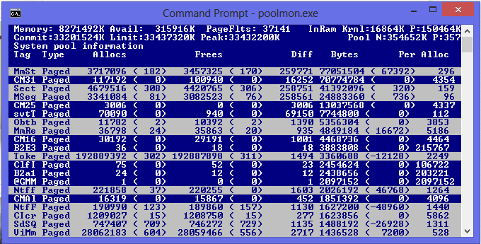

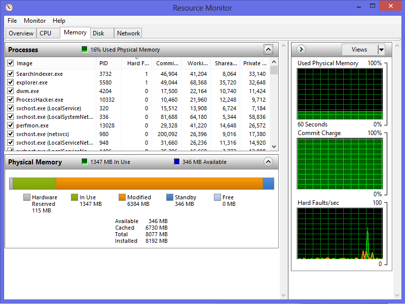

Within a few weeks of using the machine, I started getting out-of-memory warnings. Eventually made my way to Resource Monitor and discovered that a huge amount of RAM is listed as Modified--way more than is actually being used by any of the listed processes. I can't seem to pin down any specific app that is causing the problem just from observation. Sometimes it happens even within a few minutes of restarting the machine.

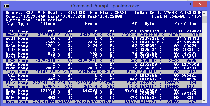

Googled a bit and eventually tried diagnosing the apparent memory leak with poolmon.exe, but I can't seem to figure out exactly what I'm looking for within that tool. Have also tried using RAMMap, but it often won't open when the computer is memory-stressed. When it does work, it indicates the same modified memory values as Resource Monitor but doesn't reflect those values in any views where memory is broken down by process (just adds up to the actual in-use values). Have tried ProcessHacker, and tried emptying the Page List through it, but the Modified Paged List value does not change.
I've done a bit of development and am comfortable with technical troubleshooting, but I'm out of practice with the Windows context and could use some pointers if anyone has some. Machine is quickly becoming unusable.
Screenshots of what I'm looking at are attached. The two poolmon images are the highest byte consumers sorted by paged and non-paged.

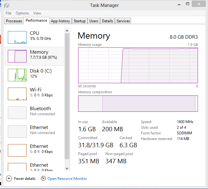

Memory shown as Modified is that on the modified memory list. This is like a staging area for memory that is waiting to be written to the pagefile before it is moved to the Standby list. But in this case the commit limit has been reached and the pagefile is most likely fully occupied already. This can happen even with low RAM usage. You probably have some kind of memory leak but more information is required. Posting a screenshot of Task Manager - Performance tab showing memory information would help a great deal. This is the best place to start. Everything else is details which may not be relevant to the situation.

Thanks for the explanation, LMiller7. That helps me understand what's going on. I'm attaching a screenshot of the Performance tab from Task Manager. Something's definitely awry--only using 1.6 GB RAM (of 8GB total) but only 200MB are available. Any thoughts are appreciated.

Just double checked and I still can't find any sign of Intellimemory on my system. The problems that people have with it seem to match up roughly with my problem, but it's not listed as a service and it's not listed as a program under the Control Panel "Uninstall programs..." section. Could it be hiding on my machine somewhere, perhaps embedded in a Samsung process? If not, any idea what else could be causing this based on the Task Manager screenshot? Cached memory definitely looks high.

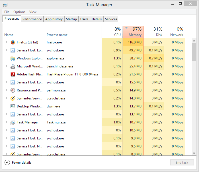

Here's the Process Tab from Task Manager if that provides any insight--the total MBs used by the processes is nowhere near the 97% of memory it reports as currently in use.

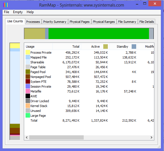

FWIW, I got RAMMap to work and got this screenshot. Essentially, all the Modified RAM is classified as "Shareable", so it's not linked up with any particular process anywhere, which if I understand correctly means there is no straightforward way to diagnose which process might have the memory leak. Argh.

Intellimemory may not be installed on your computer. If not, that is good. From what I have learned about Intellimem it's actions are not consistent with what is happening here. Post a screenshot of Resource Monitor - Memory tab with the process list sorted by Commit. This is the only number that has any relevance to this problem.

Here's the Memory Tab of the Resource Monitor with the processes sorted by Commit size. Unfortunately I don't see any obvious problems with what I see there... maybe I'm missing something?
