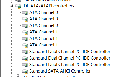

M MaDMaX Member Member Messages 13 Mar 17, 2012 #1 Can anyone see ahci driver installed in Device Manager ?
Phone Man Retired Bell Head VIP Member Pro User Messages 1,177 Location Covington, La Mar 17, 2012 #3 Her is what I have in Device Manager. On my motherboard this is my setup. Sata 0-3 - ACHI Sata 4-5 - IDE for CD/ROM JMicron - Two ports as IDE default as I don't use them.\ So it shows in Devices as 3 IDE and 1 Sata ACHI Jim
M MaDMaX Member Member Messages 13 Mar 17, 2012 #4 thanks i can see it right now... i couldnt yesterday although nothing is changed...
M MaDMaX Member Member Messages 13 Mar 17, 2012 #5 but as ssd says there is a problem... what is that ? about ahci or not ?
