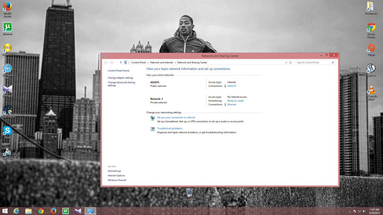

Hello guys.The only reason i'm starting a new topic is that I'am desperate.I basically tried every solution there is out there and nothing works.Here goes.
I installed win 8.1 recently and the problem is,at the title suggest,I got a connection that says Unidentified Network-Limited.I said no problem,I set up a new connection,broadband,I entered the username and password the isp gave me,and the internet works fine.The problem is,under my connection panel,I have 2 connections,one that says Unidentified-Limited,and the one I created and that works.Beside that this is an irritating problem(I could live with that),the bigger problem is that I can no longer download at full speed.I used to download with 10mg,but now,at some torrents it's now up to even 1mg,or if it is,suddendly goes down,and back up,and down again.This is a happy case,I download torrents with 500kb,a torrent which a friends downloads it with 6-8 mg.I just wanna get rid of that limited connection.
Here's how it looks like.I made the non working one private,as in a tutorial from here,but still,won't work.
If anyone can please help,I tried everything,I am desperate.Thank you.

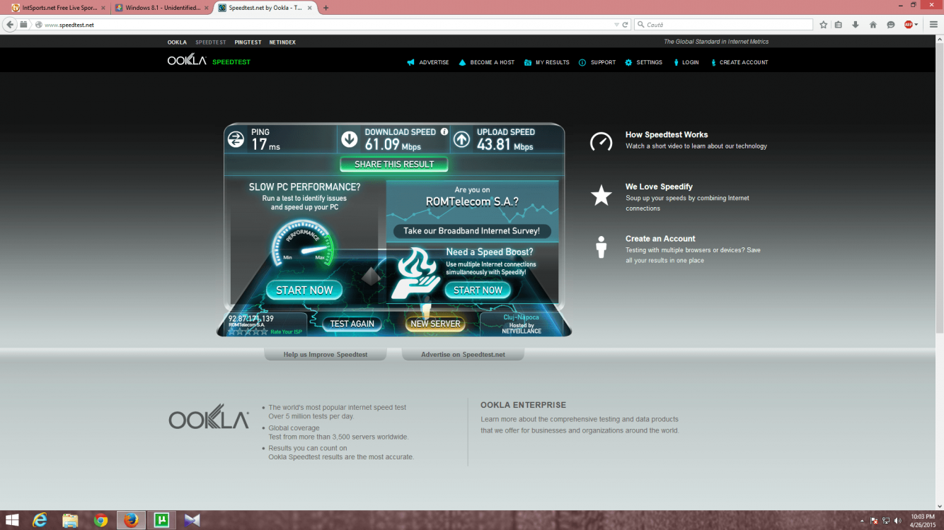

make a speed test on speedtest.net share a photo :D
And also tell what was you previous internet speed and what speed do you have now with new net?
I did paste it line by line,don't know what's the problem.
I took a speed test,it says 61 mbps...

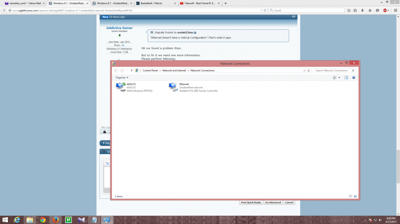

Also please again right click on network icon in right bottom corner but this time select "Open network and sharing center"
When window opens click on "change adapter settings" link in left top corner, take a screenshot and attach the image here.
Without this information it's not possible to give accurate suggestions.

And here is the screen.

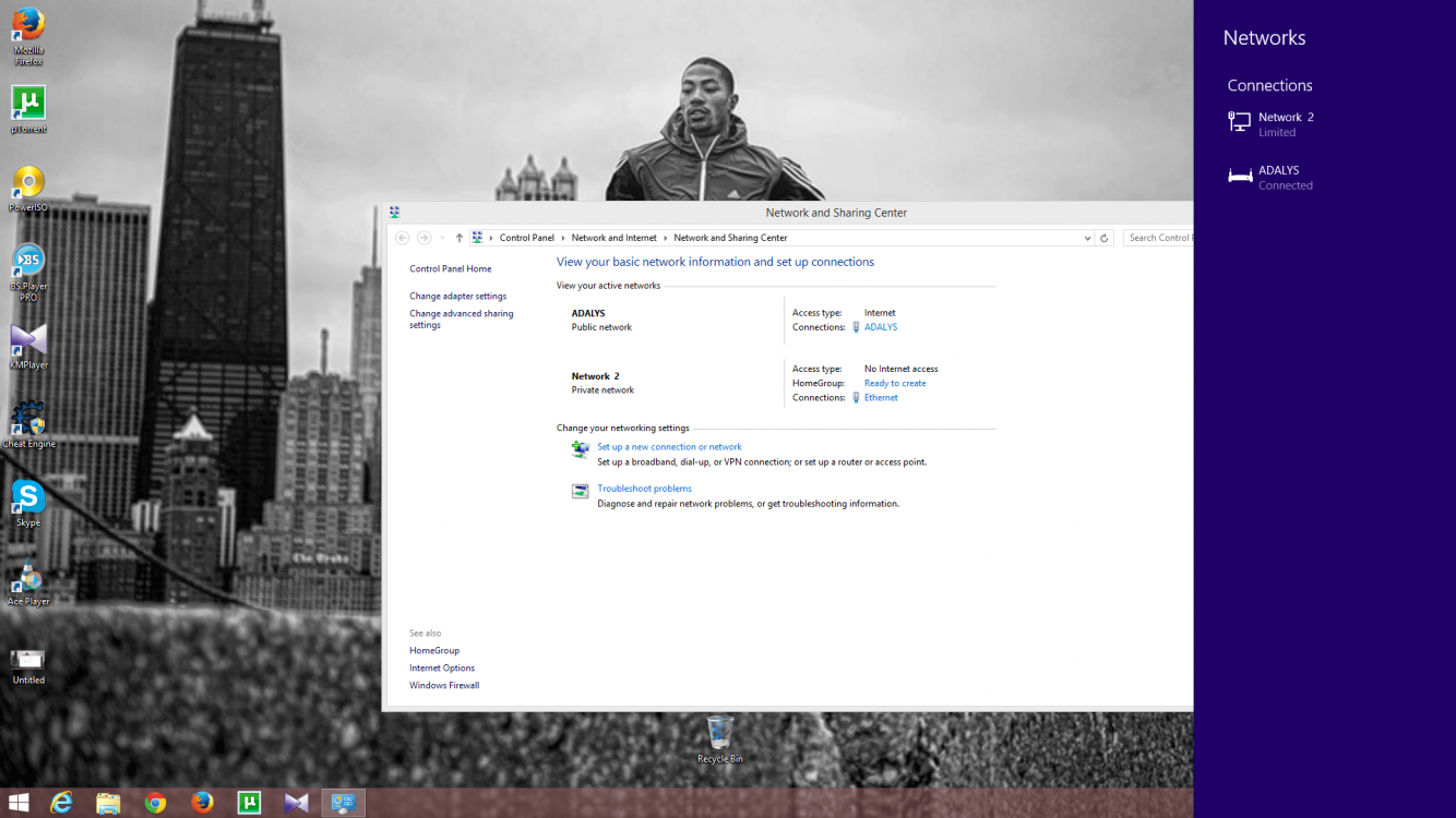

Now it only says limited and in the networking and sharing center it still says ''no internet acces''.
