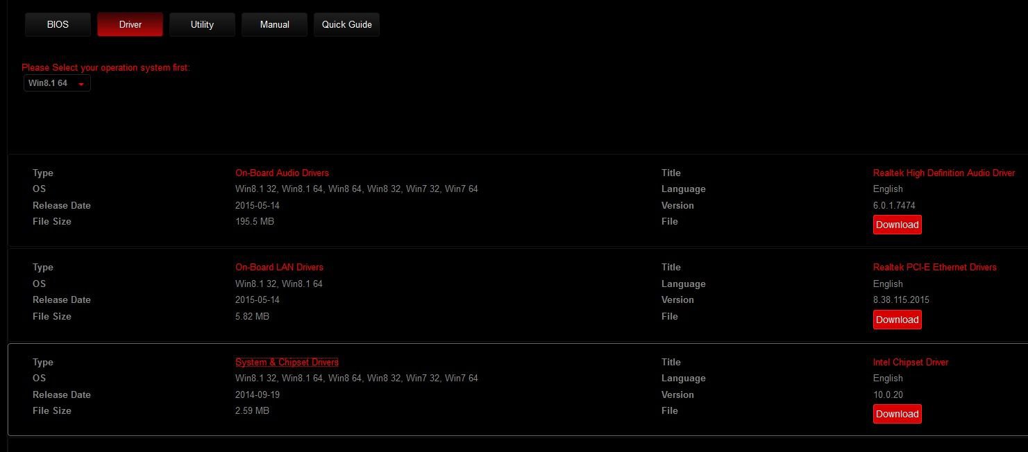

Usually these files are loaded before operating system. Check your motherboards manufacturer site for those drivers if intel would be Intel bootdisk IRST 64 or 32bit, not sure way but need to copy files on a USB Flash to install them. Either booting from it i think, get back to you make sure as never did it this way. As may just be able to go to device manager and select update driver then select the USB Flash as the location to where the drivers will be.
As have no specs to look at here to guide you to right place to find the files or check if they are correct.
Believe just the controller drivers that are missing, 64bit or 32bit windows 8.1 ?
One highlighted around in white is it, no matter to 64 or 32bit works for both, always check here for updated drivers besides BIOS which can sometimes render the PC useless.

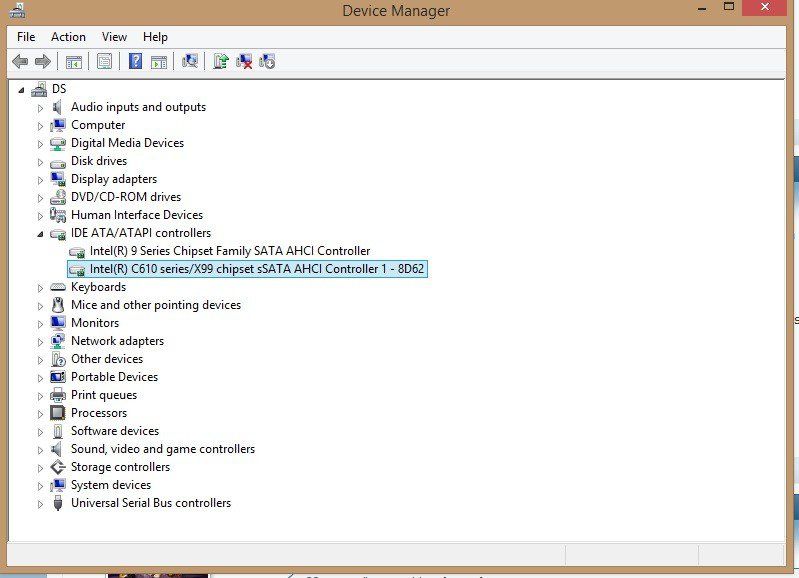

Your most welcome, unzip file, need to look for ones shown as 64bit only, not 32bit, be series of them, copy to a flash drive then go into the device manager under IDE/ATA ATAPI Controllers look there see any yellow exclamation points, this is were drivers go. Forgot to mention if drivers are missing should be yellow exclamation point in this area under IDE/ATA controllers.
Just tried that. However, the driver installer is an exe and how do I start that? I tried to start the installer exe from command prompt but came up with the error message "The subsystem needed to support the image type is not present"
