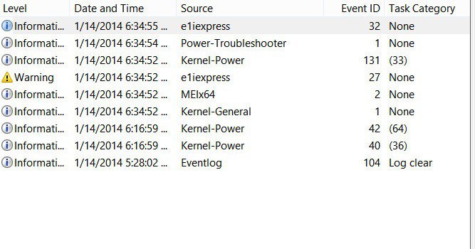

NCguy, I l cleared the logs, let the computer sleep naturally, and then took a snapshot after it woke up ( I had to refresh the log). It went to sleep at 6:16 and woke at 6:34. The arning is just the Network card sleeping.
1. Cleared the system log
2. Let computer sleep naturally
3. woke computer
4. refreshed log
5. snapped log and posted here
Notice similarities with yours. just missing kernel power and power-troubleshooter posts to the log. It entered sleep so they had to have occurred, just didn't post. Wonder if I'm facing a re-install?

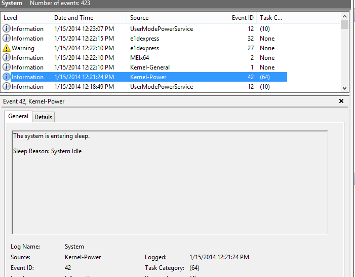

I just applied applied the optional rollup update #2911106
Now I am at least seeing a "kernel-Power" event when the system enters sleep but still no "power-troubleshooter" events

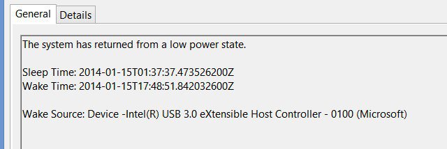

NC, Sooo, your computer sleeps OK and the only trouble is that you don't have the Power troubleshooter? that is for USB 3.0 devices!
I don't think you have to do a complete install for this, especially if you do not have USB 3 ports or use them! I am completely flummoxed why the fascination with system logs, heh. I have these errors all over them and I don't care a wit:
Sleeps OK? At times :confused:. It comes and goes like with everyone else on here. It's been a lot more consistent since I updated my sound driver of all things. At the moment it also doesn't appear to like homegroup much. System sleep is much like a finicky human with a lot of bad mood swings. It's a frustrating moving target at best.
Not sure what you mean power-troubleshooter is for USB 3.0 devices? Do you mean that it won't post to the log when it enters sleep unless the machine has an active USB 3.0 device attached at the time it enters sleep? I actually didn't have any attached so I just plugged one in and its still not making log entries when it enters sleep. So I guess I'm unclear about the USB 3.0 thing?
NC, Yeah, I was confused. You said your computer fell asleep and that you took the snapshot after. I took that to mean that it always slept when it should!
When I expanded the power troubleshooter line in the system logs, it only says that the USB 3.0 port has woken from sleep. My ASUS Z87 Pro has special ports and apps for USB 3 including a charging port, so I doubt that you missing that particular log line means anything.
