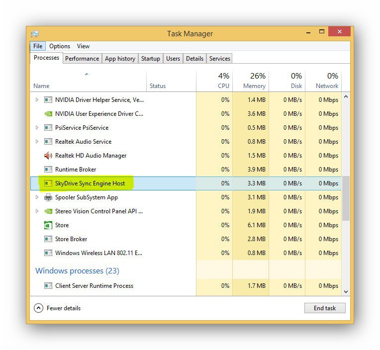

It's the Windows, not the third-party software. The issue is with the SkyDrive app. I have fresh-installed Windows 8.1 three times. I did not update, did not install any third-party software, but still the same problem. I have tried this on 2 PCs, same issue.
I tested another thing. I killed the 'SkyDrive Sync Engine Host' process and after that, the computer was able to go into sleep right at the chosen time. By the way the [FONT=Segoe UI, Arial, sans-serif]HomeGroup is off too[/FONT]
[FONT=Segoe UI, Arial, sans-serif]Just turning off the [/FONT]HomeGroup[FONT=Segoe UI, Arial, sans-serif] didn't solve the issue. You definitely need to kill [/FONT]the 'SkyDrive Sync Engine Host' process.
maliksaad, I firmly believe that there is more than one problem source which is why we can't find the one solution. I don't have the skydrive sync svc going, and no homedrive set up, but I still have the sleep problem.
