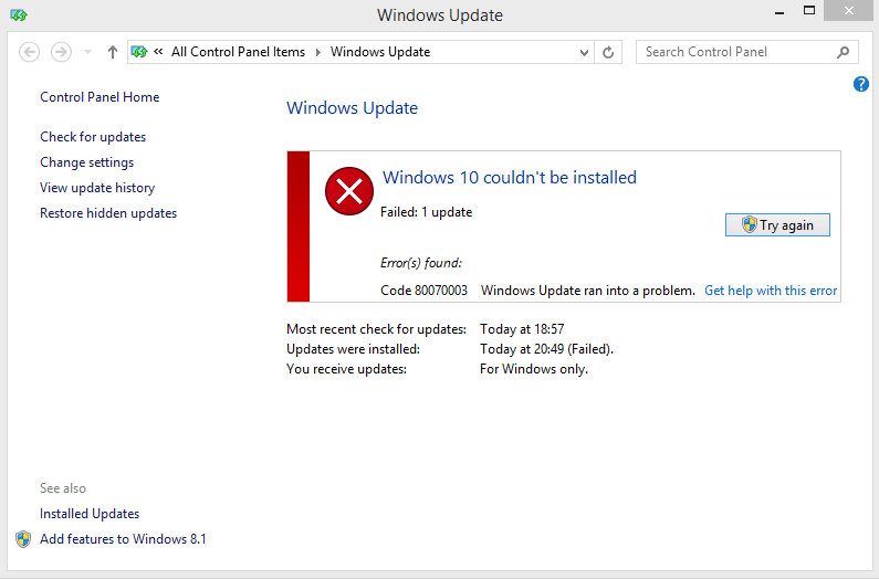

This also fixes Windows Update error 80070003 when upgrading to Windows 10, if you have used EaseUS Partition Master.

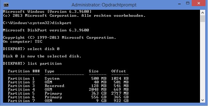

Here is another example of the damaged partition type.
Partition 1 - System (500 MB)
Partition 2 - OEM (40 MB) - Note: This Dell OEM partition type is ok.
Partition 3 - Reserved (128 MB)
Partition 4 - OEM (2048 MB) - This partition type should be Recovery (not OEM).
Partition 5 - Primary (363 GB)
Partition 6 - Primary (556 GB)
Partition 7 - OEM (9 GB) - This partition type should be Recovery (not OEM).

ok. This is exactly the same problem that I helped this gentleman last week. You need to open the Admin Command prompt
  1. Type: diskpart
  2. Type: Select disk 0
  3. Type list partition
And look for the partition with "Recovery" label, Take a note of the size of the partition then follow the instruction from this post:
http://www.eightforums.com/general-support/53334-could-not-find-recovery-environment.html#post425220
You must first change the OEM partition to the Recovery partition.
diskpart
select disk 0
list partition
select partition # Note: Select the first OEM partition: select partition 1
set id=de94bba4-06d1-4d40-a16a-bfd50179d6ac
select partition # Note: Select the second OEM partition: select partition 6
exit

Thank you, thank you, thank you. Everything is working just fine. You made my day, thank you again.
You're welcome.
What did you do? Only these commands and then everything is working just fine?

Yes, you are right. I only added these commands and everything was working just fine...

Your screenshot shows, that your PC was not upgrade to Windows 8.1, but Preinstalled.
There for your Recovery disk('s) will be Windows 8.1.
Theog, you do remember the latest version of the 8 to 8.1 update does not create an additional partition, but puts the tools in the OS partition instead..? This sort of took away the obvious clue the system had been updated.

I did not upgrade from Windows 8 to Windows 8.1, when I bought it, was upgraded already.
Not used the windows Store for months, I use the 8.1.1 disk to upgrade.
