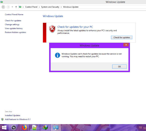

As the title says, my OS is unable to update. I've tried a lot of things.
I've tried Brink's article from Seven Forums to reset Windows Update, I've tried the MS Update Troubleshooter, I've tried an article I found about using GPEdit to change the Windows Update settings.
I'm running out of ideas, and still get the error message: "Windows Update can't check for updates because the service is not running. You may need to restart your PC."

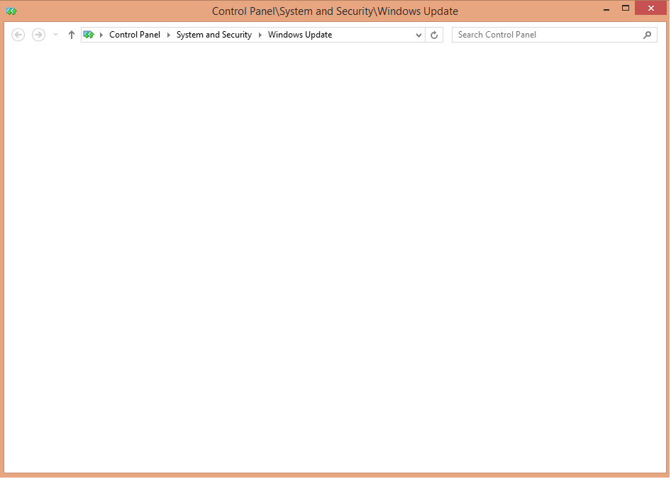

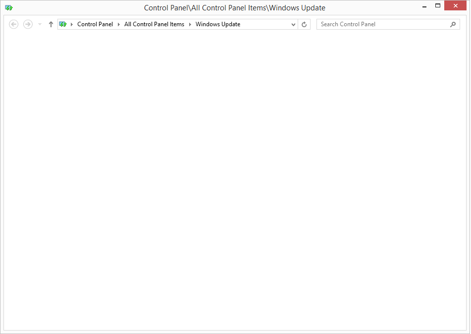

Going into Services, I right-click Windows Update, click properties, set it to Automatic(delayed start) and when I attempt to run Windows Update, it freezes. (as attached)
When I refresh the Services window, Windows Update in Services shows up as disabled again.

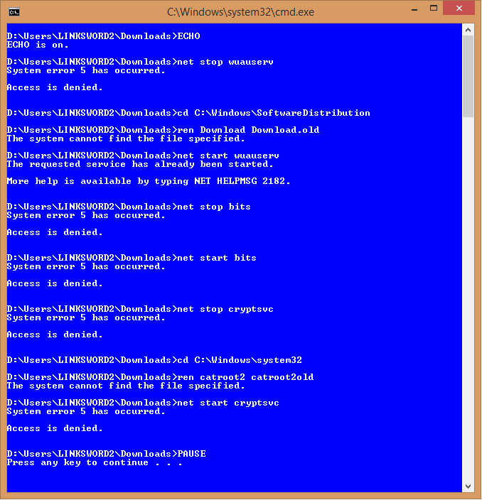

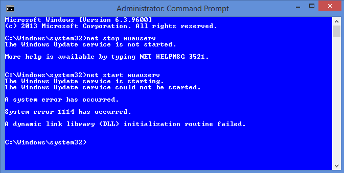

Followed your steps as above, attempted to start Windows Update in services, then attempted to run the commands in this command prompt capture.
(Yes, I like white text on a blue background. Nicely visible, IMO.)
A DLL failure is popping up red flags in my mind.

This DLL error should be fixed ASAP, unfortunately, here is no info about its name. Maybe it can be found in the events, but at the same time it would be reasonable to check the integrity of whole system:
Run CMD.exe as administrator, sfc /scannow
This command will restore any missed or corrupted system files, it will take some time.

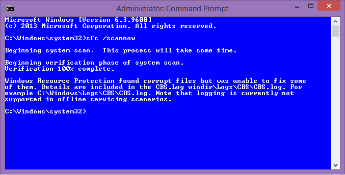

Results attached.
(I'm getting pretty good with Alt+PrintScreen.)
