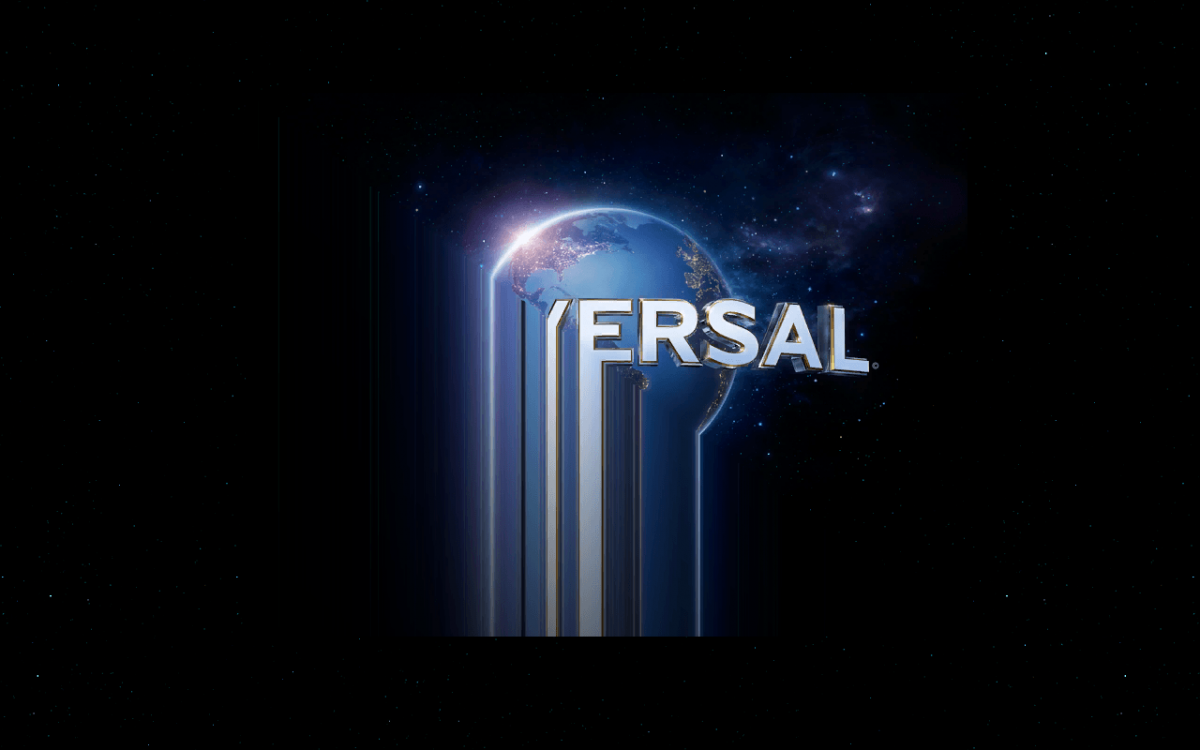

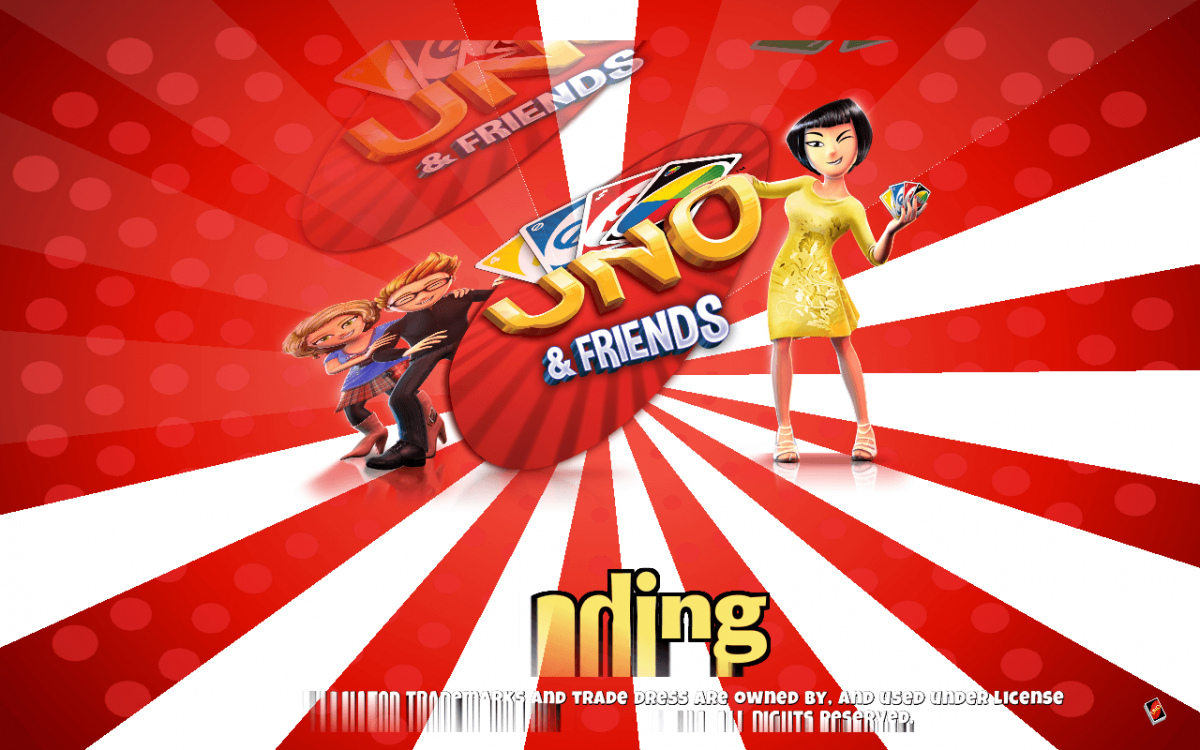

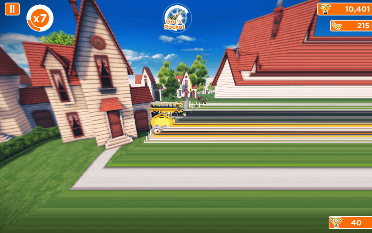

Installed this but still having some problems with graphics. Games are the best example. See attached images. Untitled1.pngUntitled2.pngUntitled3.png
Installed this but still having some problems with graphics. Games are the best example. See attached images.View attachment 34012View attachment 34013View attachment 34014
Hey,
I see you have a really ugly problem there and I'll be honest I dont know what is causing this. In my case, I could even run PPSSPP smoothly with these drivers. Can you please tell me a few things:
What is you PC make/model?
What graphics card do you have?
Did you do a Windows 8.1 fresh install?
Did these games appear same on WDDM Drivers?
Did you install any other driver before these?
Thanks!
Hey,
1) I have Acer Extensa 5630
2) It says I have Mobile Intel® 4 Series Express Chipset Family
3) Yes, installed 8.1 on formatted disk.
4) Yea, it looks the same no matter what I try to install.
5) No, before yours I had the default WDDM 1.1 driver.
Thanks, but these drivers still doesn't solve the glitches. What's interesting is, when I uninstalled all the drivers, with the windows Basic Display Adapter (no driver) the graphics were fine, but, of course, unbearably laggy.
Newer driver https://downloadcenter.intel.com/Detail_Desc.aspx?agr=Y&DwnldID=18402 and for 32-bit https://downloadcenter.intel.com/Detail_Desc.aspx?agr=Y&DwnldID=18400. These drivers are the last ones that may be installed on Windows 8/8.1 without having to disable driver signature enforcement or installing custom certificates. Just run the Setup.exe and you are good to go!
Yes these drivers are indeed newer but in my case I got an error in the installation and after searching, I found out many others were getting the same error.
