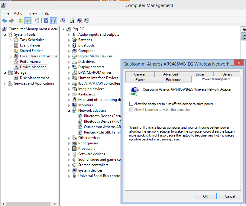

You might want to try a System Restore , restore it to a point before you've encountered the issue.
If System Restore didn't work, try disabling the Power Management of your Wi-Fi adapter in Device Manager, see attached image.
System Restore takes forever, rebooting works for me and is much quicker. I'm using wi-fi as a possible work-around but its too early to say if doesn't have the same problem.
The installation of 8.1 nuked my system restore options. Also, the issue isn't with the wireless going to sleep, but the Ethernet card dropping a wired connection. I did go ahead and verify that neither connection is affected by Power Management as shown in your screenshot.
