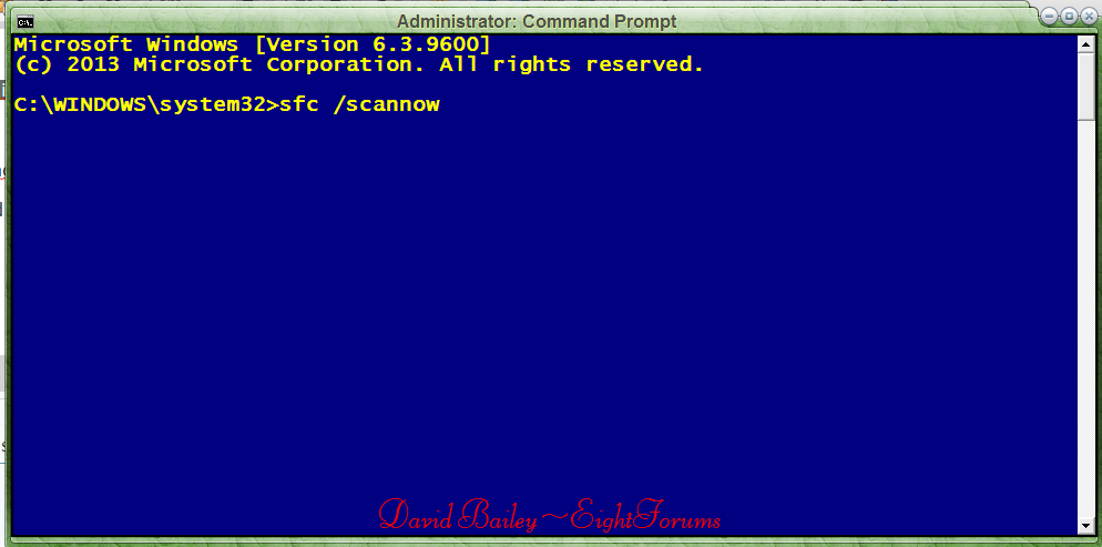

sfc /scannow needs to be run in an administrator command prompt.

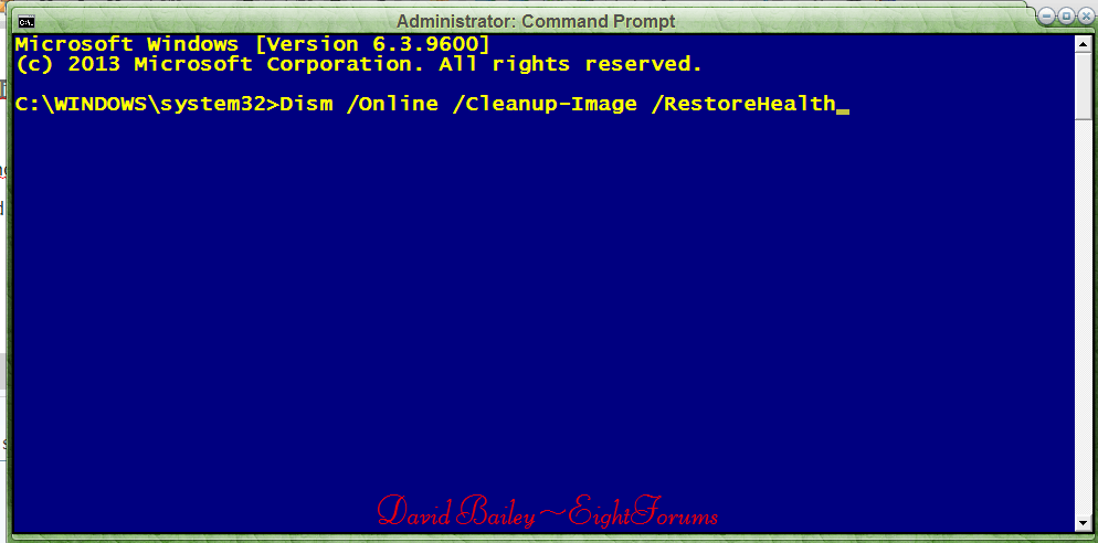

DISM too.
