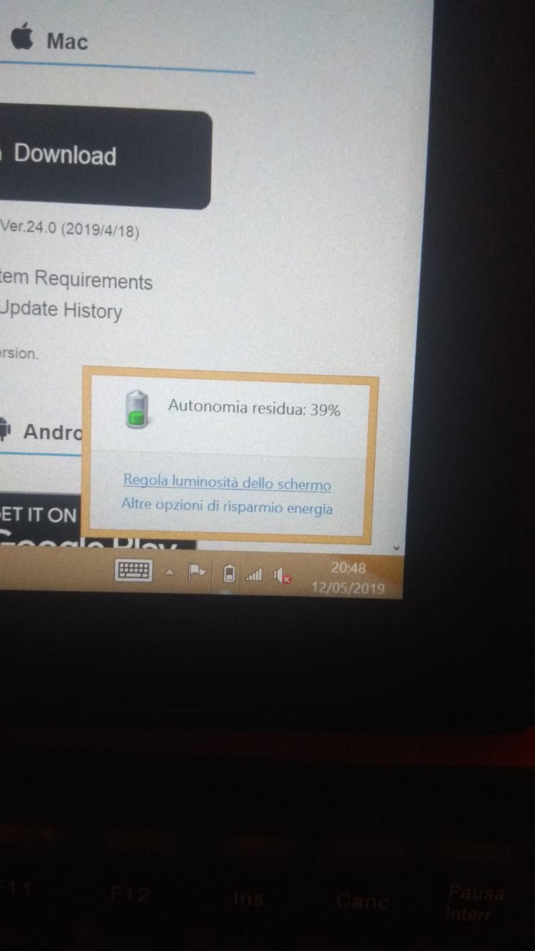

The tablet works at 100% now but I have this 2 annoying problems:
1) Battery seeems to last less and I can't chose a power plan when clicking the battery icon. :( Which driver can cause this?
2) The screen brightness increases and decreases indipendently without a reason. I disabled the "adaptive brightness" option when configuring the default power plan (I can't create new ones) but nothing has changed! :(
Again, which driver can cause this? (I believe this problem was generated by the wrong drivers installed by DriverBooster, as I said I removed them all using a restore point but the bug is still present....)
