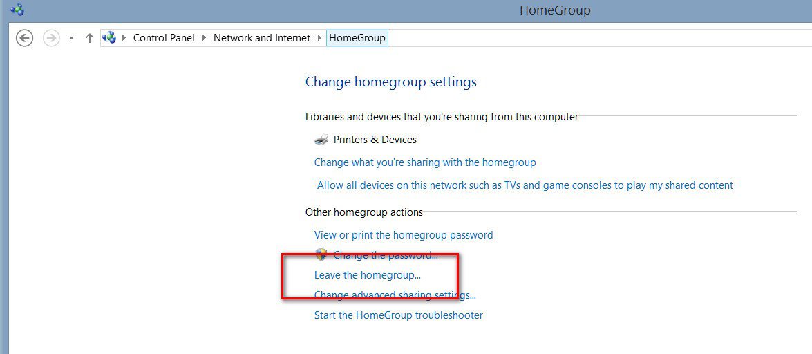

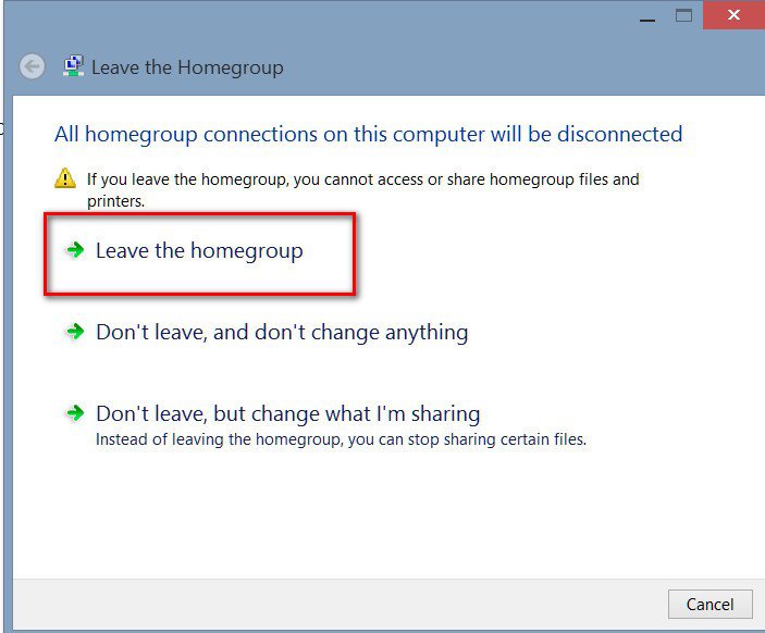

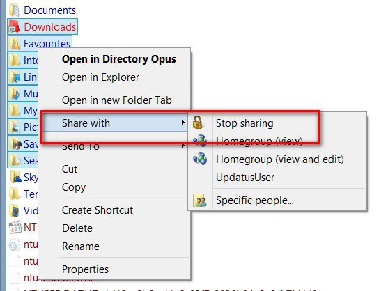

Let me see if I can convince Brink for me to do a tutorial. In the meantime:
1. Have all computers on the network leave the homegroup.

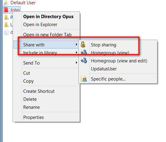

2. Unshare all of the flies/folders on the computer. This can be sped up by selecting multiple folders at once.
3. Create a new HOMEGROUP on the main computer with a new password. Share the folders you want to.
4. Have all the other computers join that HOMEGROUP and share what files/folders you want to have shared. ALL THE COMPUTERS HAVE TO BE ON AND RUNNING!

I appreciate your efforts, however even though I leave the homegroup on my two computers (main one Win 8.1, second one Win 7), unshare everything (computer management only shows IPC$ as the only share after I am done, and of which I cannot get rid of), then start a new homegroup on the main computer, change the password to something easy, let the 2nd computer join the homegroup by typing that password, afterwards, the main computer will not sleep again by itself. I have tried this several times in vain now.
Maybe the difference to you is that I have a Synology NAS in my LAN? It's not part of the homegroup, but it has also shares. However, unsharing all there is a bit messy to be honest and if this is the only way to solve the issue then I would rather live without the homegroup (or ipv6, if there is a choice?) and wait until Microsoft issues a patch. Shame on them they go 1 step forward and 2 backwards with their 8.1 release.

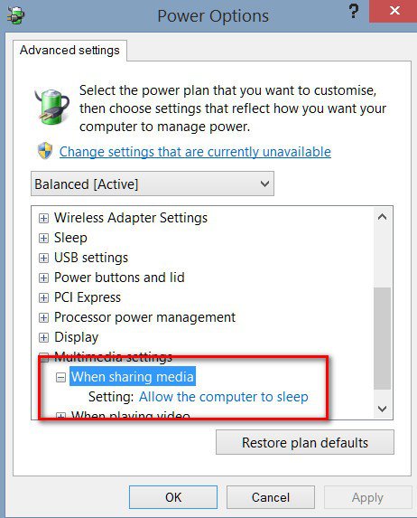

UPDATE: I have had a slight improvement by allowing the main computer to sleep when it is sharing media (under energy options). I did not think this should be relevant as the main computer has never been actively sharing content at any time during my tests (for example like streaming a movie, or being browsed by the other computer). Yet, I could live with that setting if it resolved the issue at hand.
Now, it can go to sleep now and then with this option turned on, but I have observed several times that it then suddenly wakes up again while in standby. Hence, this is not a satisfying solution for me.

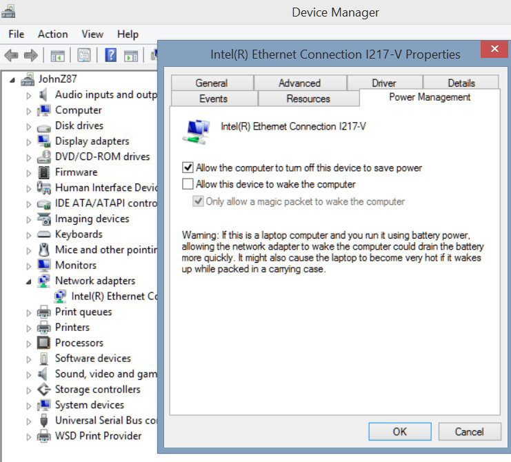

for instance, go to device manager, right click of the network adapter properties, and turn off allow this device to wake computer under power management.
At least you are making progress!

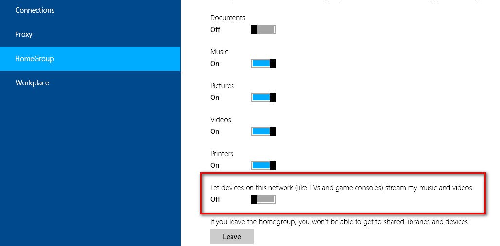

Steve, as Rockhound and I have found, this is a handsome frog of a problem. It took me days of working on it to get everyone to sleep and stay that way. Rockhound was also frustrated.
Since HOMEGROUP defaults to Media sharing (which will wake your computer just because it is enabled), you will have to go around and disable it in both desktop advanced power settings and the Start Menu PC settings on all the other machines too. Note that you can still run and share your media, it just will not automatically wake up your computer to do so.
Both settings are already how you suggest.

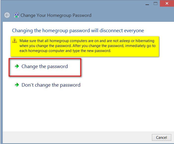

OK, I turned on all the other machines, changed the HOMEGROUP password on all three machines, and waited 5 minutes longer than I was expecting, but my computer now sleeps. I think the trick is to:
Make sure that all the machines on the homegroup are online before making any changes to the HOMEGROUP, joining, sharing, changing passwords (and if you change passwords go around and immediately change the passwords on the other computers- don't wait).
Change your sleep to 1 minute and wait and wait and wait until it FINALLY falls asleep (like 4 pages of the newspaper wait). So far, this has worked on all three machines. If it is still working tomorrow is another question!
