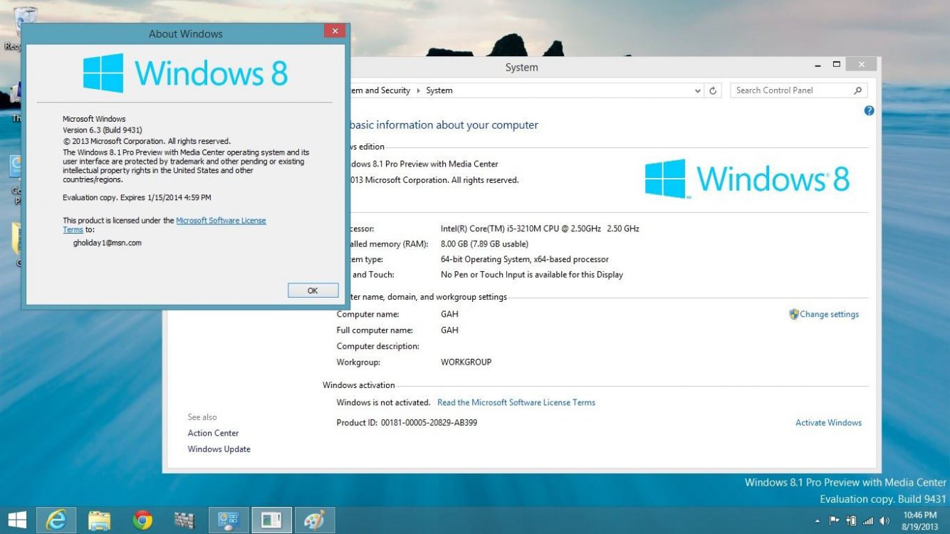

Hi Gang:
Man this is quite a frustrating experience...I had Windows 8 Pro with Media Center installed on my Asus K55A laptop and it was 'activated'....no problems! So I decided to install the 8.1 Preview via the Windows Store...installation went fine. However when exploring, I noticed that it was not activated: So I entered in the the product key for my Windows 8 pro information....even purchased a Windows 8 Pro media DVD....have a copy of the email with the purchase price...bla, bla.....

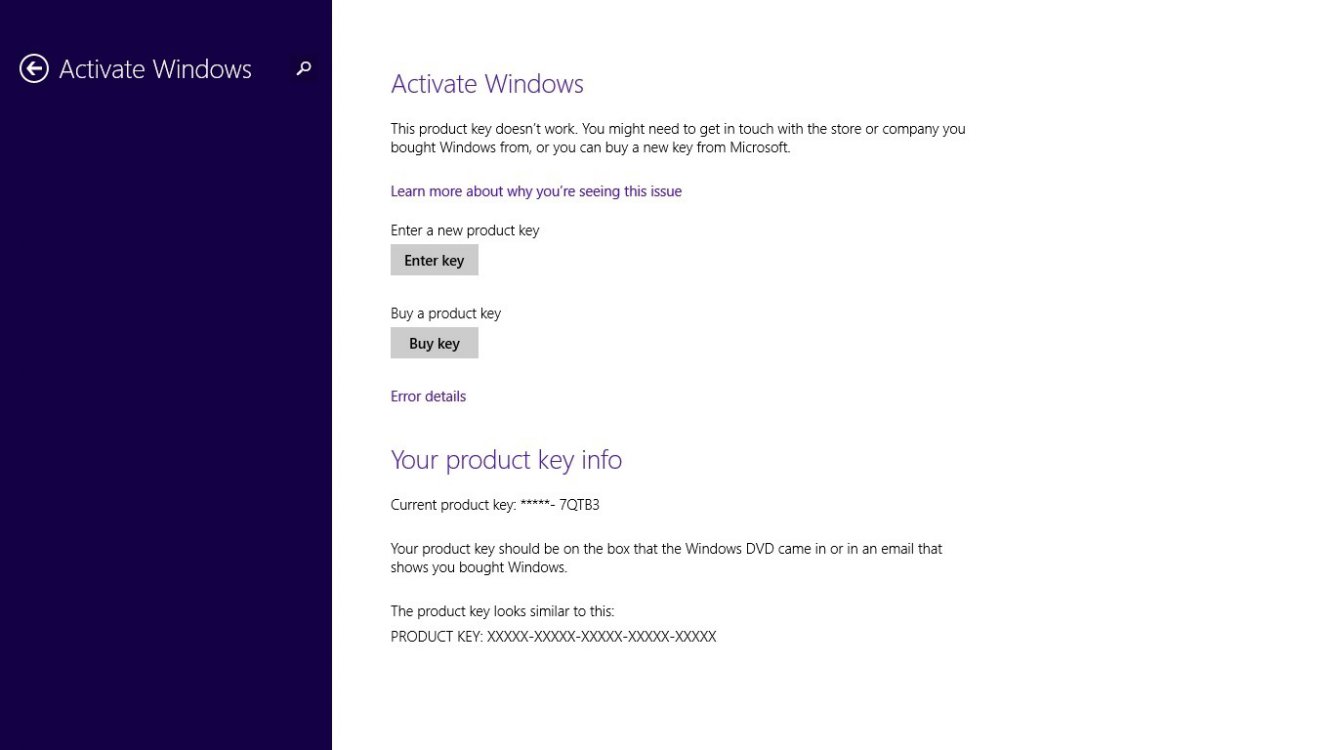

So I enter in the Product Key that worked successfully with Windows 8 Pro: Received this nice message...lol
Error Code: 0xC004C003
Error Description: The Activation server determined the specified product key has been blocked
A note that also stated, You need to enter in the product key on the back of Windows 8 box, or the product key that came in the email that you received when you purchased the DVD....I have a copy of the email that I received with the purchased Windows 8 DVD.....there is NO product key listed at all!
Now I can not even attempt to customize Windows 8.1 preview, because it is not activated.....
I am quite frustrated to say the least, and even attempted to install (clean) back to Windows 8 Pro with my purchased DVD....when I entered the same product key that was successful (only 3-4 days) ago....the installation process stalled!
So I stuck in a Windows 7 disc.....and at least the system rebooted back into Windows 8.1 Preview....but still no dam activation...I guess my only alternative is to contact Microsoft support...
If you'll have any suggestions.....would be greatly appreciated!
Hell my Windows 8 Pro with Media Center was running beautifully and was fully activated only 2 hrs ago...
Here is a pic:
Thanks..

This error indicates that the Key is blocked from activation.
Usually, it indicates that the Key is an OEM_SLP one operating on a retail install - and I suspect that this is the case here.
How did you install the Preview? - using what media?
There's also the possibility that it simply needs telephone activation.
telephone activation (operator calls)
Click on the Start button
in the Search box, type
SLUI 4
and hit the Enter key
follow the instructions, but when asked which service you require by the telephone ansafone, do NOT reply - this should force an operator to respond, who can deal with you

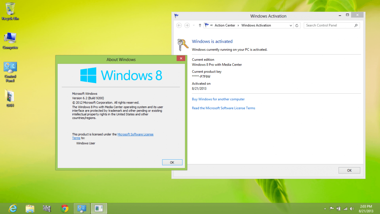

The activation issue was next...what I found out through MS Level 2 support (she was thrilled that I had successfully installed the Win 8 Pro installation....as the notes in the Case File were rather long....LOL I had a Win 8 Pro Product Key....and also a separate Media Center Key...(remember this worked successfully for me before...) I would first install Win 8 Pro, then proceed to Add Features to Windows 8...through the Microsoft store with the Media Center key.....I never had an issue.....however apparently the Activation Servers.....now are highly tweaked....and they picked up my Media Center key as thinking it was the Win 8 Pro key....thus all the activation errors....
Bottom line after 2-3 days of mild frustration........hrs of time...........it was worth it....a new Product Key and absolutely not 1 penny out of my pocket...lol Now I'm ready for 8.1 RTM on Oct. 17th.:cool:
I'm a happy camper, thanks m8! ;)
