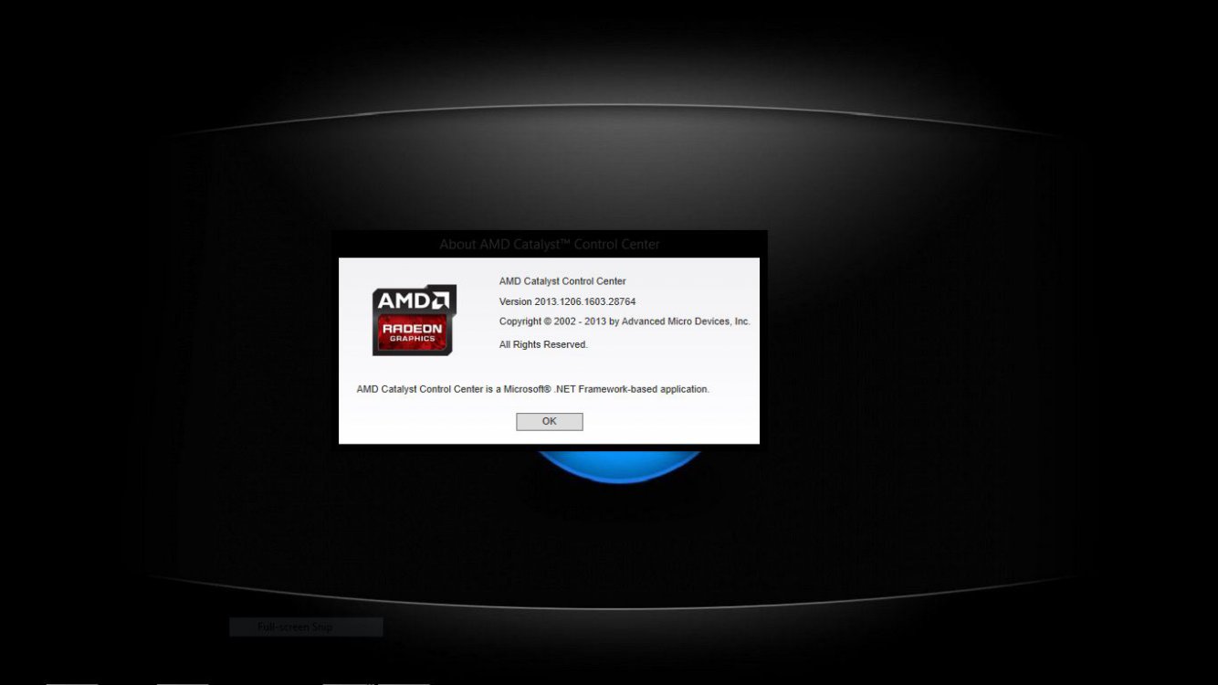

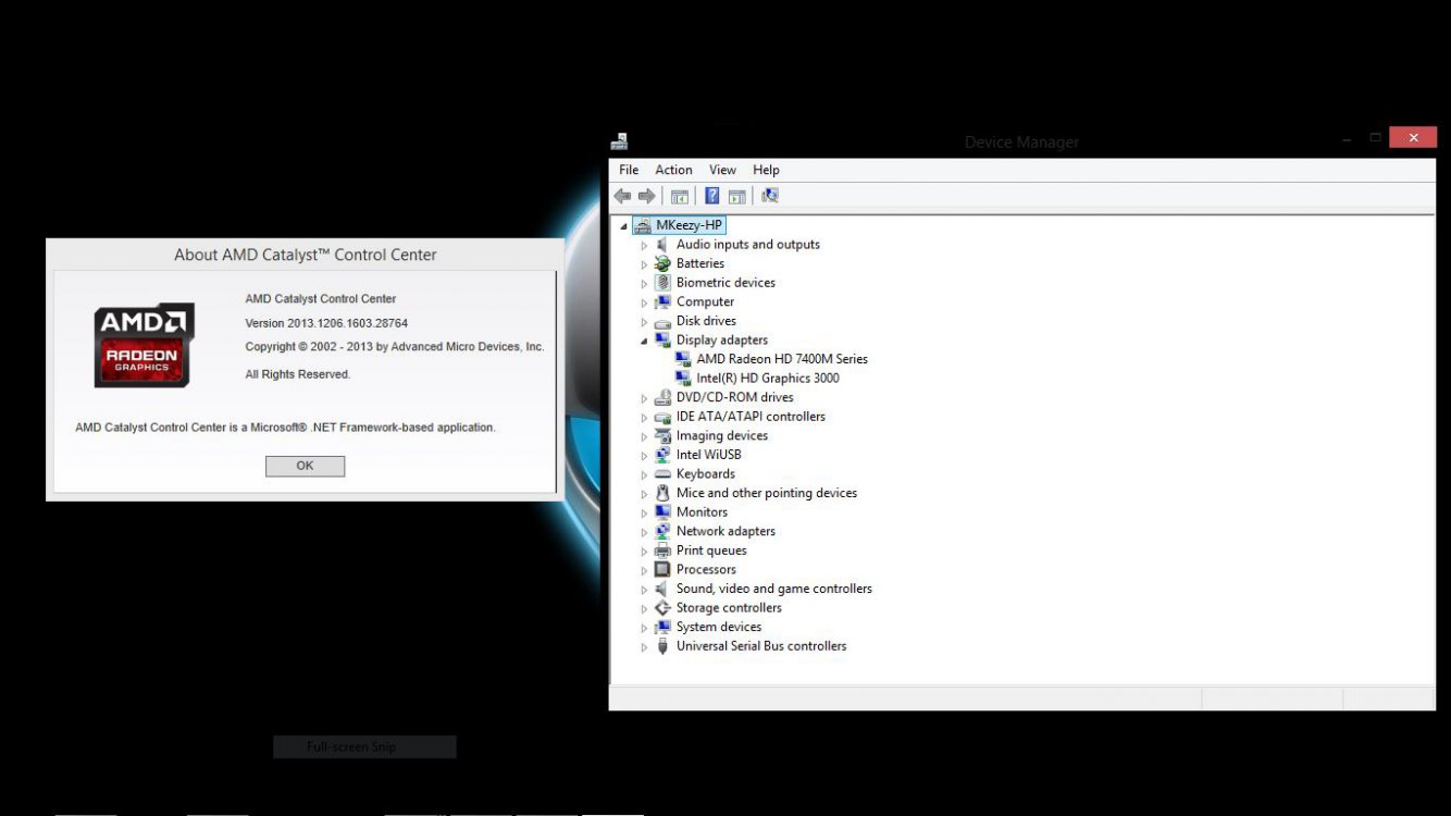

OK, just installed the "mobile" 13.12 and again OVER the already installed beta 13.11.9.5, all went as usual. all is in working order as before. So I'm now pretty much convinced these non OEM drivers are now installable, and am able to continue to do so, this is the 3rd one of these I have installed starting with 13.11.9.4 along with the Intel driver 3347 and so far no major problems.Everything is fine, only thing as I mentioned before was that the system now see's my HP OEM 7690m xt as some 6700 Series, which I said I was aware of anyway as its just a 6770m at its core, so nothing performance wish changed. its no issue to me what the damned card is seen as, its still AMD. With this 3rd install though I at least stopped complaining about it lololol.
I did find that leaving my COMODO AV on when installing these the AMD driver it somehow catches something and stops the completion process and the screen goes black on me, I had this the last time and couldn't figure what was the deal, I re booted using the on/off button as I couldn't see the damned screen, at re boot, things were OK, except I didn't have the CCC installed, and both monitors were on, laptop and external, the monitor issue was fixed by re setting the show only on 1 monitor, the CCC I had to re run the AMD setup again, but this time I closed my COMODO AV, and was able to see the popup system boxes that were installing in the back ground, all went OK and I have CCC back.

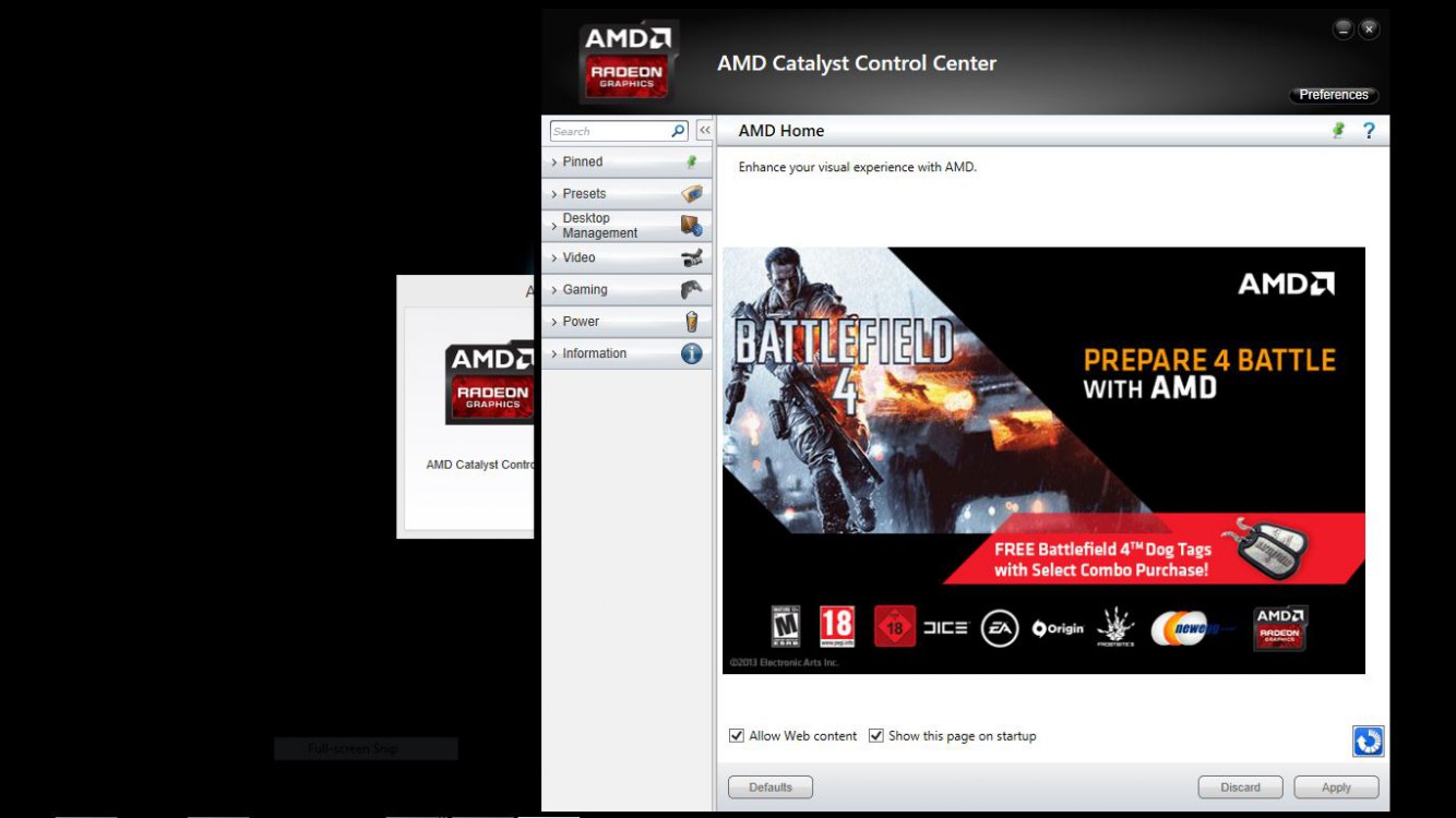

I could post the same CCC screen shot but its no different than the one I posted before with 13.11.9.5, it shows the updated driver in the info section, and the switchable graphics page when on "Fixed" mode. I reverted back to fixed from dynamic cause I got tired of setting the different cards for the different programs, this way I know the Radeon is being used all the time unless I go off plug and on battery. Only thing that's a pain is some of my own made screen savers don't like the Radeon card, and won't work unless I have the Intel 3000 set , oh well can't have everything , smirks.
btw I had the system set to "Fixed" when I installed this 13.12 over the installed drivers, some seem to say to use dynamic, some say fixed, I don't think it makes much differance as some don't have that option anyway. Main thing is in my case I DID NOT clean anything, I installed the first 13.11.9.4 over my installed OEM HP SP59850 driver, and have installed each update right over the others with no problems., just in case your interested, as all I read is all this "clean install" stuff.
installed OVER my existing driver
installed in FIXED mode
had to close my AV to get CCC installed
Radeon 7690m xt (6770m) (13.12 final)
Intel 3000 (3347)

Hi, thank you for the wonderful help you people made at this thread.
I just updated to 8.1 from 7
I'm on HP g6-1240se (HD 7400M series)
I installed all drivers in the HP support for my model. then i ran on the switchable graphics problem
My ccc menu should be similar to this
I followed
MKeezy's instructions of downloading/updating through update center.
This is my current CCC menu.
Is there something wrong here?
also when i click on configure switchable graphics via right clicking the desktop i only get this. compare to before in W7
Thank you for the help
    Windows 8.1 Pro
Assuming I'm looking a screenshots of your system's actual Catalyst Control Center's graphics properties splash screen, It appears to be functioning properly. However, there is one item displayed of concern to me depicted in the capture image. The tab labeled "Power" on the left should contain multiple options, such as; Switchable Graphics Global Settings, Switchable Graphics Application Settings, Switchable, and Graphics Application Monitoring.
On the other hand, it appears that your graphics are already set to and running in the Switchable Graphics Application Settings Mode. I can tell this by the information displayed in the above first screenshot capture image you posted. It shows that you have configured some questionable items (applications) to run using your discrete graphics GPU. Applications like Notepad, Task Manager, and Command Prompt should not be configured so. In fact, they should not be set at all. You only need to configure settings for applications that require dedicated graphics that are more powerful than that your dedicated Intel GPU can provide (i.e., video games, Photoshop, CAD, video editing software, etc...). Those applications should be set or configured to use High Performance Mode. That will ensure they will run using your AMD GPU.
Bear in mind, some software is only made to run using your Intel GPU. Those application must be set or configured to run using power saving mode ONLY! Your Intel graphics can handle pretty much any app the average person might run, including many simple games like, Angry Birds and such. Your more complicated video games would require using your AMD GPU. Everything else should remain unset, which by default would use the Intel GPU or configured to run on Power Saving Mode.
Check and make sure that you have your switchable graphics feature set to Dynamic Mode in you system's BIOS Setup Utility. I hope this information helps.

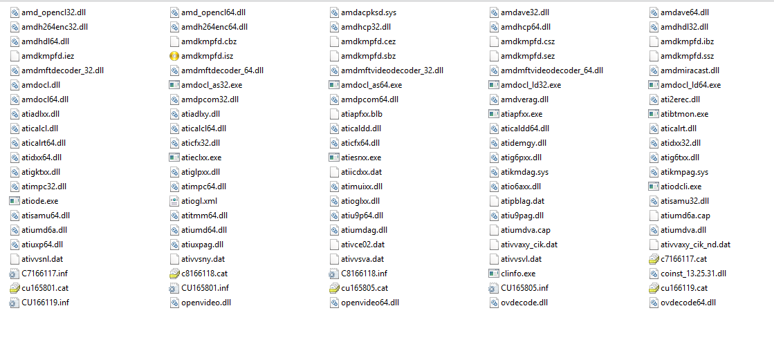

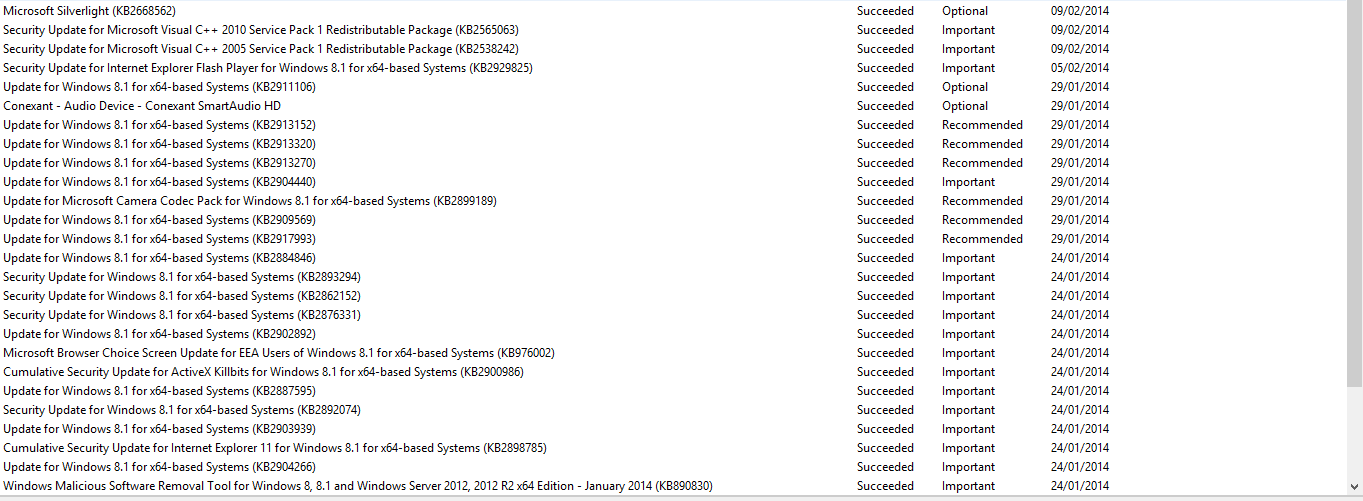

Hello,
I have a brand new Lenovo G510, with switchable graphics AMD Radeon HD8570M/Intel HD Graphics 4600. My OS is Windows 8.1 (it was already installed on my laptop when I bought it). I realized that I am having problems with my graphics cards (crashes while playing games or working with Blender, occasional BSOD with errors pointing to AMD drivers, really bad performance on Unigine Benchmark etc.). I arrived here while browsing around to find a solution, however I am not sure I understand how to solve my issues with the Microsoft package (which so far seems to be the only thing that can possibly work).
I tried checking for updated drivers in devmgmt.msc, and it says my drivers are up to date. If I run Windows Update it says that I have no updates to apply, but if I check the already installed updates I can't see anything with "Advanced Micro Devices, Inc. - Graphics Adapter WDDM1.3 " in its name. So I tried going on the Microsoft Update Catalog website, and I looked for 8750m. I was in fact able to find some update packages, and I downloaded the biggest and most recent named
Advanced Micro Devices, Inc. - Graphics Adapter WDDM1.1, Graphics Adapter WDDM1.2, Graphics Adapter WDDM1.3 - AMD Radeon HD 8570M " .
However, all I get is a .cab folder. I can open or extract it, but I have no idea of what to do next, since there is no file named ccc2.exe or even anything with a similar name.
I am attaching a picture of the folder content:
I am also posting a screenshot of my installed updates (I had to take a couple to capture all of them)
I would really appreciate any help to solve this issue, I tried asking for help on the Lenovo forum but received no answer and I am getting really frustrated :/ .

Re: Kalenz
Hello,
View attachment 37006View attachment 37006
Hello Kalenz,
Among all the items you seem to have installed on your system, I don’t see any mention of AMD/ Intel Switchable Graphics. Can you provide us with more information about exactly what AMD/Intel devices you have installed? Info like driver versions would be helpful.
By the way, if your system actually has an AMD/Intel hardware configuration. You would only be interested in the WDDM1.3 update package which is the most current Microsoft provides for that particular hardware setup.
Last Modified: 12/9/2013
You said, your device manager shows that your display hardware is current and up-to-date as it is. Can you tell me if either of your two display adapter names has been changed? For instance, my original adapter name was AMD Radeon HD 64900M, which was changed by Microsoft in my device manager to 7400M series. Therefore, the Microsoft update for the device was not based on my display adapter’s original name but rather the new name to which it was changed.
Can you tell me the original series number for your display adapters? I have to assume that 8570M is the original series number. I’m not familiar with that series being part of the switchable graphics family.

And here are my drivers:

Yes, I believe it is the one I downloaded. I am just puzzled about how to apply it.

Regarding the link you provided, I had seen it previously and downloaded the .exe update they provided, but when I try to run it it gets blocked by Windows Smart Screen. I could allow it to run anyway, but I decided instead to play it safer and post questions here. If you or somebody else can confirm that it's legit and safe I can try to run it and see how it goes though.
I had also tried to apply this procedure:
1. Unzip the file to a designated location or folder.
2. Click Start.
3. Right-click Computer > Manage. When prompted for permission from User Account Control, click Yes.
4. Select Device Manager from the navigation tab on the left.
5. Double-click Display Adapters.
6. Right-click the AMD Graphics Controller and click Update Driver Software.
8. Click Browse my computer for driver software.
9. Click Browse and select the directory where the driver files are located.
10. Click Next. Drivers are now being installed.
11. Reboot computer when prompted.
to install the drivers I got from the WDDM1.3 update package, however after step 9 instead of installing the drivers it says that my drivers are already updated and stops.
I believe this is all, please let me know if I missed something, and thanks again for your help. I consider myself tech savvy, but drivers and hardware issues give me a headache x) .
View attachment 37020View attachment 37021
