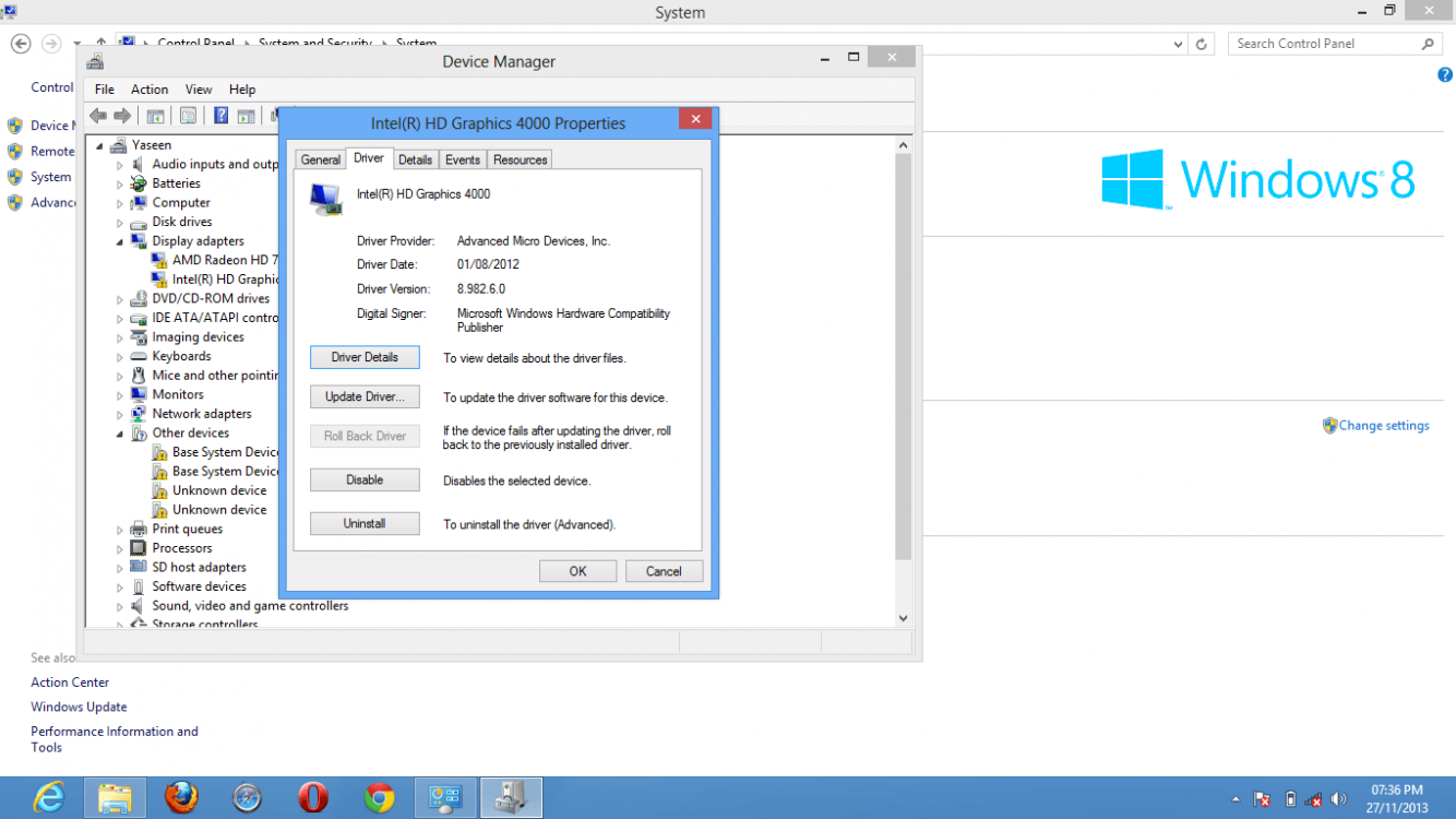

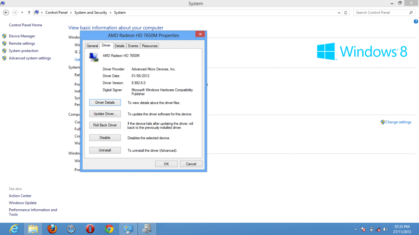

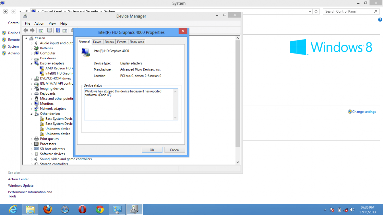

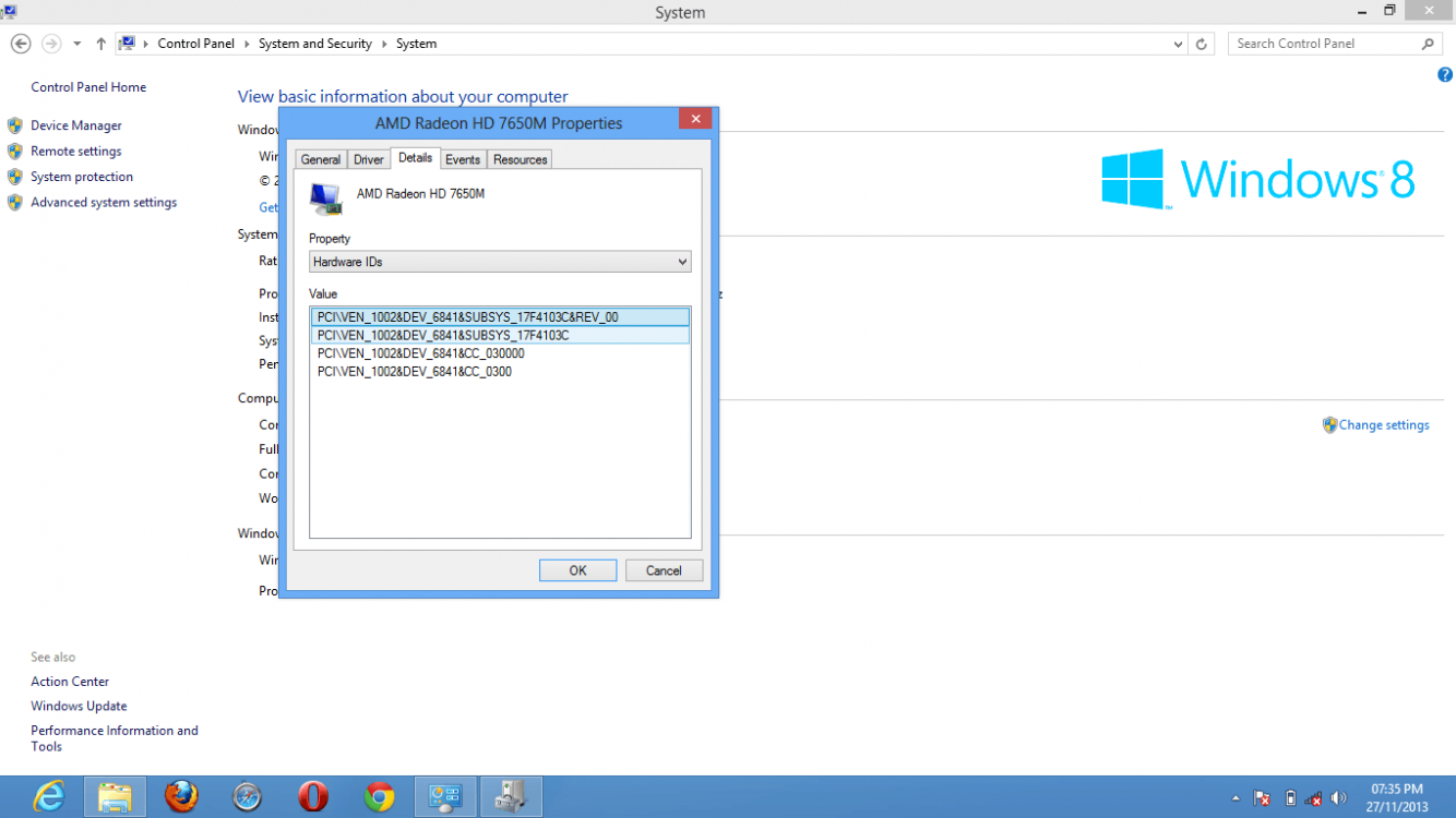

mdnizar95
1
India

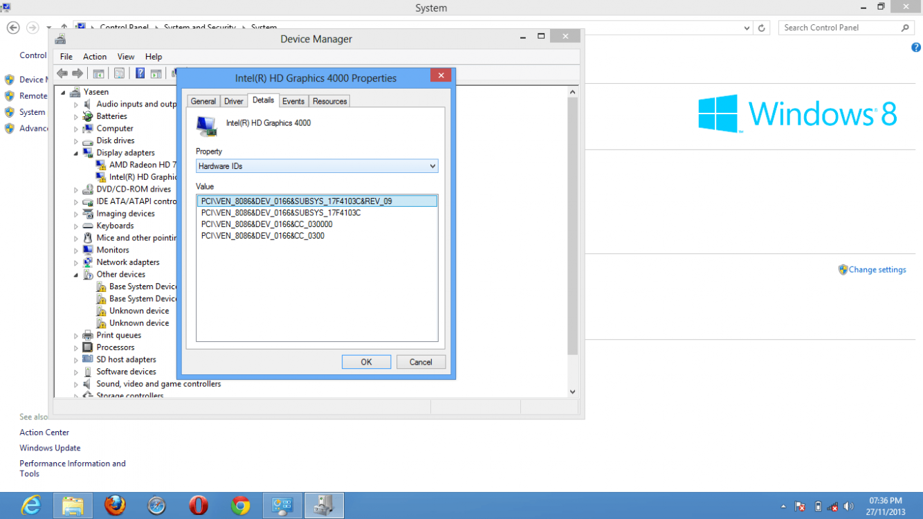

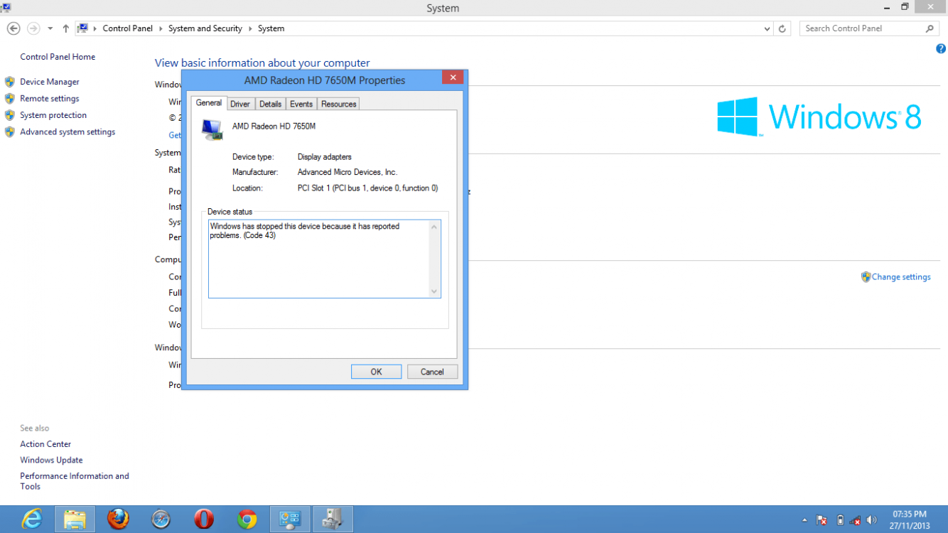

Hey i have HP Probook 4540s with me..It has got Intel HD Graphics 4000 and AMD Radeon 7650M...two days back i installed a game.. Obviously the game freezed...and what followed was a tragic thing....suddenly others games started to run very slow...and i happened to see the device manager. It gave code 43 error for both my graphics cards. I restored my system to other restore point. still nothing happened...please i want a solution for this...someone pls help me....:(
Also before that....when i installed that game..it dint work.i googled and found that i had to type a code in cmd...that was " bcedit/Increaseuserva 3072 "....does it have something to do with this or is here any other problem....and another note...when i right click in desktop before this problem, i used to get two options
i) Catalyst control center
ii) something like adjustable graphics card options...(it has got something to do with the switchable graphics...)
Now after this problem , am not getting the second option....and when i click the first option it says " Catalyst control center cannot be started. There are currently no settings that can be configured using catalyst control center."
With this am posting screenshots of code 43 error display in the device manager....

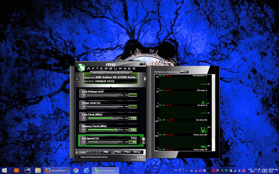

MSI clock
OK well let me start by saying I have, (HAD) this "7690m xt" and Intel 3000.
Had time today and decided to image my drive just in case, before I started to dig into this driver stuff myself., decided to go the route that the Sony kid did, just install the drivers "WITH OUT" removing anything, in other words I left my OEM sp59850 driver alone.
I installed the Intel driver, did the reboot thing, and of course had the black screen at first, but after a min it configured itself and I was up, I than installed the AMD beta 13.11.9.4 (again OVER the one installed) it gave me some sort of error message box, I clicked OK, and waited, it took a couple sec but than continued to install, I re booted as it wanted and was up and running. No BOSD's at all, no error messages so far, put it to sleep and woke it up, no problem, I ran through most of what I use and a few "normal" games, I really see no difference, but hy the damned drivers are updated, smirks.
BTW I DID NOT go through all this mess of setting a damned thing in the boot edit or anything else I just installed the damned driver AS IS, OVER my HP installed driver, AS IS.
So I have NO idea what it did or how its working, but so far I have no problems, its running as well as before, I can not use the laptop keyboard brightness controls ie f2 for lower and f3 for higher brightness, but that wasn't working with sp59850 HP driver either. I have the Intel graphics control panel in my task bar I can use to set that if needed. I also opened the CCC, to see what changed, nothing changed, all settings are there as before, BTW I see no brightness control there either anyway.
My system is set to "FIXED" I never changed that, and it uses ONLY the Radeon card while "plugged in", ONLY if I go to "battery" does it switch to Intel. It was set this way before installing the drivers, and is working as usual after installing them.
Only difference I see is in device manager, the system now see's this 7690m xt as a 6700 series, CPUID see's it as the 6770m, which is what it is at its core anyway I knew that, its HP's BS. The specs are still the same, no changes to the MHz. It doesn't make any difference to me what the hell its listed as, as long as the drivers are "updateable" from now on, even though its going to be a 2 step process now.
Sooo looks like this system of installing these "non OEM" drivers will work after all, but as I said I DID NOT UN INSTALL anything, I just installed right over my HP driver (sp59850) the last driver for W8, maybe there's something in the OEM driver package code that remains in tact, I don't know and removing ALL removes that part too so the new drivers don't work right, just a theory is all.
Just take note that I did this on MY Windows 8.1 Pro x64 system, NOT W7, so I don't know if this way would work on W7 or not, you could do a image backup and try it.
Don't know if all that helps , but just wanted to add my experience for what ever its worth. I don't know if I need to change my profile from the 7690m xt now to the 6770m or not lolol.
It can also be OC'd with MSI, as U see it shows the card as 6700 series now, not the 7690m xt, but all settings and specs remain the same.

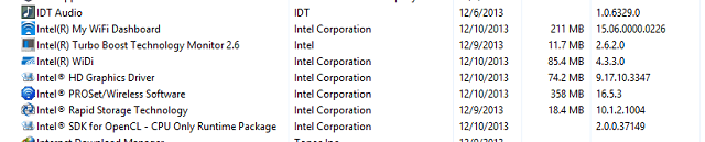

MKeezy
108
To Update or Not To Update...?
HP Pavilion dv6t – 6100 CTO series Notebook PC LM328AV#ABA
Windows 8.1 Pro with Media Center © 2013 Microsoft Corporation All right reserved
Version: 6.3.9600 Build 9600.16408
Bios Version/Date: Hewlett-Packard F.1B, 10/5/2011
Bios Mode: Legacy
Processor: Intel® Core(TM) I7-2720QM CPU © 2.20GHz
Installed memory (RAM) 8.00 GB
System type: 64-bir Operating System, x64-based processor
AMD Radeon HD 6490M Series, running AMD Radeon HD 7400M Series
Driver Version: from (9.0.0.) to 9.12.8.0) 2/11/2013
Intel® HD Graphics 3000
Driver Version: (9.17.10.3347) 10/31/2013
Catalyst Control Center v2012.0815.2143.37180 (Not Working)
Intel® WiDi Version: 4.3.3.0

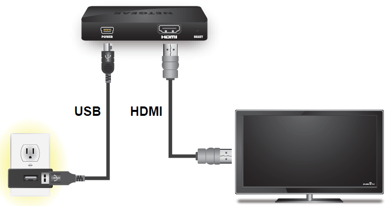

Current Push2TV Adapter: Netgear P2TV 2000 (Will NOT work beyond Intel WiDi update 3.0.1.13)

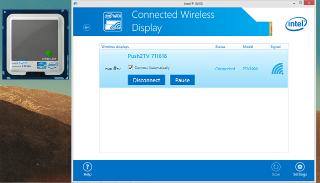

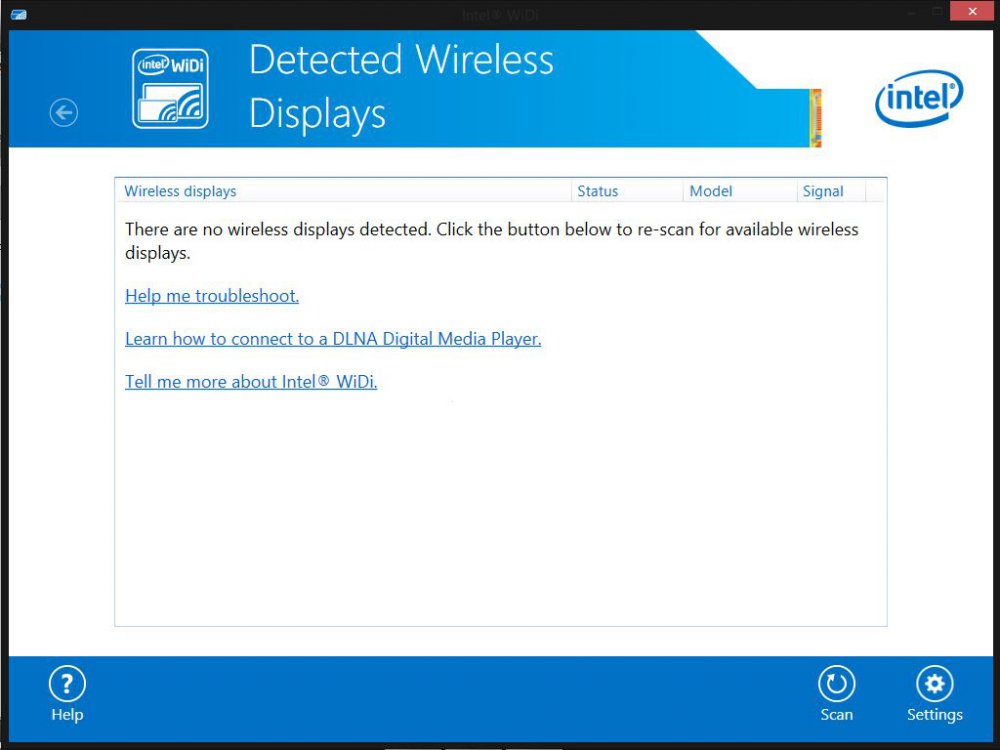

My current system’s configuration works flawlessly with older versions of both the HP provided AMD & Intel Driver Package sets such as, AMD High-Definition (HD) Graphics Driver_sp59147 or AMD High-Definition (HD) Graphics Driver_sp59850. The above mentioned HP provided driver packages each work great on my system under both a Windows 8 and Windows 8.1 (OS) Operating System environment.
However, I recently decided to update my Intel Wireless Display (WiDi) driver in order to make it compatible with the new Netgear Push2TV 3000 adapter I recently purchased. I had been using an older model of the Netgear adapter while using WiDi. But I could not update my graphics driver or even wireless network drivers beyond that point to ensure my WiDi would continuing working.
Any real gaming on this system was never really a consideration for me from the time I purchased this system. However, I would like to take full advantage of every feature it had at the time I purchased it, regardless of whether I update the OS. I can neither use WiDi nor even play a simply Angry Birds Rio game right now. The Intel graphics is the only one of the two GPU’s available to me right now. The AMD Catalyst Control Center is installed, but not working. I have no way of controlling the two currently installed GPU's in order for them to work in tandem as they should. As you know, HP never intended for my particular Laptop to be supported beyond Windows 7, so I’m limited as to what I can do.
I’ve tried many different system configurations using mostly HP drivers for similarly configured systems to mine that were pre-configured to run Windows 8. The problem is, I’m now running Windows 8.1 and Intel continually releases new update for their WiDi feature in seemingly rapid succession. Each new release seems to require the latest Graphics drivers to be installed.
I ‘m cool with not having switchable graphics enable on my system, but I would like to be able to enable it when I need it.
Is there anyone out there who has managed to find an HP AMD graphics driver package that contains the latest Intel graphics driver v.16? I’d be willing to even try a Leschcat solution, but not at the expense of my 8.5 hour battery life (both the 6 and 9 cell) or the cool sense thermal and noise control. A clean install also isn’t an option for me. It is way too much work trying to find the most current and correct drivers for everything.
Can anyone help me find a reasonable solution?

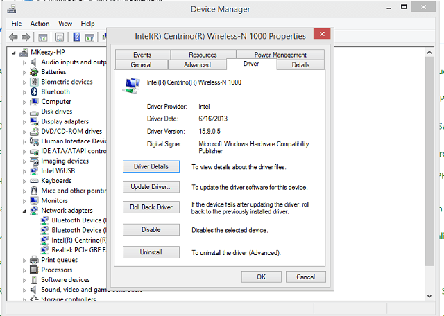

MKeezy
108
Hello Hoody,
It's been a while! My thanks to you for responding, but I actually found a fix just after I posted. I rightly decided to go with Alpha's post suggestion. I uninstalled all my previous graphics drivers (using Treezy's "Driver Fusion Pro) and did a clean install of HP's AMD graphics driver package sp59850.
Then, once installed, I updated both the Intel & AMD drivers of the HP driver package using the AMD's AMD_Catalyst_13.2_Beta7 package. I did a custom install over the HP's sp59850 driver package, optioning not to update the Catalyst Control Center from the sp59850 driver package by HP.
My switchable Graphics work just like it did straight from the box. So I now have both the latest AMD Radeon HD 7400M Series driver, which, ironically, is the same driver that Windows Update service kept replacing the AMD Radeon HD 6490M driver that is contained in the previously installed sp59850 package provided by HP. I'm pleased to tell you I now have everything working as it should on a system on which HP never intended to have Windows 8.1 running. And I'm using their software to do it, in part anyway.
I'm a very happy camper right now! (However, there seems to be something weird going on with the light on my touch pad. It keeps dimming on one side, for some unknown reason, which was never a problem before this latest update.) Oh well... We can't have it all, right?
You guys have been a big help to me by keeping up with all the latest updates and workarounds. It makes finding an appropriate fix for this problem much easier than having to scouring through all the garbage a$# posts being posted all over the net concerning this HP-Intel / AMD debacle. I feel just like a dirty whore every time I even think about having bought this system. They just took my money, stuck me with this piece of crap and moved onto to the NEWER BETTER model (HP-Intel / NVidia).
That last part was meant to be funny, so before anyone takes offense, don’t take offense.
Thanks,
MKeezy
P.S., Did you every makeup your mind to upgrade your own DV7, was it?

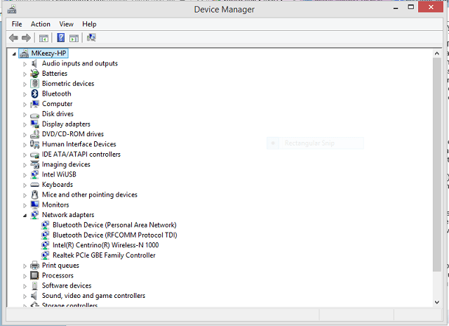

Here are a few screenshots of my now working switchable graphics:
Note: The little yellow triangles have disappeared from my AMD graphics driver.

  • WARNING: Installing this driver may result in Device Manager (Code 43) error (scroll to the top for more info) and loss of AMD Catalyst Control Center (CCC) functionality

well I still have my DV7t-6c00, it has a lot of good hardware, other than this idiotic graphics setup. I'll be keeping it for a while yet I have it running on W8.1 Pro with no problems now. But my next laptop when I decide its time will ONLY be Gforce, they have their switchable stuff in order. But to be fair, so does AMD, "IF" you have one of their actual "supported" cards, NOT these cheap ass OEM manufacturer knockoff's.
If you read my posts on leshcat's site I posted, you'll see I just took a chance and installed the latest AMD beta driver 13.11.9.4 and the newest Intel driver 3347, right over my installed SP59850, no major bs efforts, no uninstalling and all that, I just wanted to see if it would take, I never thought it would, but some people on leashcat's site did it that way and it worked for them, mostly it was people with te 6770m, and since this 7690m xt was just a 6770 at its core anyway I decided to go ahead and satisfy my curiosity. of course I made a full Image backup just in case prior.
So anyway both drivers installed, all is working, even the latest CCC. I had a slight ping when I forst installed the Intel, the system hung for a few sec on a black screen while re booting, and I thought here we go, but it went through the process and took, good thing I had a bit of patience lol and didn't hit the off button. After I seen it was running OK with that driver installed I went ahead and installed the AMD driver, it also gave me some sort of error box I just clicked OK and it kept right on installing. I don't game either, at least not the BF stuff, I just wanted to update my damned drivers is all.
btw I kept it set to "fixed" mode, and no problems, I use the Radeon ( now listed as a 6700 series) while plugged in, it switches to Intel when I use the battery only. So for now I will continue to use this HP and install what ever MS comes out with until it quits lol.
As for that touch pad thing, its another weird animal, mine just went out altogether, once it flickered and came back on for a while, but then went out again, so far its stayed out, no matter if I try the fn+space bar thing or not, so I'm not sure what the deal is on that, even the little red/orange light is off, the one you tap to stop the mouse pad if you want to. Anyway that has no real effect on the overall operation of the thing.
(off topic: btw where in IN are u? my father was from Sullivan, and my sister lives in Indy, I seem to have a lot of relatives there.)

Windows 8 Switchable Gaphics: Intel Wireless Display
Intel Wireless Display Not Working - AMD/Intel switchable graphics Windows 8 and 8.1
I recently spent about three days researching and troubleshooting the seemingly wide spread problem of certain features on my HP Pavilion DV6T-6100 CTO Entertainment Laptop PC either failing to work properly or not at all after upgrading from the pre-installed Windows 7 Home Edition x64 bit OS to both Windows 8 Pro and Windows 8.1 Pro Edition OS. I guess I could have lived with most of the performance bug the upgrades seem to cause like, losing the ability to switch between the factory pre-installed AMD discrete graphics and the embedded Intel graphics at will due to compatibility issues with the AMD Catalyst Control Center application failing to migrate intact. I'm not a gamer so that particular issue was not a deal breaker for me. However, I just absolutely hated the idea of not being able to have what I paid for when I bought my system from HP, which was "Switchable Graphics" and the "Wireless Display" feature. Those two things were in fact selling points for me as to why I decided to buy this particular system.
I found a work-around of work-around to the Intel WiDi issue, but at a cost. My Catalyst control Center is no longer functioning, which means I'm stuck with having to rely on just the latest version of Intel v.9.17.10.3347 graphics, v.4.3.3.0 WiDi and v16.5.3 Intel Wireless ProSet to meet all my graphics and entertainment needs. However, I'm not experiencing any ill side effect from not being able to switch between GPUs, since gaming on this system was never my intention anyway. There's no overheating, system crashing, excessive fan noise, etc...
I began by un-installed all the Intel software and drivers from my system. Then, I applied the latest Intel wireless driver for my Intel Centrino Wireless N adapter. Intel WiDi "WILL NOT" work, if your graphics driver is a great deal more recent version than you WiFi driver version.
Intel® Wireless Display
Once my WiFi driver was updated to the latest version I could then simply use the Intel Wireless Display Update tool to get the most recent and compatible versions for my graphics adapter, along with the latest WiDi software and Wireless ProSet software for Windows 8.
Intel® WiDi Update Tool
Remember, I recently purchased a new Netgear WiDi adapter that seems to work best with the latest Intel hardware and software such as, the new 3rd and 4th Generation Intel Core processors, which all use the most recent Intel software versions. I really wasn't expecting the upgrade of my Intel stuff to play well with the old and maxed out AMD stuff installed on my system. I don't know if Leschcat might come up with some way to package the latest Intel and AMD software and drivers in an update package that will allow all of us system owners with AMD/Intel switchable graphics to enjoy every feature we paid for when we purchased, but for now I consider this an acceptable solution.
That said, I was able to migrate from the factory installed Windows 7 OS platform to the most current Windows 8.1 OS platform and still have the ability to use the one feature I considered to be the most important selling point for buying this system.

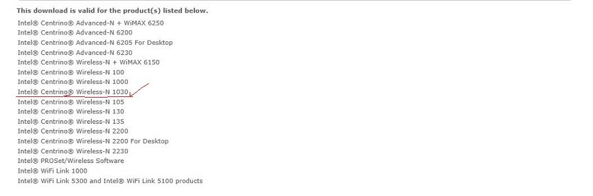

btw I have Intel Centrino +bluetooth the Intel is 1030, the other says bluetooth Device (personal area network) The other is some Realtek pcie GBE family controler

Hello Hoody,
Intel® Wireless Display (WiDi) is a feature that is built into the Intel® Core i3, i5, i7 processor architecture beginning with the 2nd generation chipset. Your Core i7 processor acts as a GPU as well as a CPU. It also has the ability to process both video and audio data at the same time it is acting as your systems Central Processing Unit. Each core process multiple threads of data at the same time.
If your system has a 2nd Generation Intel® Core processor or higher, you have Intel® Wireless Display. You only need a compatible WiFi driver/software configuration to enable it. You also need a wireless display adapter to receive the wireless display signal at the viewing source (Your TV). The 2nd Generation Intel® Core processors aren't as robust as the 3rd and 4th Gen chipsets, but they are very capable of wireless display. You only need update your WiFi driver as well its software to enable it. Some systems are built with WiDi button, not unlike a wireless button to turn it on and off when needed. Systems like mine that do not have the WiDi button uses the WiDi software and My WiFi software to enable and connect to other devices that support the wireless display signal. It's just like how you connect wirelessly to an access point or router. You search for available WiDi devices and connect using a registration key. After connection is accepted by the device your system's WiDi signals is piggy backed on your traditional WiFi signal to a device that can receive it and displayed onto whatever that device is connected.
The hard part is getting your wireless configuration's software and drivers to play nicely together, without which it just won't work. Look under "Network Adapters" in your device manager to see what exact WiFi adapter you have installed. Use that information to update its driver then use the Intel® Wireless Display Update Tool to update the rest of you Intel® Wireless software drivers. You should be able to use your wireless display. You'll just need to buy a separate Wireless Display adapter (third party hardware) to receive and display onto you television. Netgear makes a good and inexpensive WiDi adapter. Actiontech also makes a nice one, but it might cost just a little bit more.
The new Intel® Core processors not only support WiDi, but also MiraCast, which is being built into new hand held portable devices that do not have Intel® Core technology built into them. MiraCast does essentially the same thing as wireless display, but without Intel® Core technology. It mirrors whatever is on your device's screen onto a TV or projector through a third-party wireless display adapter and HDMI cable. You get high quality video and sound up to 1080p resolution.
Make sure you update you WiFi adapter's driver before using the WiDi update tool. And don't forget... You need a WiDi adapter to receive the WiDi signal just like you need a wireless router to connect to other computers and networks. Having the WiDi signal enabled and working is useless if you have nothing around that can receive it. Below are examples of the two WiDi adapters I mentioned that are needed to get the WiDi signal from your computer or portable device onto your Television.
widishootout_primary-100046761-gallery.jpg Intel Widi Software.PNG WiFi adapter.PNG Intel wireless software.PNGCapture.PNG

Man lol looks like more work than I want to deal with, I don't have much use as far as I can tell for this WIDI thing as it is. I did run that tool and it found 2 updates, I let it download and install, but it just gave me some error and stopped, my little green tray icon went missing too, that Intel ProSet icon, and couldn't find a way to get it back, I did still have web access, so I just did a restore point thing and reset it. Like I said I did find the WIDI folder in Programs, the exe is DTD 29 Nov 2012. So it may be out of date anyway for this W8.1 OS. its probably why when I clicked it it said it had "compatibility" issues, I tried to set it to W7 but it still said the same thing. Anywy since I don't seem to use this feature I'm not gona mess with it again.
Here's a shot of my net adapters, it looks pretty much like yours except for the different number, mine is 1030.

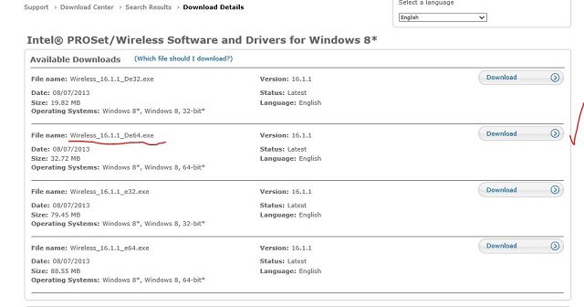

I feel you, but It's really not as much work as you might think. I looked up the Intel driver update for your particular WiFi adapter, Intel(r) Centrino(r) Wireless-N 1030. You only need the Wireless_16.1.1_De64.exe update. You don't need to install anything else but that driver, then let Intel's WiDi Update Tool install everything else once your WiFi adapter's driver has been updated. Below is the link to the Intel updates for your WiFi adapter (Driver Only):
Intel® PROSet/Wireless Software and Drivers for Windows 8*
Which file should you download?
If you have Windows 8 32-Bit:
DRIVERS ONLY: wireless_16.1.1_De32.exe
Intel PROSet/Wireless WiFi Software (includes Drivers): wireless_16.1.1_e32.exe
If you have Windows 8 64-Bit:
DRIVERS ONLY: Wireless_16.1.1_De64.exe
Intel PROSet/Wireless WiFi Software (includes Drivers): Wireless_16.1.1_e64.exe

Hy man, no I only had my usual HP sp59850, until I installed the AMD driver from AMD downloads, (13.11.9.5) mobility) and the latest Intel (3347) both installed and things are as usual. btw I did not remove sp59850, the 2 regular drivers installed just fine over it. Most people that had problems did the clean install thing, for some reason it works better leaving the HP driver alone.
The download tool had 2 updates I let run.
Downloaded that 16.1.1 driver, installed OK as far as I could tell, it doesn't show much when it installs except that small icon, funny though it says its 15.9 and not 16.1 in device manager. Anyway at least it didn't remove my little ProSet configuration icon, although it did end up with a red x, and had to use reset Proset to get it back up, but i assume that's due to updating the driver.
I may re try that update tool again later, just to see what it does now, but still don't see much reason to bother, still not sure just why I need to deal with it, what would I need it for? I don't seem to be using it anyway.

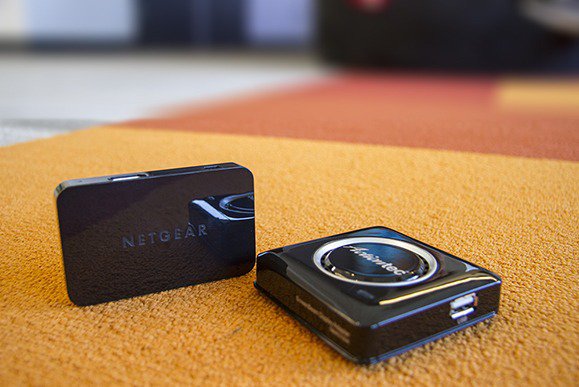

Still not sure just why I need to deal with it, what would I need it for? I don't seem to be using it now.
You already have an authentic Intel Graphics setup and an Intel Core processor, so you already have everything you need to use Intel Wireless Display, aside from the necessary Intel WiDi software and Intel WiFi software to enable it. However, you would still need a WiDi adapter to hook up to your TV so you can stream your computers display to your television. The new Netgear PTV 3000 WiDi adapter is inexpensive and it would also allow you to stream your Android phone w/ android 4.2, iPhone, Samsung Galaxy or tablet's display to your TV too.
Wireless display is a registered name by Intel for the technology, but Miracast is essentially the same technology and most of the new hand held devices on the market are equipped with Miracast and are compatible with the Netgear Push 2 TV 3000 adapter. If you watch movies or videos on your phone, imagine being able to Push those videos to your big screen TV. You may also just want to use your TV as a wireless monitor for your pc. You can also use it to give presentation using your cell phone.
img1.png maxresdefault.jpg netgear-push2tv-wireless-display-adapter-ptv3000-p39586-300.jpg
P.S., By the way, your Intel graphics driver was indeed modified when you installed the (13.11.9.5) mobility) Beta package. Just ask Alpha if that's true. It was modified by the Catalyst control Center contained in that Beta update package. In any case your Intel graphics drive is no longer certified by Intel.

OK, just installed the "mobile" 13.12 and again OVER the already installed beta 13.11.9.5, all went as usual. all is in working order as before. So I'm now pretty much convinced these non OEM drivers are now installable, and am able to continue to do so, this is the 3rd one of these I have installed starting with 13.11.9.4 along with the Intel driver 3347 and so far no major problems.Everything is fine, only thing as I mentioned before was that the system now see's my HP OEM 7690m xt as some 6700 Series, which I said I was aware of anyway as its just a 6770m at its core, so nothing performance wish changed. its no issue to me what the damned card is seen as, its still AMD. With this 3rd install though I at least stopped complaining about it lololol.
I did find that leaving my COMODO AV on when installing these the AMD driver it somehow catches something and stops the completion process and the screen goes black on me, I had this the last time and couldn't figure what was the deal, I re booted using the on/off button as I couldn't see the damned screen, at re boot, things were OK, except I didn't have the CCC installed, and both monitors were on, laptop and external, the monitor issue was fixed by re setting the show only on 1 monitor, the CCC I had to re run the AMD setup again, but this time I closed my COMODO AV, and was able to see the popup system boxes that were installing in the back ground, all went OK and I have CCC back.
I could post the same CCC screen shot but its no different than the one I posted before with 13.11.9.5, it shows the updated driver in the info section, and the switchable graphics page when on "Fixed" mode. I reverted back to fixed from dynamic cause I got tired of setting the different cards for the different programs, this way I know the Radeon is being used all the time unless I go off plug and on battery. Only thing that's a pain is some of my own made screen savers don't like the Radeon card, and won't work unless I have the Intel 3000 set , oh well can't have everything , smirks.
btw I had the system set to "Fixed" when I installed this 13.12 over the installed drivers, some seem to say to use dynamic, some say fixed, I don't think it makes much differance as some don't have that option anyway. Main thing is in my case I DID NOT clean anything, I installed the first 13.11.9.4 over my installed OEM HP SP59850 driver, and have installed each update right over the others with no problems., just in case your interested, as all I read is all this "clean install" stuff.
installed OVER my existing driver
installed in FIXED mode
had to close my AV to get CCC installed
Radeon 7690m xt (6770m) (13.12 final)
Intel 3000 (3347)
