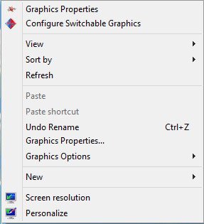

Thanks! To answer your question, here's my screenshot (Switchable Graphics is working):
If Google Translate is right, my first and second menu is the same as yours above. AFAIK, you will only see the ATI CCC "Configure Switchable Graphics" (Konfigurovat prepinatelnou grafiku) if you have both Intel + AMD working in Switchable Graphics mode.
Also, the Intel(R) HD Graphics menu ("Graphics Properties..." and "Graphics Options >" in my figure/pic above) appear depending on the version of the Intel HD Graphics driver that is loaded.
Edit: Just realized that your screenshot above is of AMD CCC Systray->Right-click, and not Win8 Right-click->Desktop...here's my AMD CCC:
