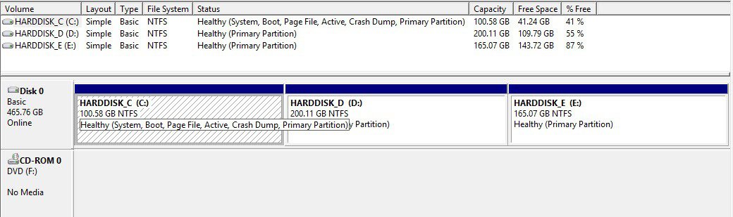

could you post a picture of disk management?

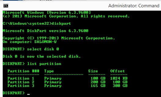

or from command prompt(admin) with / for the hard drive in question
diskpart
select disk 0 (or what ever disk #)
list partition
post that pic
Screen Shots
This is from the T-61p. The T-60 is similar. It was installed so there was no system hidden partition.

You have stated you Have an images Partition - are these windows Images??
Unless this is an OEM setup, and it is not.. I would not think you have windows reset images..
I would opt for doing a clean install and pointing to the present windows partition as the install to partition..
Hopfully it is partition 1 - the worst case is windows will create two other partitions in that space and the partition will become 450MB less then 100GB
as long as you do not remove those last 2 partitions - windows will not - you may just have to tell windows setup, if asked, to keep and use the present partition layout....

1. No, this is not an OEM, nor was the old XP. As a developer, it is my policy to *always* wipe any OEM stuff (including the bloatware), repartition in 3 (depending on the size of the drive).
2. Partition 1 as you can see from the Disk Management screen above, is the C: partition which contains the OS and most programs. Partition 2, D:, is various program disk .iso's and old incremental build images made with True Image; none are Wiindows-images per se.

if anything it looped off 450MB from partition 1 for its system file.. I figured it would..
do diskpart again to see if you now have an extra partition you did not have before
