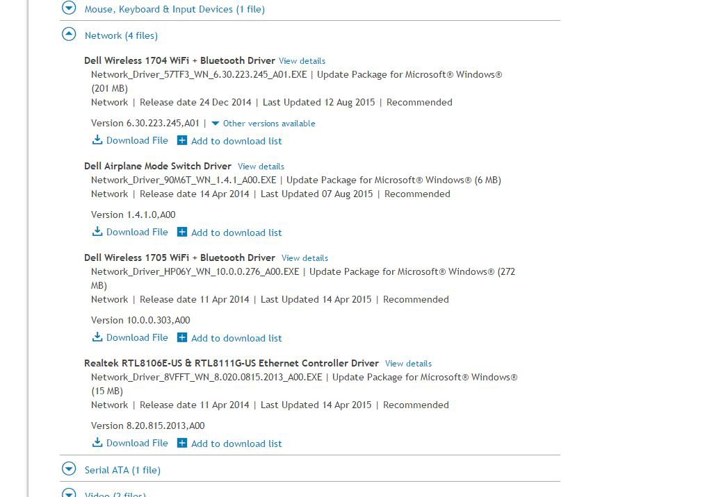

Here is where I looked: Product Support | Dell US

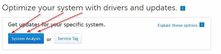

Try the System analysis tool on the Dell support web site dell.com/support.
I believe you need to use Internet Explorer for the tool to work correctly, but I'm not sure about that.
