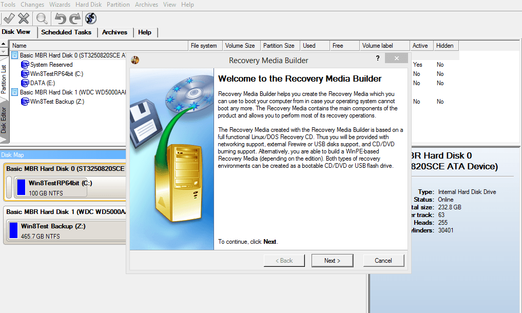

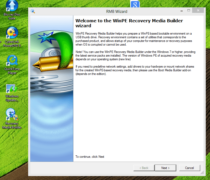

I have Paragon HDM 12. How do I make a boot disk that will work with Win8 UEFI/GPT?
I'd like to use the disk to create the image just so I know it works.
For DVD/CD.
Tools>Recovery Media Builder.
For USB, you can download the USB app.

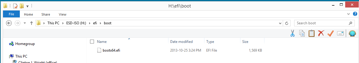

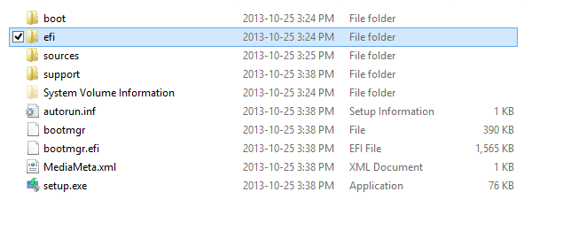

Well you do need win 7 SP1 64 to support UEFI GPT, and your boot media has to have the EFI Boot64 file in to install UEFI
If your disk are already GPT the install should be no problem. On boot up you need to bring up a boot menu and select the UEFI boot media. I found Rufus very helpful in creating a UEFI USB Install thumb drive.
This what my USB Win 8.1 Install media looks like, win 7 would look the same if set up for UEFI
