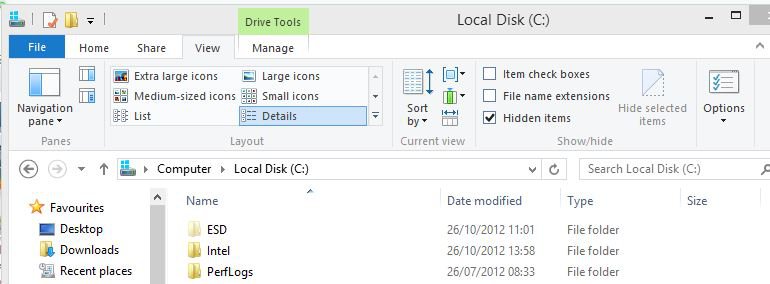

You can get them by going to C drive, expand the ribbon in explorer, click View, tick Hidden and you can view the ESD folder, you could make yourself an .iso image using those files.
You can also try the method theog posted which is much easier.
EDIT: Snip added.
EDIT: Snip added.
thanks, I managed to get an iso by running windows installer again, strangely I didn't find any folder named ESD under c:\, but anyway thats how i got it done.
One could burn Install.esd file which is inside the Sources folder for future use, actual path is as follows,
tick Hidden files under View tab in Explorer, then navigate to Install.esd,
C:/, ESD, Windows, Sources, Install.esd.
