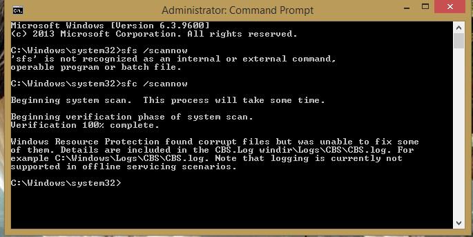

Even the SFC Scannow that Brink posted failed. It found corrupt files but was unable to fix some of them!

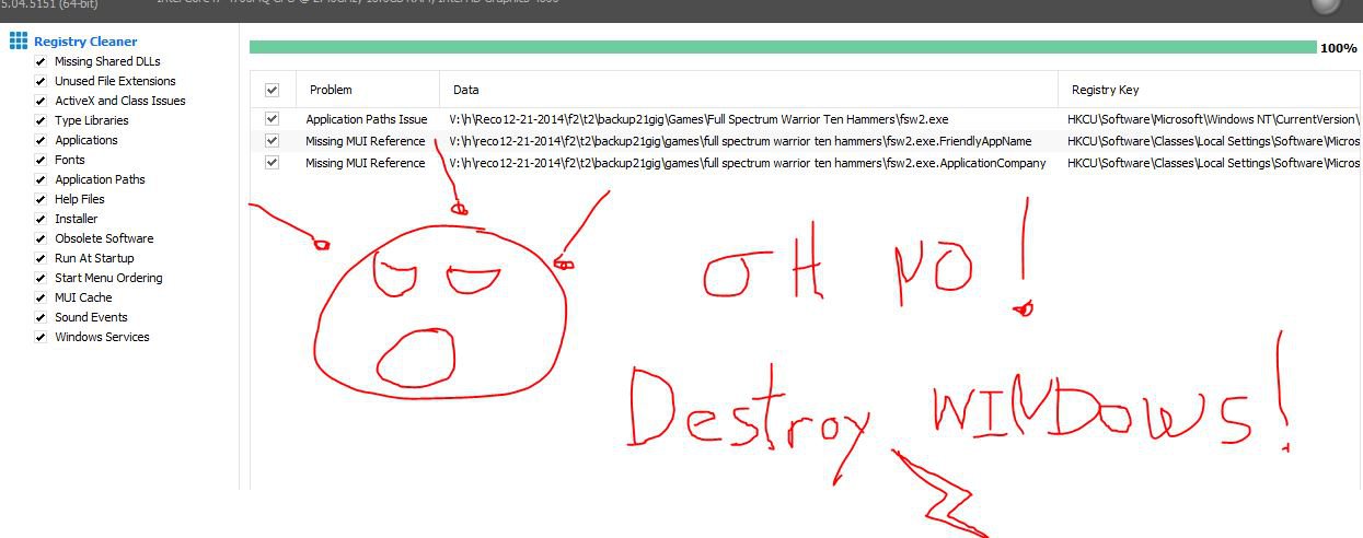

here is my registry cleaning for today.. oh my! is this going to "destroy windows 8" today???
but i've never seen anything that it removes that ever will in all my years (5+) of using reg cleaners!
hope people realize i'm not so dead serious about this just throwing another viewpoint out there so people are so scared to use registry cleaners.. especially the ones like Ccleaner which that company knows they shouldn't screw people's computers up or else they will loose all their business!!
posted below is just an old game I deleted and now the terrible damaging "registry cleaner" found it and wants to get rid of it..
There is a well known bug at the moment with sfc reporting non correctable errors. If this is all it is then its a non problem.
