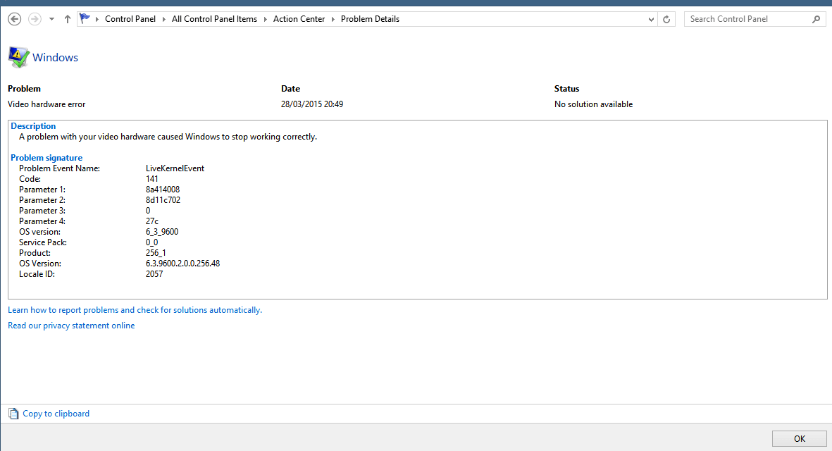

Is it a driver problem or hardware? The motherboard is from 2008 and used 24/7 til now and I have heard the capacitors are not of the highest quality. Below is a screenshot of the reliabilty error details. Any ideas? I am now using the latest prime95 and cant reproduce the problem.

If you cannot reproduce the problem, then maybe it was a one-off problem. I note that was from the 28th so I assume it has been working fine since.
