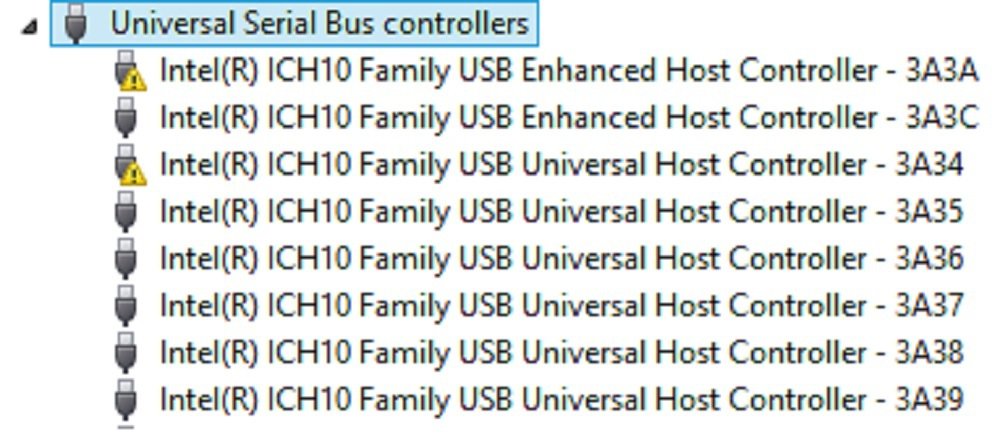

The usb ports on the back of my pc are working fine but this on the front 2 usb ports are not working.
I think that if i will shut down my pc or make a restart it will fix it this time.
But i don't want to restart my pc now.
1. Why it happen ? It's not the first time. I think it's due yo insert/remove my smartphone too many time from the usb port in the front. Is there any way to make it will not happen again in the future ?
2. How to fix the problem now without restarting/shutting down the pc ?
I went to device manager and i see under: Universal Serial Bus controllers two controllers out of 8 that have a yellow triangle with a black small line inside like a warning. I tried to make Scan for hardware changes but it didn't fix it.
What else can i do ?
This is a screenshot of this warnings i see:
The solution in my case was to disable this both controllers. And enable them back. Now it's working again fine.
I just wonder why it happen in the first place ? And why microsoft can't fix it.
Is ther any fix for this problem ? Or if i will connect and remove my phone from the usb many times it will happen over and over again ? I need my phone for testings i'm doing programming on it.

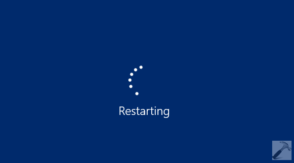

No no, I mean I had them all plugged in and then Hit "restart.. then the Blue screen shows up saying "Shutting down windows" or maybe it says "Restarting" I can't even remember now but it just sat there and didn't turn off.. know what i Mean?
I didn't even get to the point of the boot.. it was just trying to still quit windows and shut down... make sense now??
and then it was just circle spinning and then i unplugged the usbs and then it restarted..
I wasnt' trying to boot with them.. just restart..
this screen
