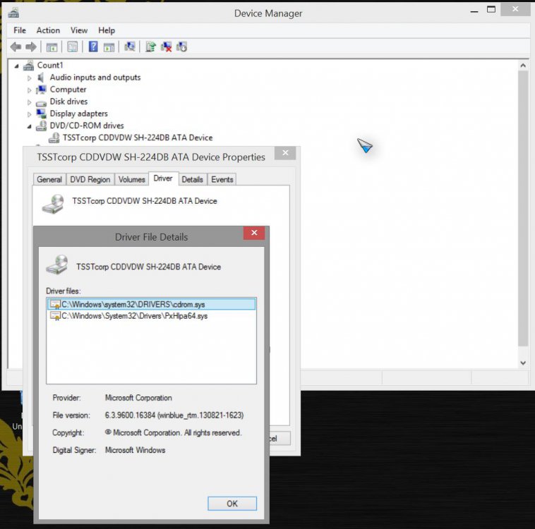

Unless you have Windows 8/8.1 with media center you need a third party player to play DVD/BD etc. but that shouldn't stop drive from being recognized and readable thru windows explorer or in device manager. Can you try getting appropriate driver fro drive's MFG ? even if it's for Win7.
Yes I tried going back to the manufacturer and they said that there isn't a driver for it as it is included in Windows, as indeed it is for up to Win 7.
Do you know of a way to get the driver out of a win 7 installation to copy the over to Win 8.1?
Hi CountMike, I have tried Major Geeks and when I run it on the Win7 laptop it comes up with the driver and it is called CD-ROM Drive and 6.1.7601.17514.
However when I run Double Driver on the Win 8.1 it does not show any CD-ROM Drive entry (I did try a restore of the Win7 CD-ROM driver on the Win8.1 laptop but it failed) Now the laptop is built without a CD-ROM drive in it, hence my desire for getting this external one working, so could it be that the Win8.1 build put on at manufacture didn't include it because there was no device in the laptop?
Do you have a PC running 8.1 that does have a optical drive in it?
Yes I do.
