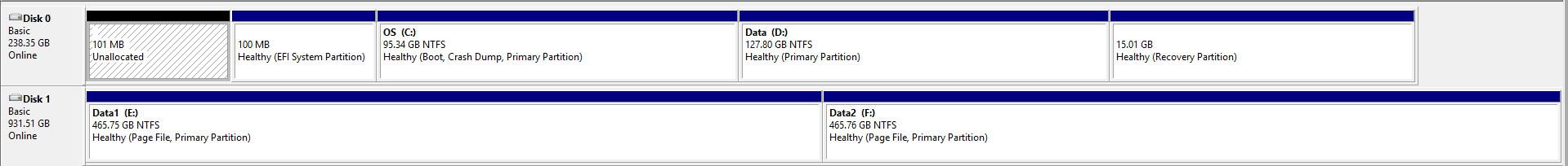

I just noticed a 101 MB Unallocated partition at the start of my SSD BOOT Drive. It works fine nevertheless.
Look below:

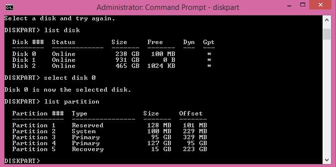

In Diskpart it shows the following, it is "reserved":
Wasn't this supposed to be the 100MB "system" partition? Meaning if I like to run a Recovery from Partition 5, it would have been Partition 4 before the restore of Acronis? I am not sure what I am saying actually hehe. Should I leave the 101MB reserved or is there any possibility to successfully add this reserved space to the OS partition?

Hey folks ... if you look closely at the Disk Management screenshot, you will see 5 partitions PLUS the unallocated 101MB space.
The "reserved" in the Diskpart output is NOT referring to that 101MB of unallocated space.

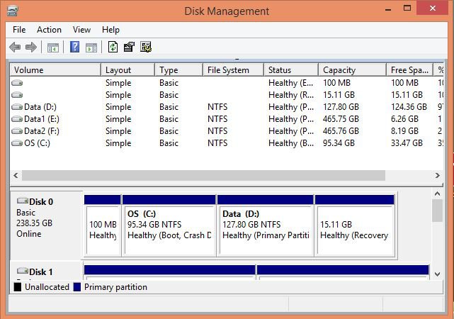

Well I fixed it with great and personal thanks to a man called "Mustang" on Acronis Forums. He helped me thoroughly with all steps necessary to resolve this. It wasn't really easy for me since I knew nothing about WinPE, MSR and EFI partitions in particular (a lot more now) and bootdisks with plugins for acronis etc.
What I did was to load WinPE with acronis plugin. Wiped the whole SSD drive with diskpart. Then created all the partitions as they originally need to be, e.g. that what Win 8.1 makes as default during a new installation. And then manually restored all the partitions one by one and that worked!!!
Look now :
I am happy again now because this is how it should be. I also will NEVER use any Acronis product anymore (at least not until they fix this crap by restoring a GPT partition as it should) and will look for something else for now. Thanks everyone! Case solved hehehe.
