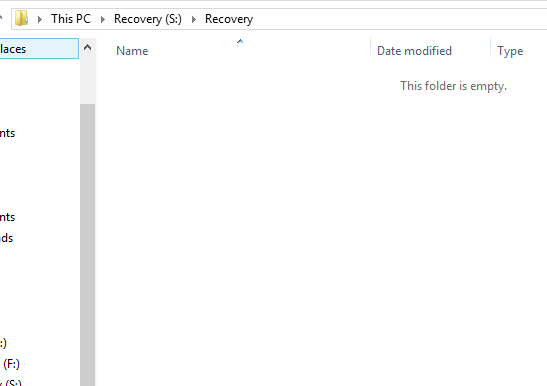

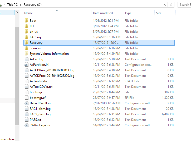

I also mounted the 900MB partition to see why the "path can't be found". The "Recovery" folder is there but it is empty.
explore partition 1 also unhide protected system files
that is (was) a bootable partition

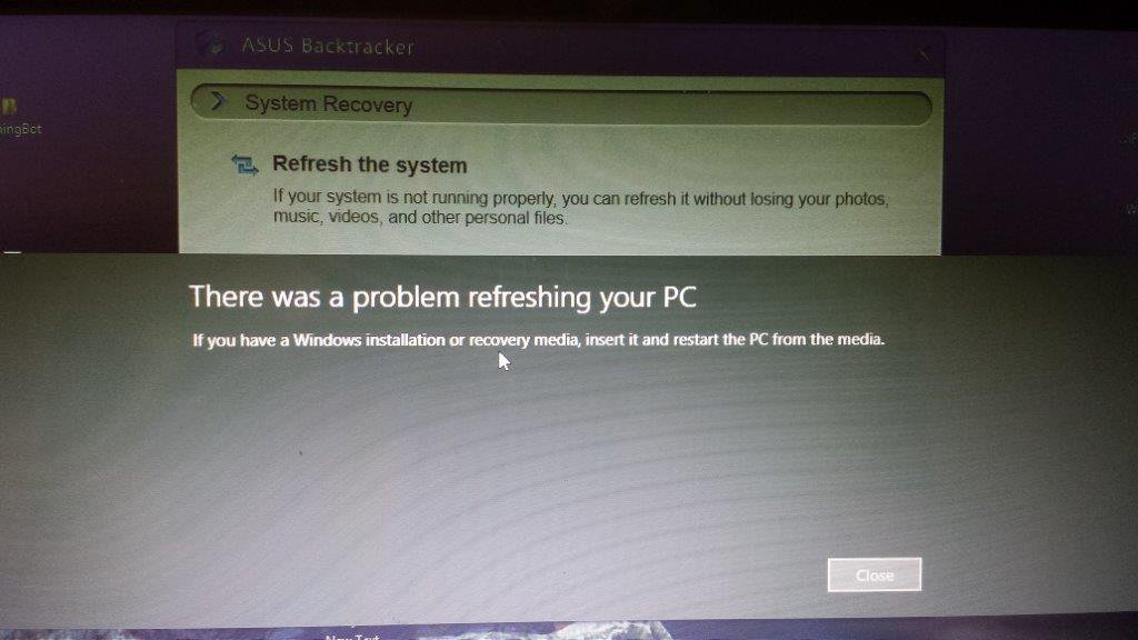

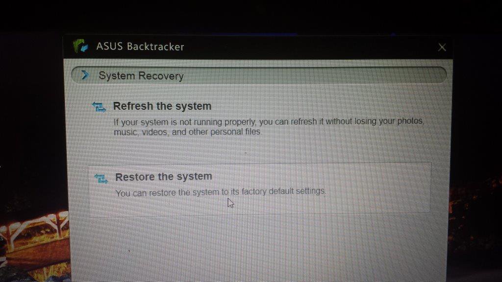

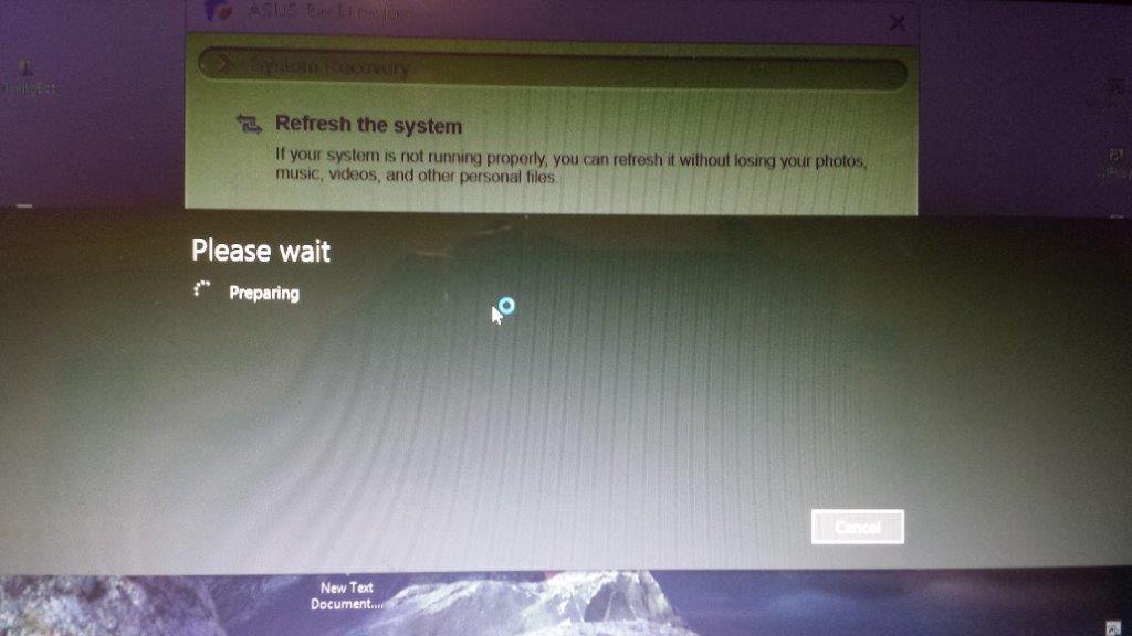

Like many others here, when I try to Reset the system to factory settings on my Asus X75A, it errors with the message that the partition is missing. I guess it is the Windows 8.1 update that has done that. I have taken some screen shots of what is going on. I have tried the Backtracker program and the Windows Reset route but they both cannot see the relevant Recovery partition. I have tried the various suggestions here but have got nowhere. I'm sure it is just something that needs doing that I haven't done. The Reagentc /info result seems to say that all is in order, so I am now tearing my hair out for a solution, if someone could be so kind as to point me in the right direction. Thanking you in advance.

I decided to try it, thinking I was going to end up with the same result. But no, the process went further and it is finally Resetting and at 14%!! Woo hoo!! Nice one, Marcus! I downloaded the first file for downgrading Win 8.1 to Win 8 and I did not receive a message about not finding the Recovery Partition. It's looking promising so far... watch this space!
Update... it is now installed, the Recovery Partition worked fine. Many thanks to all those who have contributed here, without whom I would not have achieved my goal. Best wishes to all!!

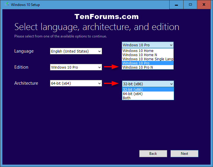

Thanks Genet, using the USB Installation Media comes up with a window asking me for the Product Key and i can't skip it. I've checked and my windows 8.1 is 'permanantly activated' (Asus OEM windows single language). Is there a reason why its asking? If i can't skip the product key check, i'll have to download the whole windows 10 installation again.
You have downloaded the wrong version.
I do not know which version you need to download.
Windows 10 Home
-or-
Windows 10 Home Single Language
https://www.microsoft.com/en-us/windows/windows-10-faq
What edition of Windows will I get as part of this free upgrade?
From Edition: Windows 8.1 x) To Edition: Windows 10 Home
x) Also applies to Windows 8.1 country specific editions, Windows 8.1 Single Language, Windows 8.1 with Bing.
Yup, you're right genet, apparently i'm supposed to be using windows 10 Home Single Language... even microsoft is confused as their faq says win 8.1 home single language upgrades to win 10 home. So that parts all good.. if i upgrade or install win10 home single language, it activates.
